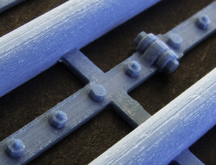

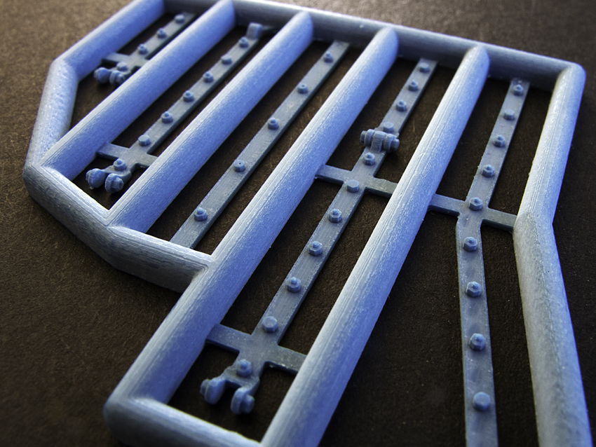

Just got a print from Prescision Wax in the UK, it is printed on a Solidscape printer:
The Wrench size of the hex nuts are 0,7mm. (0,0275")
Width of the parts are 1,35mm (0,053")
That hex nut detail is quite good in my opinion!
Not enitrely sure about layer thickness, but I would guess 25 microns, even if the printer is capable of 12,7 microns.
This is a wax print, so it can either be used to make a second generation master for a rubber mould (the non-RTV kind used by several casters) or directly to a RTV rubber mould for making waxes for casting.
This part cost me £ 30.00 (USD 50,-) including postage & handling. Took around a week from delivering the stl to receiving the unharmed wax by Royal Mail. Excellent service. FineLine quoted USD 168,- for the same part...
(please do not mind the layout of the parts, the design has since been revised several times!)
I've seen cast metal parts much worse than that and rarely have I seen metal parts better than that. Looks as though you hit the bullseye. -- Russ

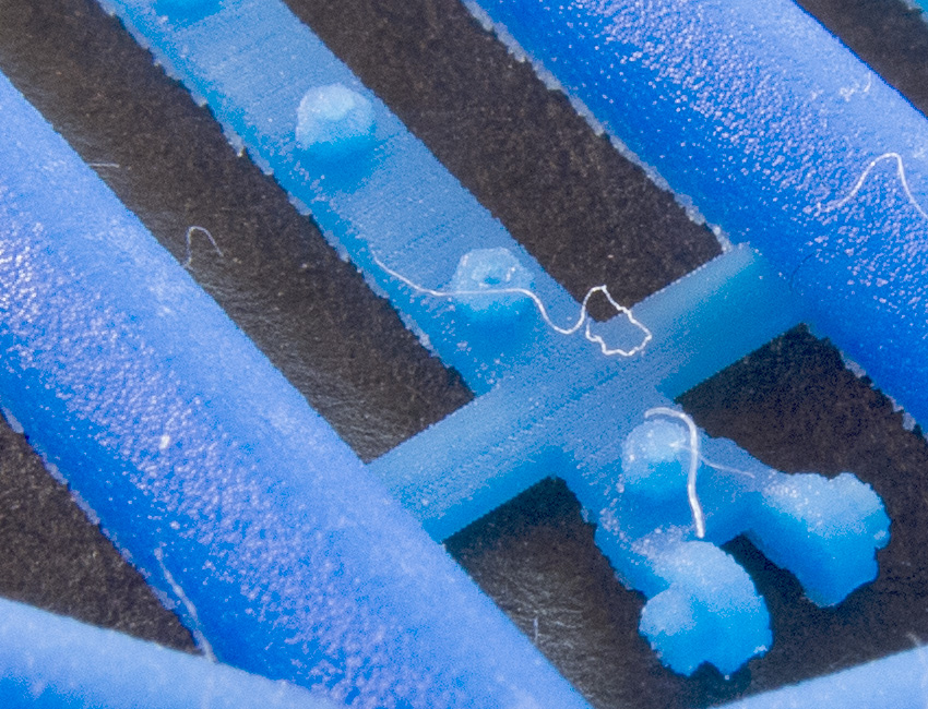

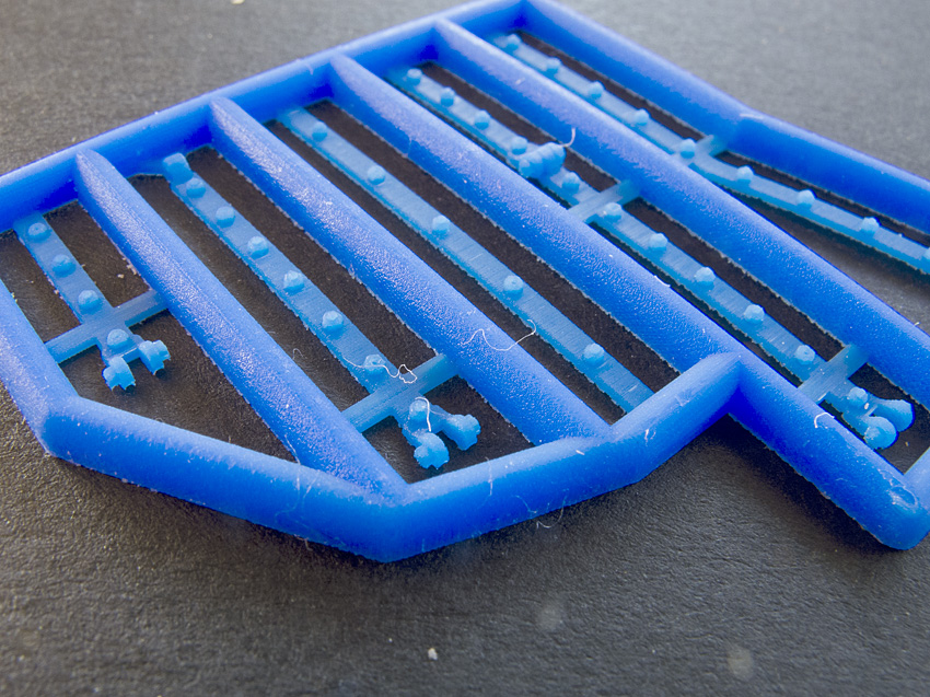

I am in a bit of research mode, so I ordered the same print in wax from Shapeways. This is the same printer they use for their metal parts, so I was interested in seeing the part before casting.
It is printed with 16 micron layers, so in that department it is even better than the Solidscape print from Prescision Wax.
But as you can see, build layer thickness is not everything:
Most annoying is the surface pattern, that is something that also bothered me with the brass part I got from Shapeways.
The hex nut detail is nowhere as sharp as the Solidscape print.
The wax is also softer and more sticky, I would not consider using this part for a RTV mould.
I feel that Solidscape waxes could be used for RTV moulds, but waxes are probably most useful when you need a one-off metal part or a metal master.
It was in fact a disappointment that the surface detail was that rough on a 16 micron layer printer, and that edge sharpness was not better.

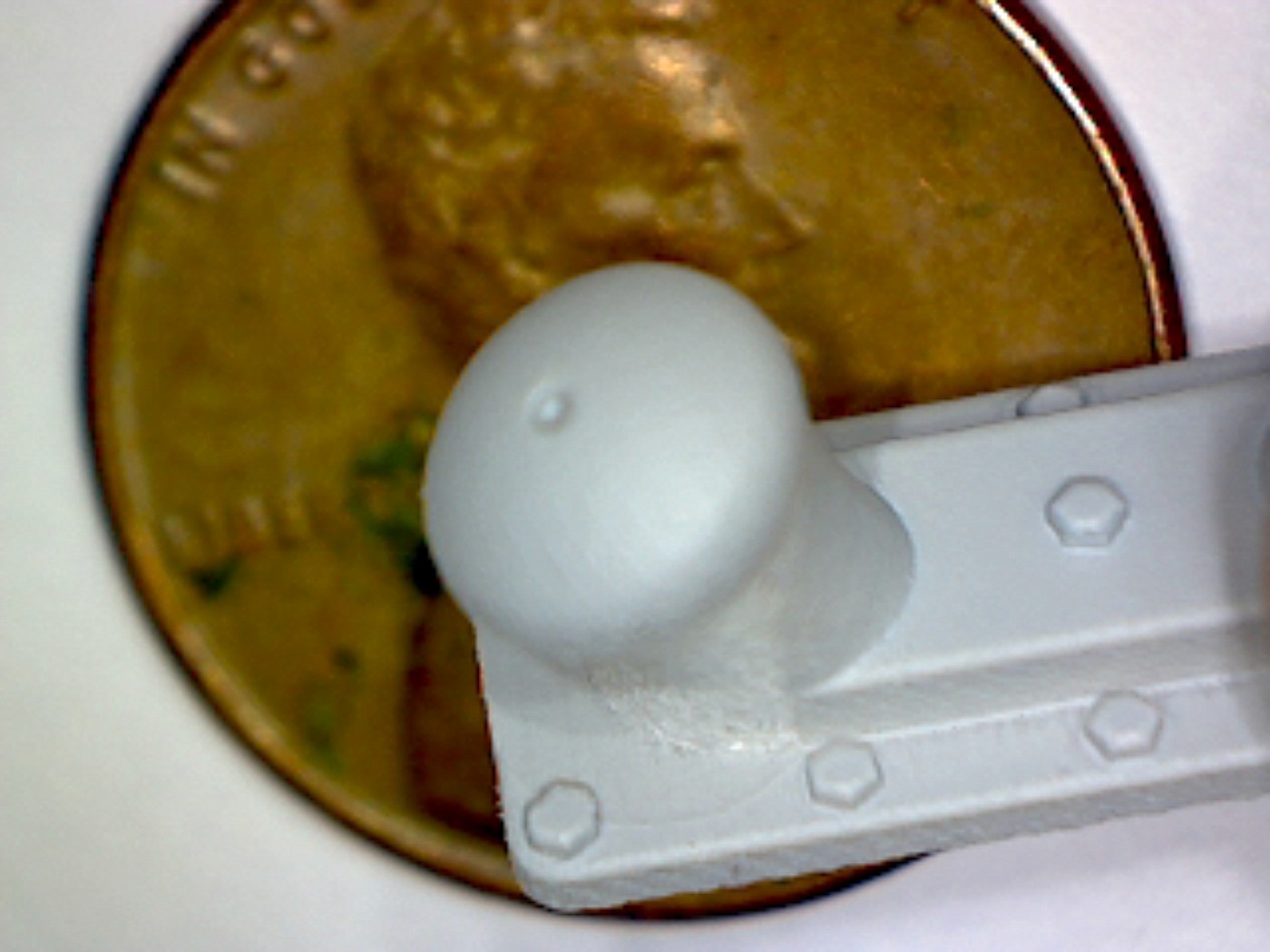

The other day I bought a Celestron USB microscope. I used it this morning to snap a pic and a short video of an O scale double-head bitt I had printed at Shapeways. Neat toy ... heck .. didn't even know it would do the video thing until I was clicking earlier in the software. Duh! :)
video
