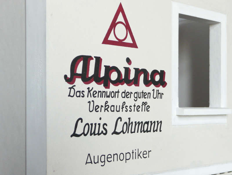

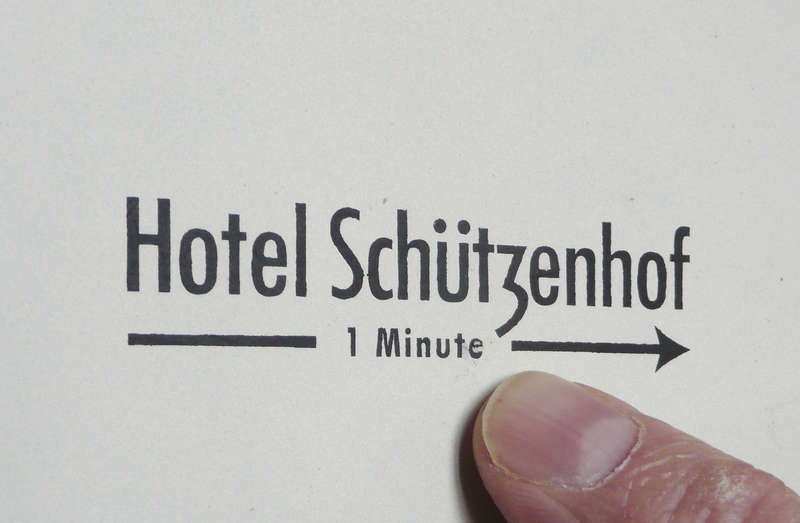

Volker, Yes, I understand completely what you said about being nearly impossible to align both foils to create the exact offset that you want. I once worked with a prototype of a very simple plotter that cut self adhesive vinyl film for signs and projects like you described. I think you have the steady hand to be able to paint in those 'conjunctions' on your sign. Perhaps a little masking tape on the outside of the connecting corners will help.
I'm surprised that such small lettering can be cut out of foil for use as a stencil. I didn't think that such fine details could be achieved that way. I'll have to look into this as it would be very useful for my models as well.
Quote from: Bill Gill on March 22, 2019, 11:10:07 AM
Bill, thanks again. I added the connecting corners and it looks much better now.
Opposite side with larger offset (mistake in the first foil, but it doesn't matter):
Quote from: Ray Dunakin on March 22, 2019, 08:47:24 PM
I think the only limitation is the tiny pieces to remain on the carrier paper, for example within the 'e'-letter, which tend to come off when removing the positive parts. There's always a tiny stretch of length not being cut, which doesn't matter, if the parts are a little bit bigger. I wouldn't use that for a locomotive livery, but it works for those hand made signs. It's helpful to use a new blade in the cutting machine.
