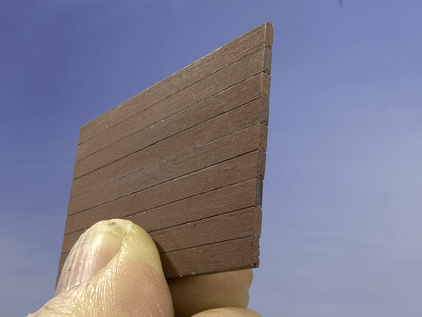

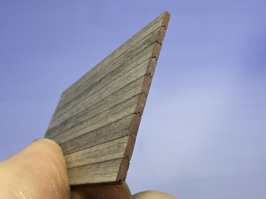

A little more work has been done on the wooden parts. Sides for the first wagon has been glued together. I thought this was gong to be a demanding process, but it turned out that it was far easier to glue them together than I thought. The challenge was to keep the tongues and grooves visible on the ends, since these will have the ends of the board visible.
The process I followed was to spread a thin film of white glue on a plate of glass, and carefully touch it with the tongue of the board. This way glue was only applied to the top of the tongue, and with a little care no glue oozed out between the boards. I was careful to not apply glue to the last 3-4 mm at each end of the boards to avoid that the glue hides the tongue and grooves. After working so hard with the T&G boards, it would be a shame to hide them under glue!
I also had to do all final sanding and painting before assembling the ends for the same reason. I am happy that the T&G´s are visible on the final parts. It is a quite subtle detail only seen by hawk-eyed observers and in extreme close ups, but I like it! (And it was fun to work out how to make scale T&G boards)
By the way, I changed my mind regarding the red on the sides and settled for a more plain boxcar red. I also used a slightly less thinned paint (Humbrol no. 70 cut with 25% white spirits). Before I brush painted on the red, I stained all sides of the wood with two coats of Silverwood thinned 25% with isopropanol.

The T&G boards are amazing, and look great!

That looks great.  Nice work.
