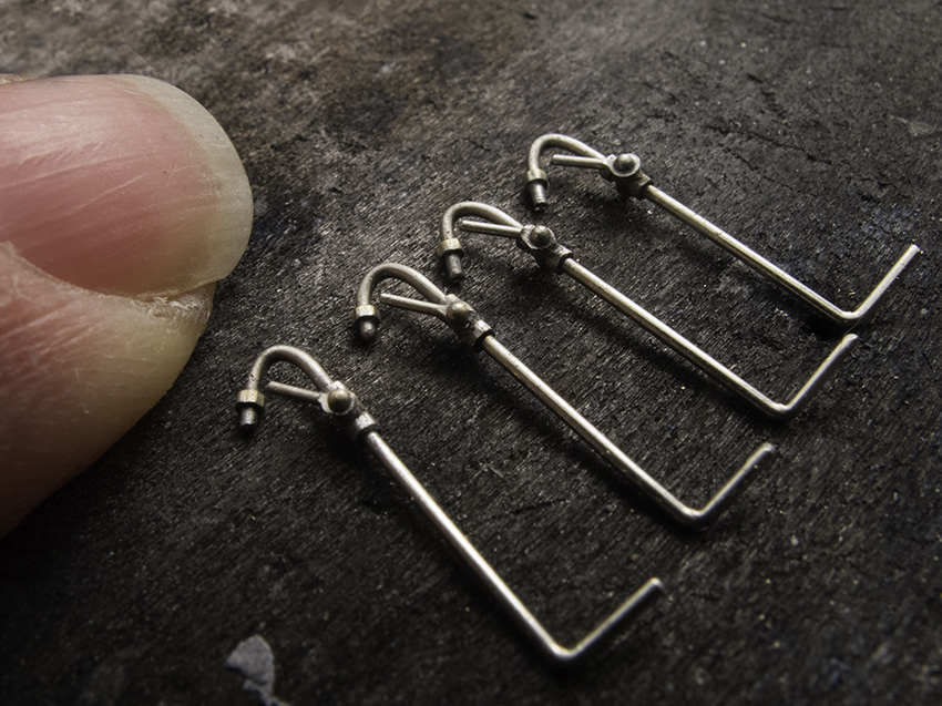

Just bumping the thread with a photo of four brake stands (?) :
Boring stuff to make as I have built several oft hem before. But they just have to be made. Next time I think I will have them cast.
Hauk, good to hear that it will go on.
The brake stands looks good!
Sometimes boring stuff will be rewarded by the result  :)
Nice to see some progress again.
Hauk, Good to see you're still working on this project. Nice details with the brake stands.

Building brake stands or other repetitive details is a little like performing music: You may already have played the piece a thousand times but the challenge is what you bring to it on any given day. Very adequate fabrication. -- Russ

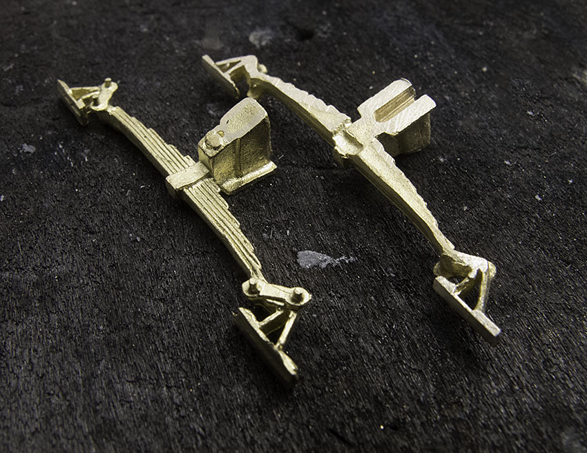

A little progress report tonight. To make room for the axle points I needed to mill a 1,1mm wide and 1,8mm deep slot in the back of the leaf spring/journal box castings:
The brass alloy in these castings seems to be very hard, and this seemingly trivial task came at cost of 4 mill bits. Fortunately, they were cheap Chinese eBay bits, but perhaps this also was part of the problem?
The bits were regular steel, 2 flute. For the first attempts I used 2mm/sec feed and the cuts 0,3mm deep. Spindle speed around 20 000. But as the bits broke at the very end of the slot milling, I decreased the feed speed to 1mm/sec. Then it worked quite OK.
Any suggestions from you serious machinists out there? Should I have used a carbide milling bit? 3 or 4 flutes? Any other opinions on milling and drilling brass castings?

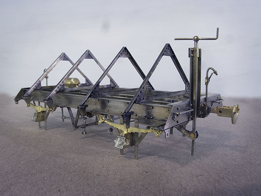

To finish off tonights report, here is on of the two underframes I am building in parallell:
Three nights of work produced the swan necks, installation of the couplers, preparing and installing of the spring/journalboxes and adding the journal box covers. Not to bad in my not so humble opinion!
Your work is just gorgeous.
Did you use a lubricant when you drilled? I know virtually nothing about such things but remember reading about lubrication helping to preserve drill bits, cutters, and other tools.
Watching with great enjoyment! It looks vey good. You got a lot done in a night.
I got some cheap Chinese bits for my pin vise and broke several drilling into plain old styrene - your bits may have been a large part of your breakage as well.

I love what Hauk calls "a little progress"! Wonderful, beautiful, incredible progress.....Allan
I wish you modeled in 1/16th scale!
Stunning as always!
