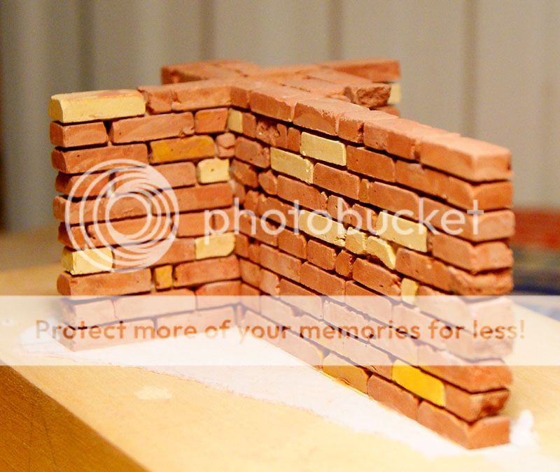

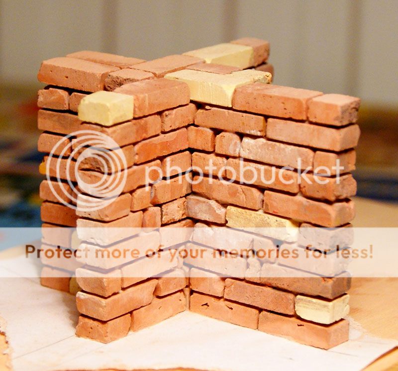

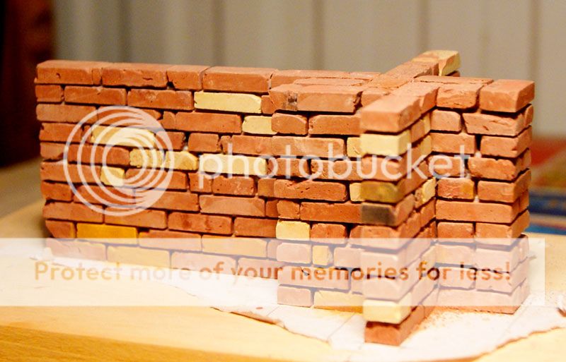

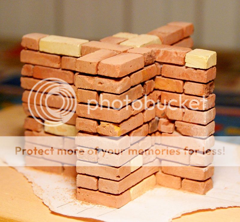

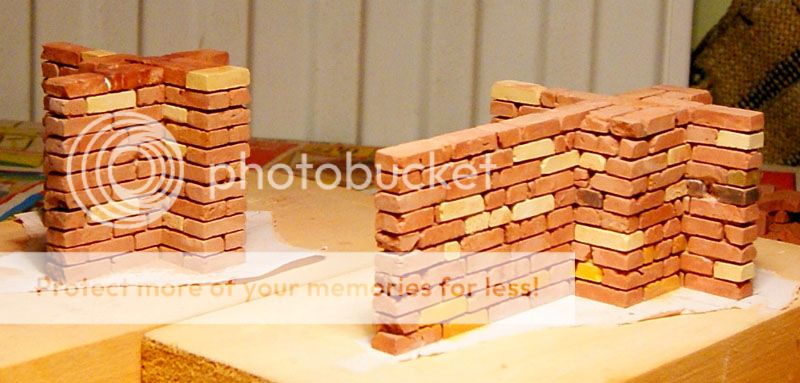

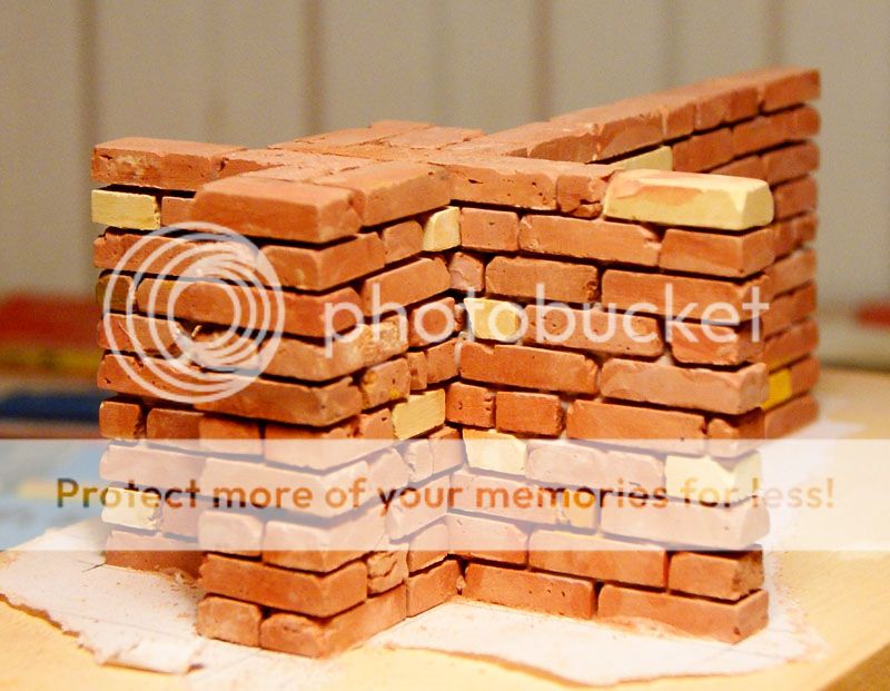

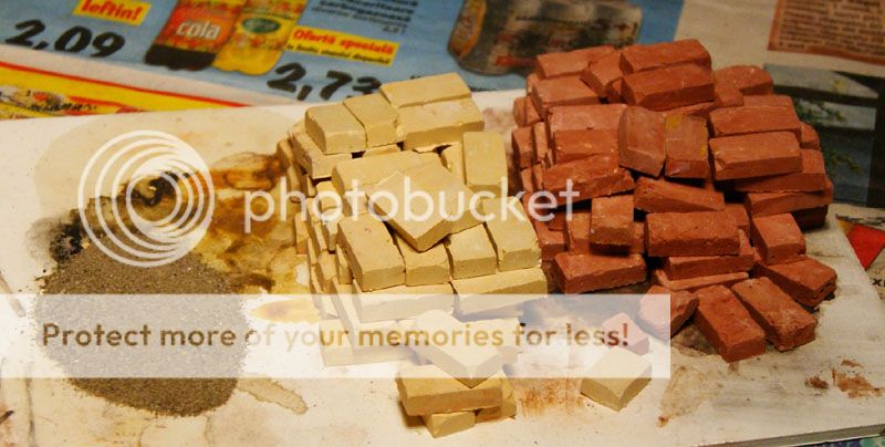

And I started something, in 1/16. I use ordinary plaster, mixed with an amount of fine sand and coloured in mass with
iron oxid. I made my own mold and I'm casting now .... hundreds of bricks. Nice!

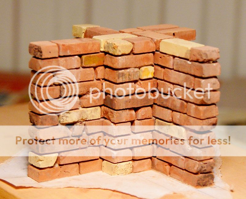

This is my very first attempt in such thing and I saw that is not so easy. That's why my first goal is to built straight and vertical.
You'll see, my structure is not very good.
The stains on it represent some weathering tests. Here I have also to work enough.
My bricks are not perfect and, after castings, I decided that is better. Derelict bricks ...  ;D
Few pics of what I'm doing now.

Welcome Alex! It looks like you are off to a good start. I will be following your progress with interest.
The bricks look good!
One tip - I always design my walls in full brick lengths to reduce the amount of cutting and fitting. (My old man was a bricklayer and not surprisingly, a lot of the buildings he worked on were designed that way.)
Welcome aboard, Alex! I think you're off to a very good start. The bricks may be a little rough but should be fine to represent an older building with some decay. Or even a newer structure that was made from recycled bricks.

The color and texture look good, don't be so hard on yourself, the best way to get better is to keep going, this group will be honest.

Mistakes and things forgoten. I use to make hand drawings all the time, a small plan of the building.
This time the rush was the word of order.
Some work on the brick, as well, even I like their rough look.
I'll keep working in 1/16, is very suitable for my nowadays eyes ;). And very challenging.
Alex

Marc, thanks for your comment, very nice coming from you. But ...
I'm not content of what I've done, started these structures 2 times and also not content.
Something was going wrong - I used cardboard spacers with white glue ... The structure was wet and
I had to wait too much to dry. A problem was the mortar, how to do it and the aply technique.
I've read again some of the articles here, fragments of them and remeber me also of some things seen here.
Meanwhile, I made some concrete tests. I'll use it for a house entrance, in combination with bricks.
I also "discovered" a mortar recipe - also seen here, I remembered me about the white wood filler.
But now few pics with my concrete.
Alex

AlexG
Thanks Ian for these info. Very useful for me further.
I already found something like that, the name here is Polistick, a filler for wood and brick work.
Coloured already an amount in a jar ... with powder pigments - a sort of Ochre and Black, and I obtained
a light gray material. Have made some tests, fast and careless, as you see in the pict here.

Alex,
At the scale you are working, and especially in comparison to the high quality of the bricks, the issue I have with the mortar is that it looks too "runny"....and there is not enough grit/grain/texture.
