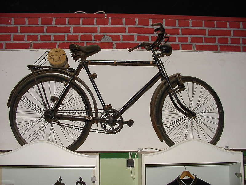

Hello Ray,
of course, the bikes have always had a coaster brake, only the rear brake alone the bike turns when braking with the rear wheel forward.
Can you better not try a car for smoothness once briefly and strongly pulled the hand brake and already spun the car.
Therefore, bicycles also have a brake which acts on the front wheel.
This service bike a mine overseer is over 80 years old and has the back-pedaling brake for the rear wheel and the second brake for the front wheel.

Helmut - What you say about brakes might be true in Europe, Asia, and Africa, but not in the USA.  The typical single speed bicycle in the USA has a coaster brake on the rear wheel and no brake on the front wheel.
