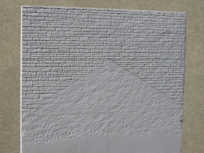

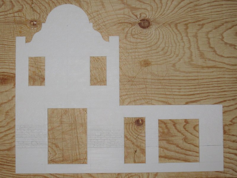

I spent quite a bit of time on the second wall today. I got the door and window openings cut out, sanded the surface, applied scratches, tapped the whole surface with a rock, and made a good start on scribing the stones:
Then I realized something... I'd done all this on the WRONG SIDE!
Doh!!!
I had to scrap it and cut out a whole new wall. But I'll save the bad one, and maybe I can cut off sections of it for use elsewhere.

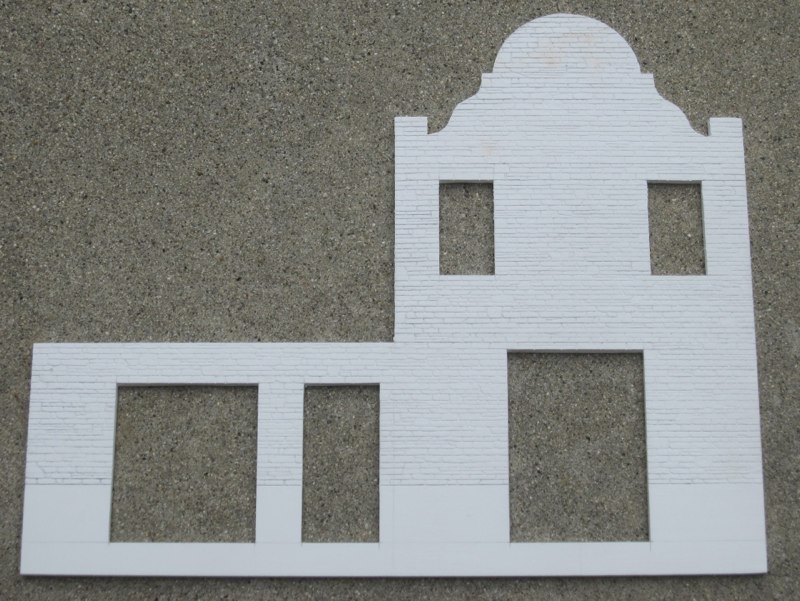

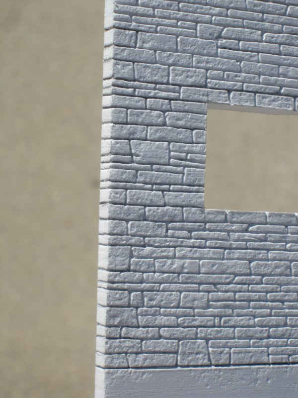

Hooray! I finally finished scribing the (new) second wall, and got it right this time:
Still need to use the X-acto to carve out a few random stones, then I'll go to work on the third wall.

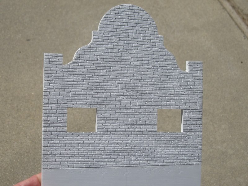

Progress continues a piece at a time...

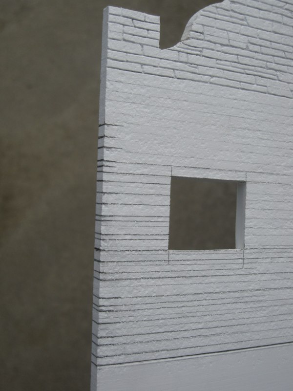

On the end wall for the west wing, I drew guidelines on the wall's edges, roughly matching the positions of the mortar lines on the north and south walls:

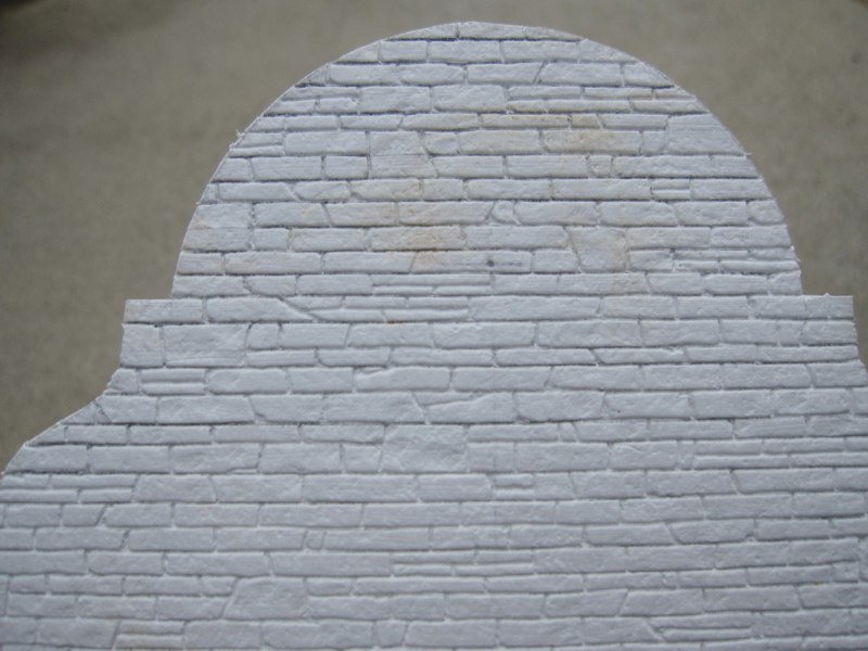

The finished west wing end wall:
After the walls are glued together, I'll need to use a bit of filler on the joints. At that time, I can do any necessary adjustments and touchups on the mortar lines across the joint:
