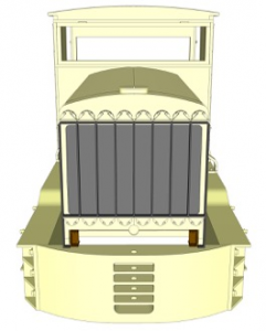

It took forever but I finally finished the radiator. (I am very clumsy with SketchUp.) -- Russ

Looking damn sweet!!!!!
What happened inside the frame? you filled it in!?!?!
The lines on the radius areas of the side-frames will need to be erased too (I think)
Will the radiator be a separate part? (please)
And the guard?
What will the core be? printed? separate? mesh?...???
I temporarily put a "deck" between the side frames but will open up the center when I figure out how Plymouth actually built the loco's engine compartment. That filled-in section is on the same layer as the radiator. The idea would be to create the frame as one part, the radiator as another, the hood another, and the cab (or cab walls) yet another (presumably with positionable doors).
The radiator guard might be too fragile to print separately or even at all. The 1:1 scale strips that make it up are only about 1 1/4 inches deep by 3/16 thick. I'm sure one of the guys will help us with that issue.
The radiator core is recessed. The idea would be to cut a screen to fit the recess. It would be much too fine to print.
These sub-assemblies are actually a "rough draft". Some "correct" dimensions will have to be enlarged prior to printing and some details created by hand. It might also be necessary to break down the "kit" into more sub-assemblies. Once the drawing is finished, our panel of experts will help turn it into a kit.
