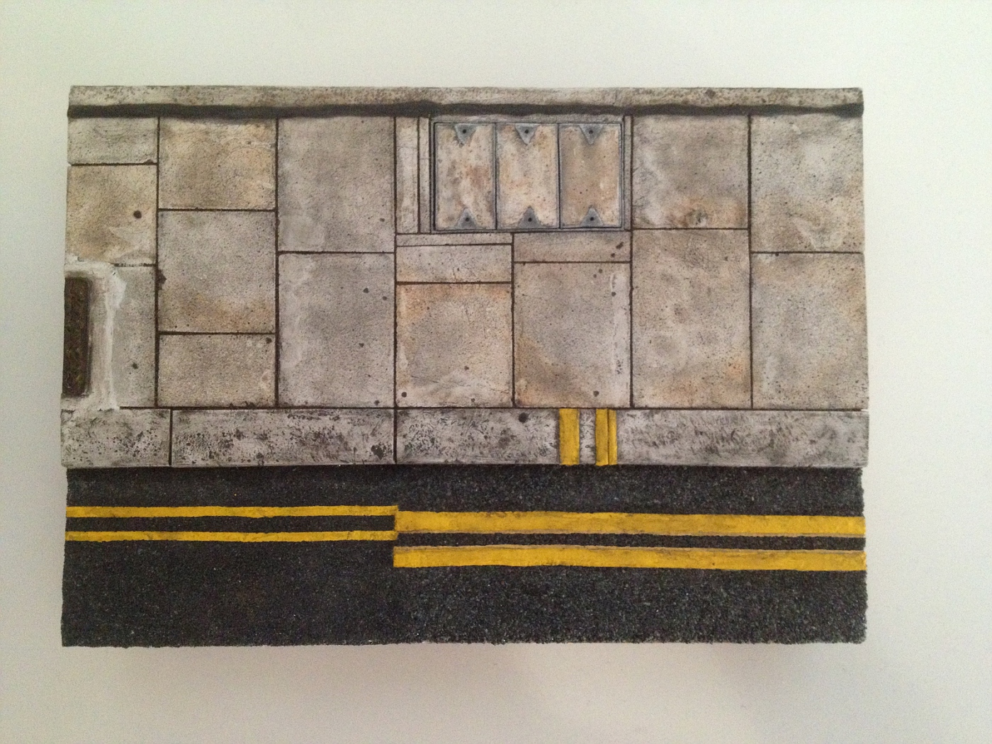

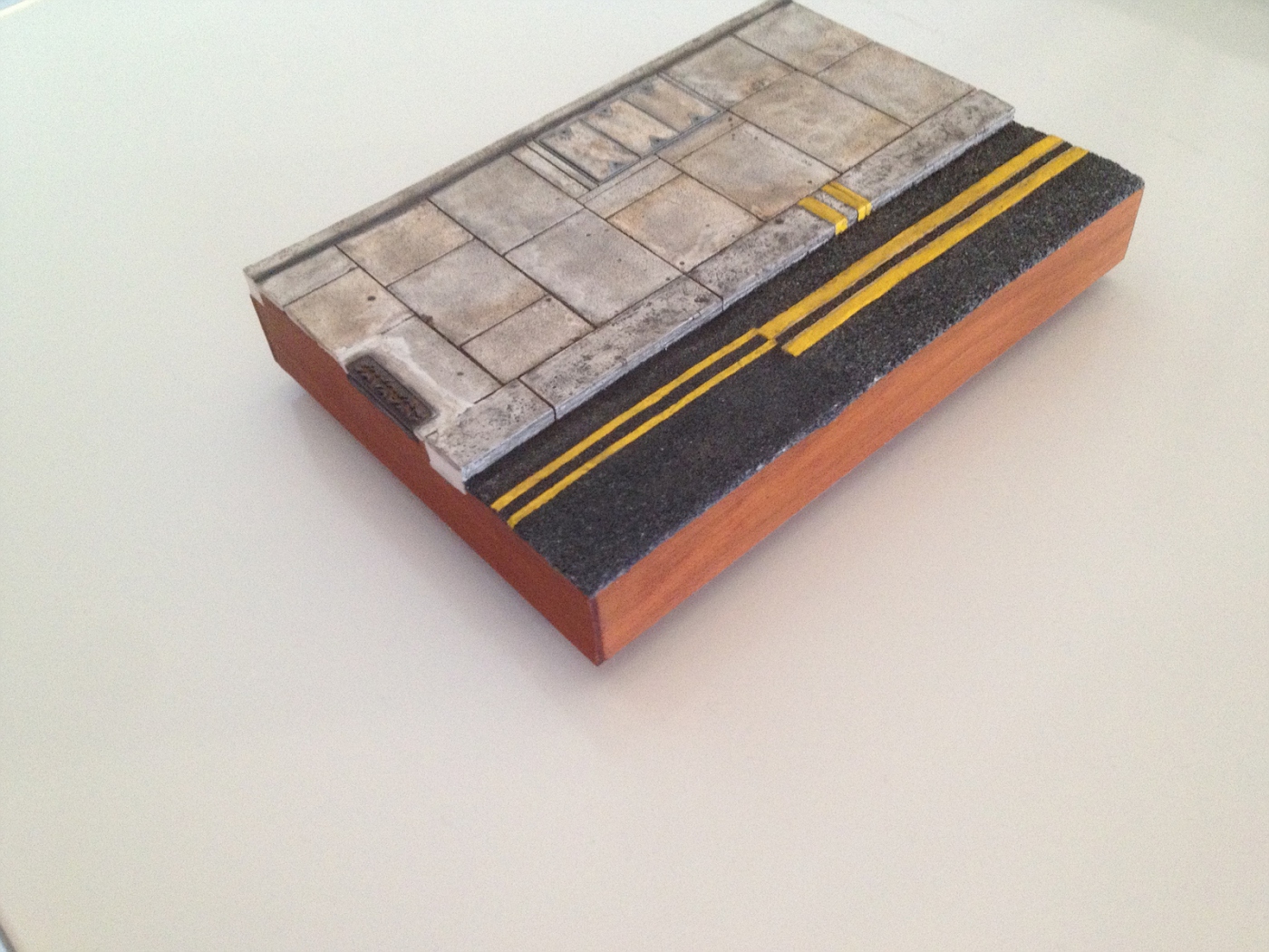

Hello, It has been way too long between builds, but I have just finished one. Its for the end-of-year benefit at the Barbara Krakow Gallery in Boston http://www.barbarakrakowgallery.com/ this December. I will be in some very esteemed company, which is more than humbling.
Its a little section of Jermyn Street in London outside the Cavendish Hotel (Lottie Crump in Vile Bodies ran the place, and there was the 1970s TV series The Duchess of Duke Street) where all the lines in the footpath, the kerb stone and the asphalt resurface all aligned in a very unexpected way, and all I had a were couple of night time snaps to guide me.

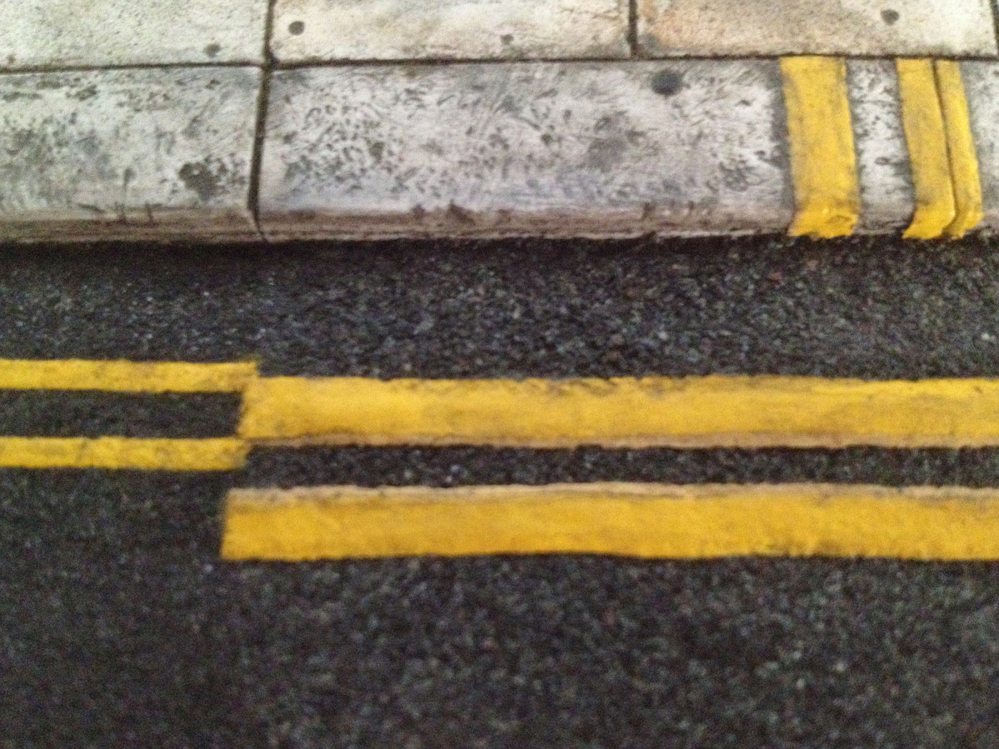

It all the same usual stuff, carborundum for the road, hydrocal for the pavers (all individual), plastruct shapes to make the access covers. The one exciting development for me was to paint out the road lines on greaseproof paper with fluid acrylic paint and then peel them off, and use PVA to glue them onto the model. It gives the lines the right thickness and can be overlapped to build up the lines, like on real streets (and please excuse my iPhone snaps).
Thanks for your time
Narayan

I'm curious as to the meaning of a double line next to the curb. Also, I'm guessing the short double line on the curb itself is a marker between parking spaces, correct? Or is it something else?

this is great work. The idea with the acrylic based lines is very interesting. The section looks very realistic. Especially the bright concrete repair around the cover and the chewing gum blotches catched my eye. Could you please write something about the coloring of those three iron framed concrete covers, i. e. of the steel frames? It's a bit hard to tell, but it looks very much like "shoe polished" steel on sidewalks.

Ray, as far as I remember,  the double yellow lines mean that you cannot park there at any time except for pick up and drop off. The double yellow lines on the kerb mean that you cannot pick up and drop off at that location.
Volker thanks for your close observations. The chewing gum is black, fine milliput as is the "caulking" that runs along the top. The silver frames are 3 sheet plastic trays that fit into a larger frame (like the prototype) detailed with added plastruct triangles (the hole in the triangle should be oval, but I was not able to control the drilling well enough, so I compromised). I painted them with canned spray paint (I am too lazy to use my airbrush...all that cleaning!) from the art store: first dark grey, and a little mist of mid-grey, followed by matte aluminium. I burnished the surface smooth, and filled the trays with hyrocal. I touched up the silver surface with a silver pencil and an 8B pencil and used a cotton bud to blend a little. I hope that answers your question.
