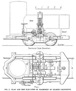

Now I've finished the Alco in 16mm scale I was looking for a new project and came across this. The John F. Byers Machine Co of Ravenna, Ohio only built around 5 locos between 1896 and 1906.  This is their "T" boilered vertical cyluinder geared engine available in 3ft gauge and standrad gauge (where the wheels were simply set outside the frames!).  Looks a classic to build so have made a start - the more you look into it the wiereer it becomes! The supports for the vertical cylinders were a "pig2 to make - ended up laminating thick styrene then cutting it out with a fretsaw and finalling sanding to the right profile. I'll post some progress pics soon.

The "buckets" on the roof are actually the tops of what look like grain silos in the distance. It must have been a horror to ride, there is no suspension, a very short wheelbase and the brake wheel connects to the rear drive not the wheels! The are some drawings on a web site showing all the gearing otherwise I would just not be able to get my head around it.

I've made a start in 16mm scale.  Styrene plus wood for the unusual (as with everything on this engine) front end and "buffers". As you can see the support column for the cylinders were a bit tricky.  The wheels have just been temporarily placed in order to get the base plate for the gears in the corect position.
