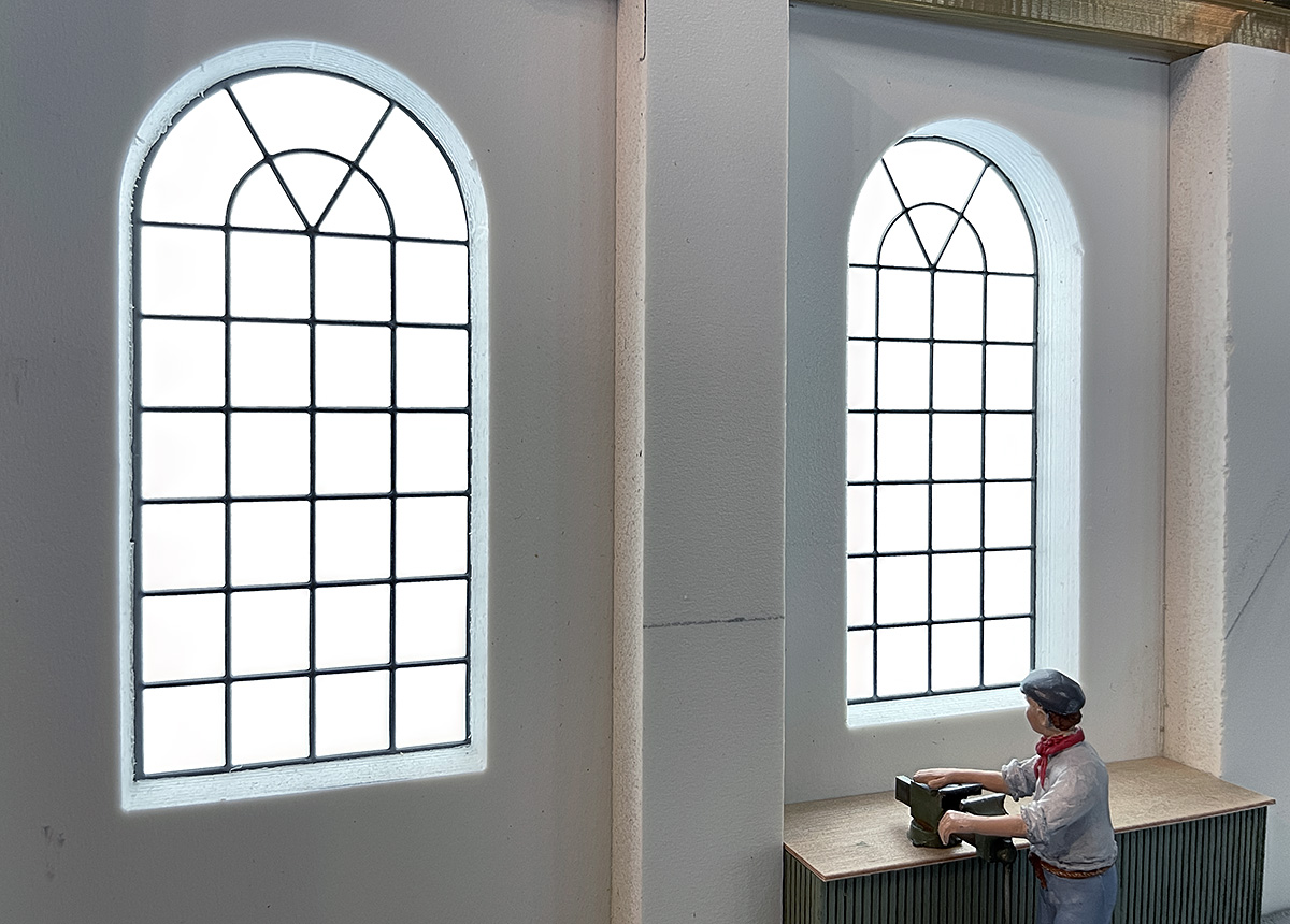

I have no altar or pews, but at least the windows look quite sacral at least:

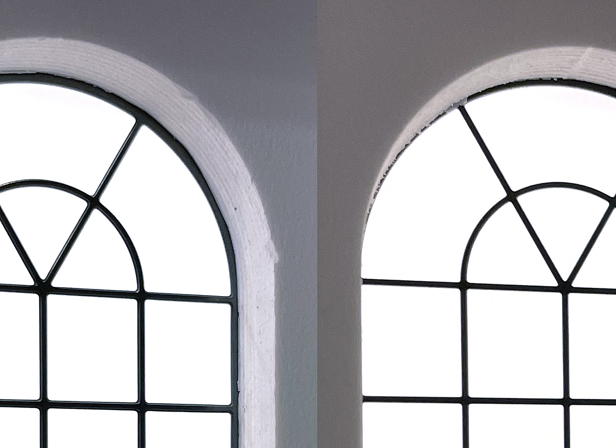

I am experimenting into the absurd here, but I felt that the etched windows looked a little flat in the 0,25mm sheets I ordered for all the metal parts. So I had another set of windows etched in 0,6mm metal. The idea was that might look a little more like cast iron windows with a little more "beef" to them. I think they do, and I feel that the "tent" effect on the edges of the edges helps in this. This tent-shape of the edges are usually a bug and not a feature, and on etchings as thick as 0.6mm they usually would have to be sanded flat. A close up might show the effect better:

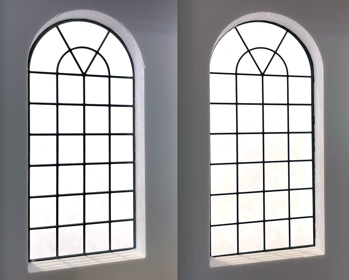

Since last time I have experienced a bit more with Affenity for focus-stacking, and it is a bit better than photoshop, and faster to use:
Affinity is the top image, photoshop is at the bottom. the differnce in color has nothing to do with the software, I just tweaked them a bit different.
The window upgrade probably was unnecessary but does look a tiny bit better. The Affinity depth of field stacking looks better and so does the overall modification of the image. Altogether, then, your work is a complete success. -- Russ

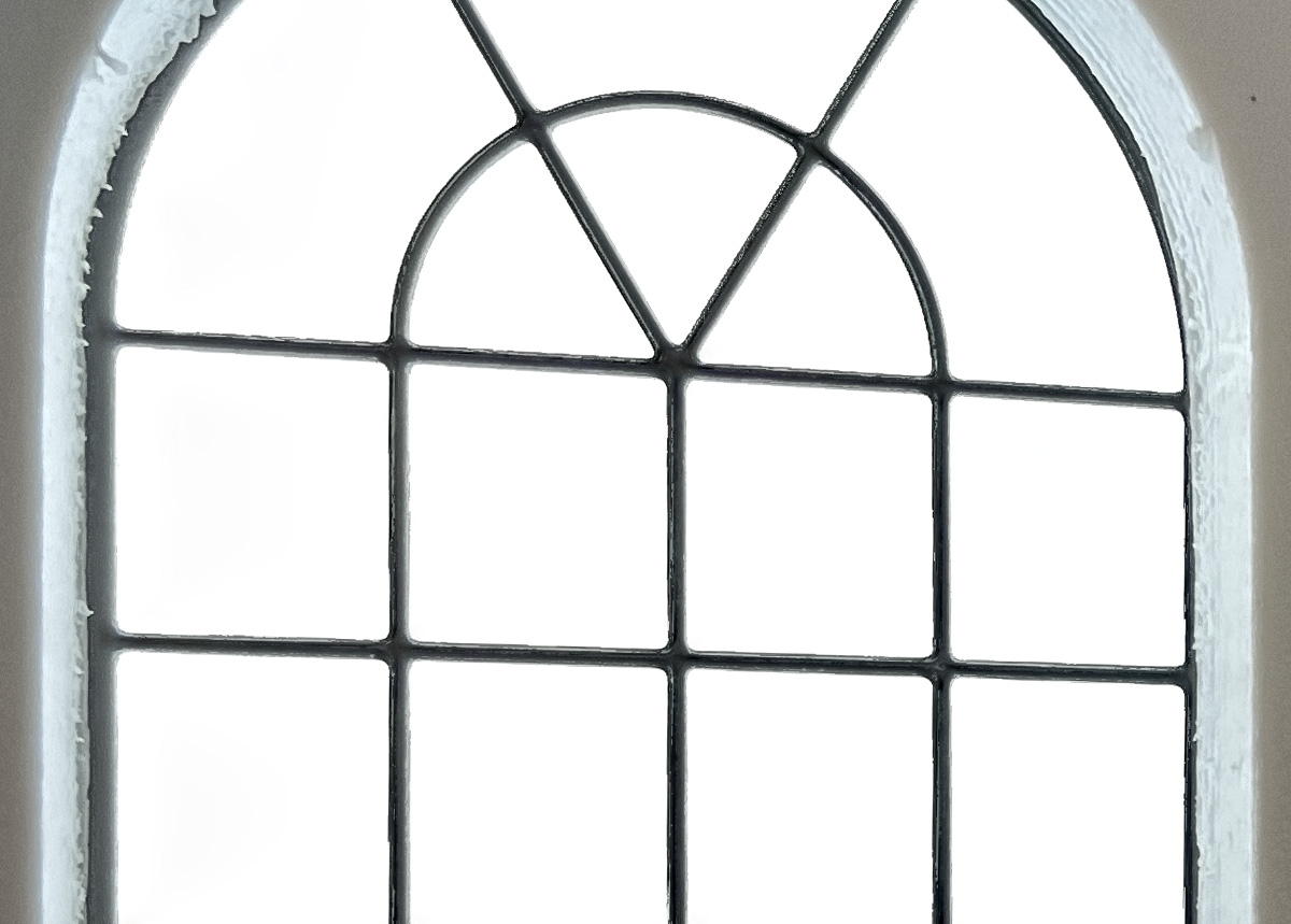

My musings on the different thicknesses of metal for the etched windows were perhaps not as clear as I intended.
So I made a side-by-side comaparasion of the 0,6mm and 0,25mm thick etchings. The 0,6mm etching is to the left:
It is worth noting that the artwork (photo-tooling) is exactly the same. So the mullions are the same width, only the thickness is different.
I think that the 0,6 version looks slightly more 3D. But the question is if it is worth fuzzing over it. When the diorama is completed, I doubt that anyone would have noted the difference. At times I find this type of experimenting fruitful, but this time I just feel a bit irritated with myself for wasting time and money on this!

Quote from: Hauk on November 14, 2021, 11:44:10 AM
I agree with your assessment, the 0.6 version is much more effective and readable. Whether or not anyone else notices the difference is not particularly relevant, you will, and it's better to commit to the version that pleases you now rather than wish later that you had made the change. No need to feel irritated. Though it may seem like it at the time, neither time nor money is wasted if you learn something from the experience.
