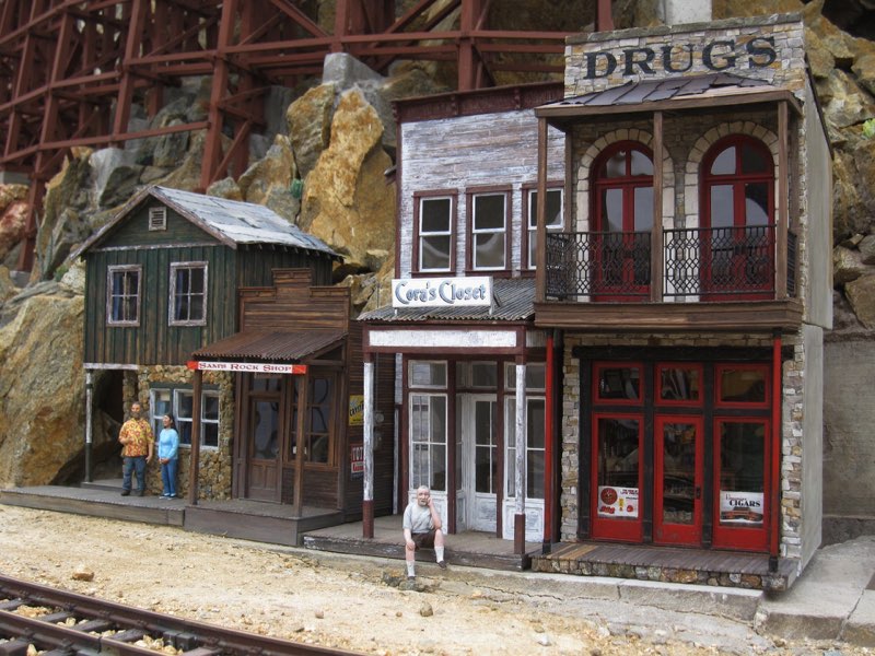

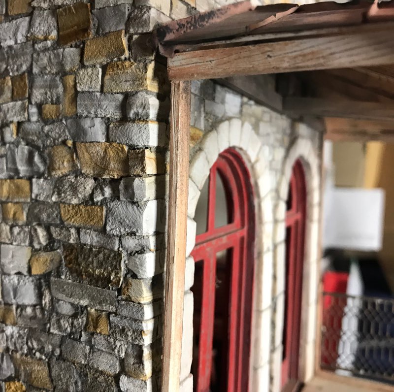

My next project is underway...it's a repair and upgrade of the Dos Manos Drugs building which was finished in 2010.
This structure was built much differently than my current methods. I used real rocks and mortar for the walls. There are pros and cons to this type of construction.
Pro: It holds up well in all weather, never needs to be repainted, and you can't beat the appearance of real rocks.
Con: The only way I could find to make the interior accessible was through the top, so it had to be built in two pieces, and I couldn't make the interior removable. It's not completely moisture-proof. It's heavy, and although it's sturdy it can shatter if accidentally dropped. And unless you have a stone saw it's hard to make stones to fit arches, etc.
Anyway, the real problems with this structure were with the other materials. I had used thin, clear plastic to glaze the windows. This stuff aged very badly, becoming yellow, opaque, and eventually warped and cracked. I used styrene to build the "wooden" parts of the structure, and although the styrene is ok, the paint on it has become worn and faded. Also, I had used incandescent "grain of rice" bulbs to light the interior, and these all burned out rapidly.

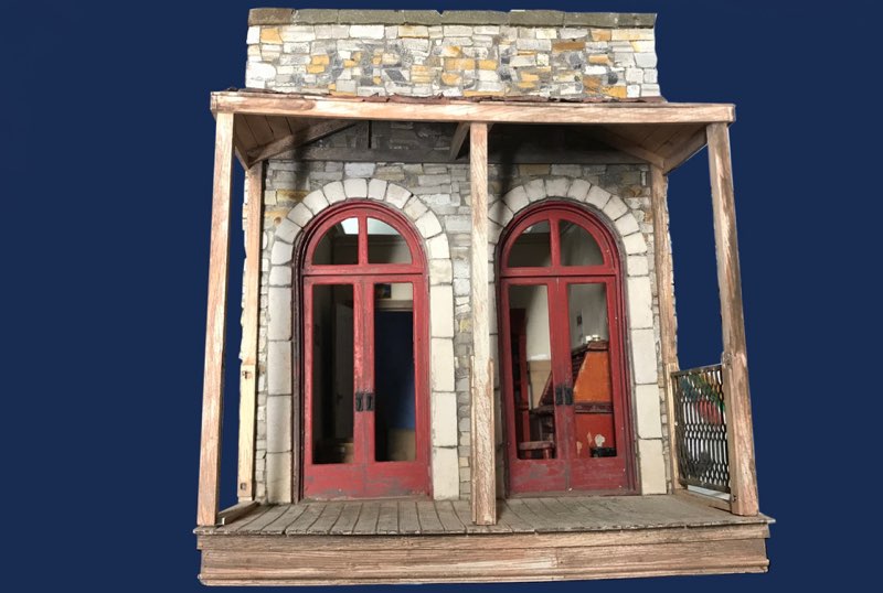

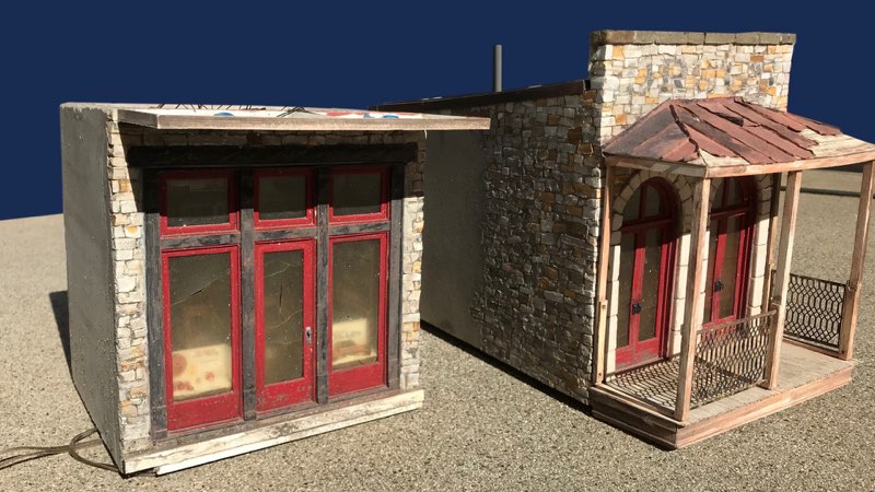

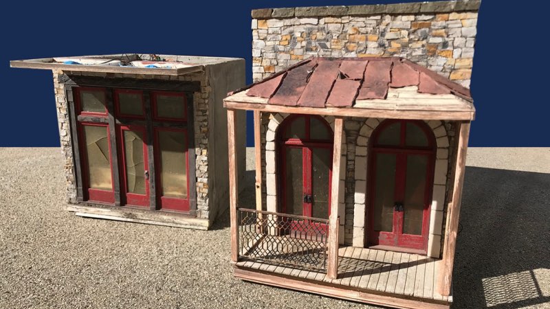

Here's how the building looked after I removed it from the layout. A few parts broke off as I was handling it:

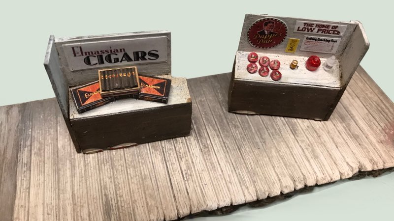

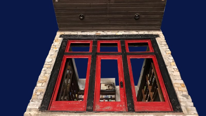

I started with the ground floor, since it would be the easiest to repair. The first thing I had to do was remove the displays that were mounted in the windows. These were glued into place but luckily I was able to break them loose without causing any damage:
The displays are in much better condition than I'd expected, and just need to be cleaned up a little. The paint on the "wooden" sidewalk has almost completely worn off, so it will need to be repainted.
Next I removed the plastic glazing from the windows. I was worried this would be difficult, but all I had to do was press on the plastic with a blunt tool, near the edges of the window frames, it it popped loose. When I got enough of it loose, I grabbed it from inside the structure and pulled it off. With that weathered plastic out of the way, you can now see that the interior details are still in good condition:
The red and black paint on the framework was in pretty good shape, just a little dull. The paint on the underside of the balcony was much worse:

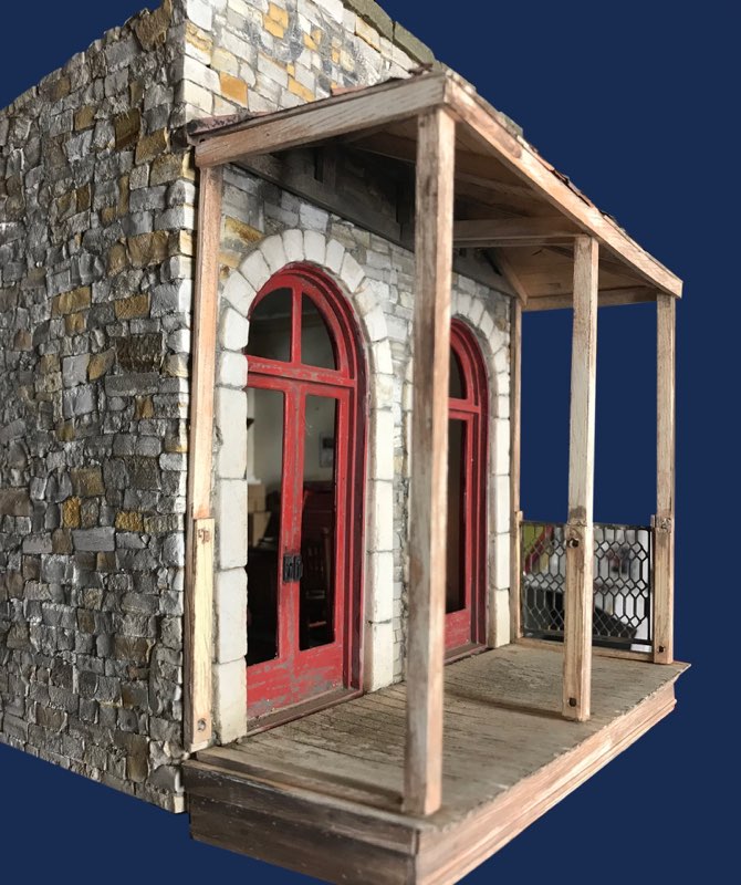

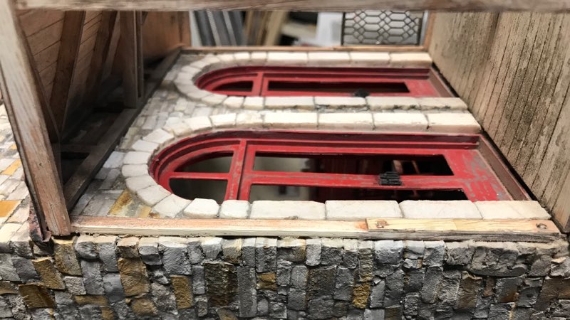

I set that part of the building aside and turned my attention to the second story. I removed the corroded plastic from the windows, but that was as far as I got:
The entire balcony is badly faded and needs to be repainted. Several parts of the railing have fallen off:
This end of the balcony railing and canopy is loose:
It would be easiest to paint the balcony if it were separate from the main structure, but with the exception of the loose bits at this end, the rest is very securely attached. I don't think I can remove it without causing significant damage, and I don't want to be forced to replace it.
So for now I have to put on my "thinking cap" and figure out the best way to go about repairing and repainting the balcony.

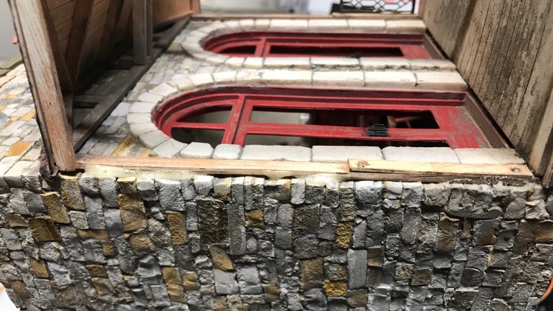

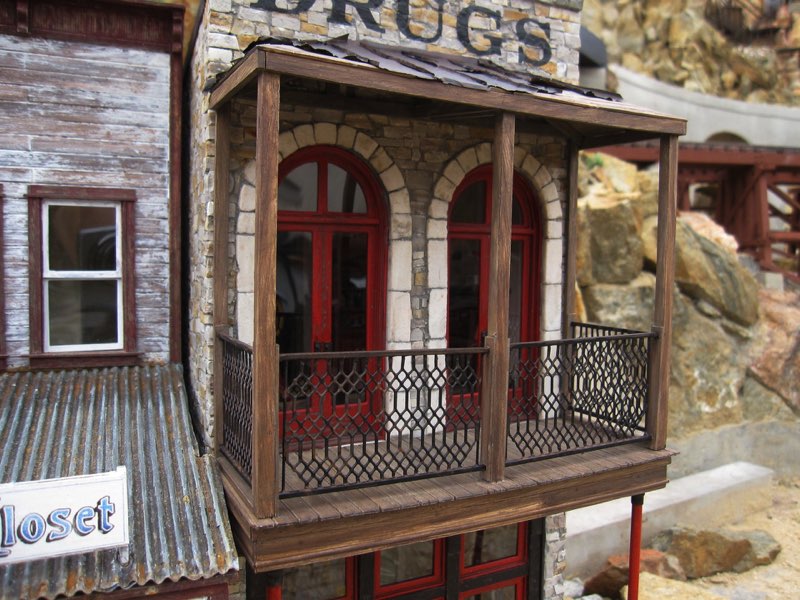

Now that the holidays are over I'm making a little more progress. On the second floor of the building, I decided the best adhesive to secure the loose end of the balcony was Gorilla Glue, a urethane glue. I wet the area first, then used a toothpick to smear the glue under the parts that were loose. The excess glue foams up along the edge:
When it was mostly cured but still pliable, I trimmed off the excess glue:

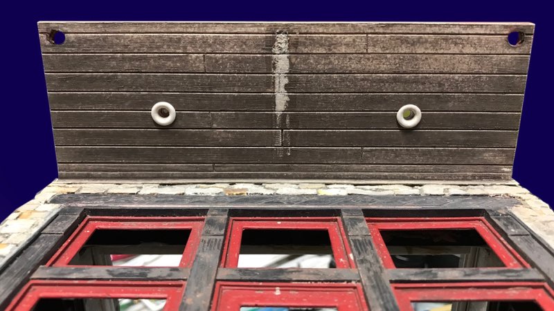

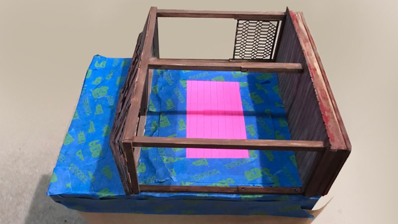

I repainted the balcony using craft acrylics. The coloration isn't as subtle as I had originally done it, but it'll do. Next I needed to spray it with a few coats of Krylon UV-resistant clear matte, so I masked off the rest of the building:

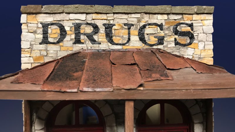

I also repainted the large sign above the balcony, using a small brush. It's not quite as sharp as the original sign, which was done with the aid of a stencil, but it's close enough considering the rough surface:

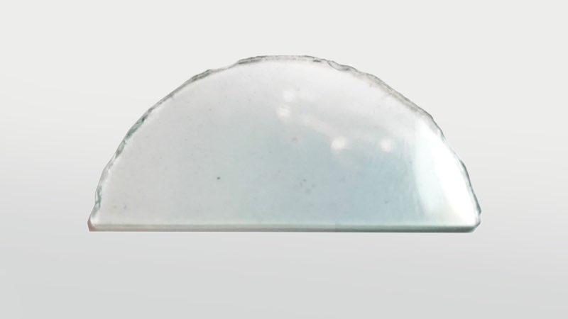

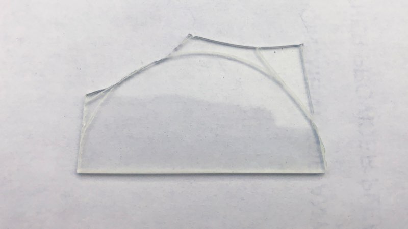

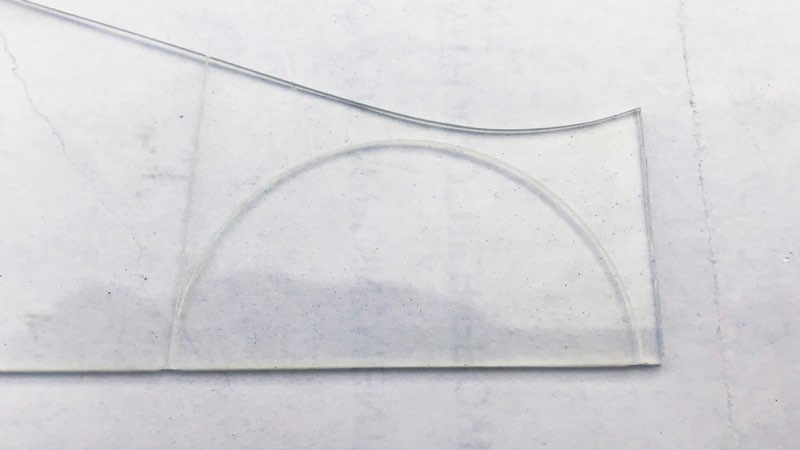

I cut some real glass for the windows, but haven't installed it yet. Cutting the curved piece was a little tricky. I had score straight lines and snap off a small piece at a time until I had a rough curve. The remaining bits were crushed or broken off with a needle-nose plier:

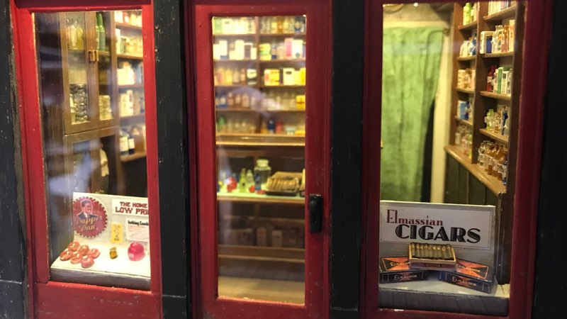

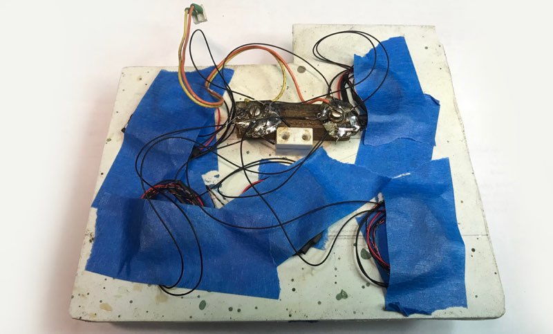

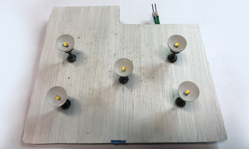

Meanwhile, on the ground floor, I installed LEDs into the ceiling fixtures:

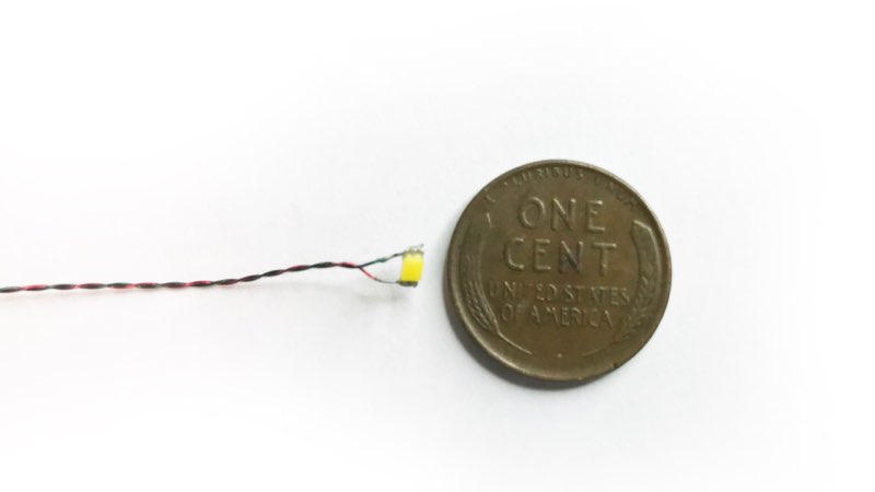

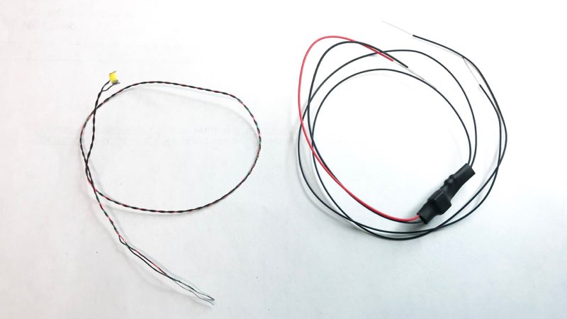

I get my LEDs from Evan Designs https://evandesigns.com/collections/hobby-leds  They sell them with the tiny circuit board pre-wired into the leads. This allows them to run on battery or regulated DC voltage ranging from 5-12 volts. You don't even have to worry about the polarity.
These particular LEDs are the "chip" size. I ordered them with the circuit board on separate leads, so that the LED leads can fit through the brass tubes of the fixtures:
My messy wiring on the top of the ceiling. I bundled the leads and taped them in place:

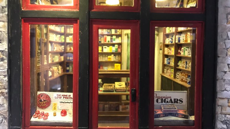

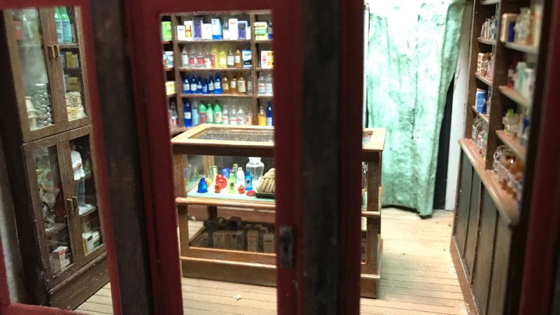

Here's how the storefront looks with the LED lighting:
