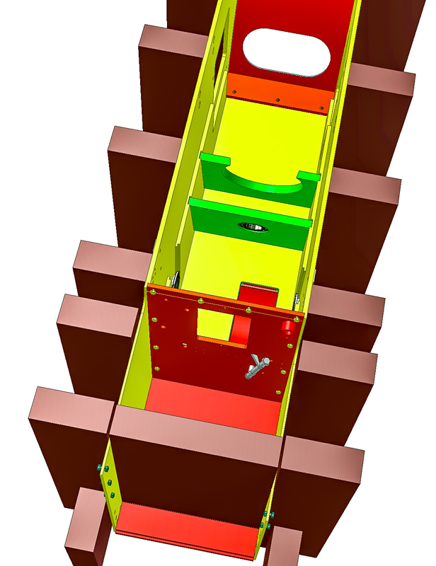

Meanwhile I had milled the outer shell a second time and also made new bending templates from MDF for the larger radius.

For further assembly of the roller I have milled small lessons from hard paper again.

Through corresponding recesses I can fix the exact position, as in this example, the rear cab floor plate to the two side cheeks. To keep the 0.5 mm supernatant of the yellow side plates during the soldering by hand, I was too unsure.

The floor base plate itself was slotted on both sides. For this I have grooved the upper side first. The four 2.0mm brass pins served to accurately position the back side.
