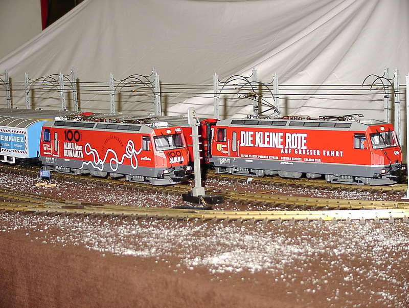

Great model, but maybe for the next model.
I prefer to use transfer labeling for labels. I draw the graphic with CorelDRAW let a Schwarzweis film produce per color with pass notes and then get the self-adhesive graphics back as for the labeling of these two locomotives.
Bernhard
Helmut, hat looks good! Sometimes professional solutions are really the better choice.
