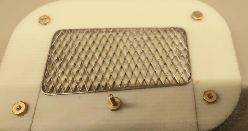

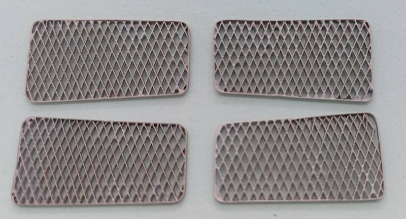

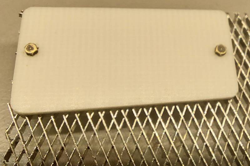

Between 2 GRP stencils I saw out the grids with a back-sloping fret saw with a very fine metal saw blade. Around the stencil I also bend the edge for the edging.
Used in the solder gauge made of 1mm GRP, I can solder the 1.2 mm high grilles excellently.
I can't afford employees and I sometimes wonder how many model builders there are who could imitate that.
Thus, the series production could be successfully completed by myself. 2 left and 2 right kicks are needed. Since they are the same from above and below, all 4 could be soldered in a stencil.

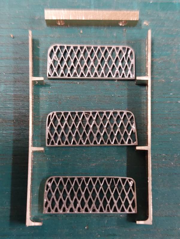

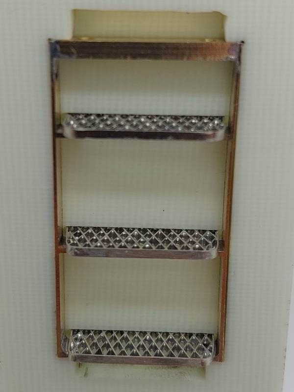

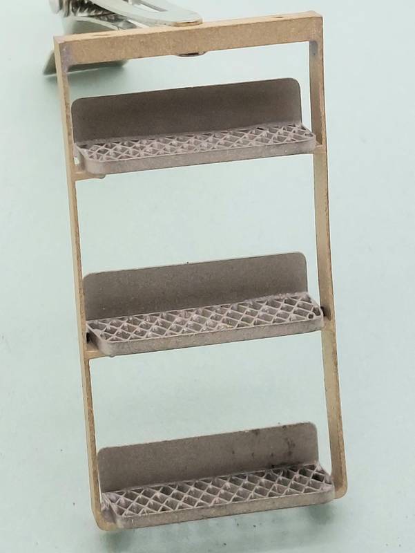

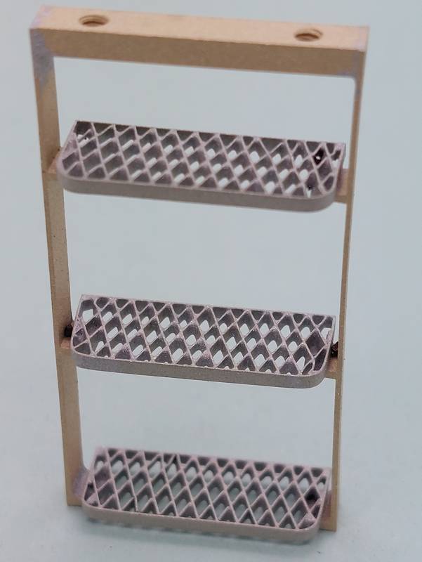

Today I can imagine the ascent to the driver's cab. The material was also sufficient for this, as it was included and was also intended for this purpose.
Individual parts for the driver's cab ascent.
The individual parts in the soldering theory.
The almost finished ascent.
I see that my work is being followed and acknowledged.
This is now the finished ascent. The end plates on the step are now also soldered. Incidentally, the whole ascent is made up of 90 individual parts and soldered.

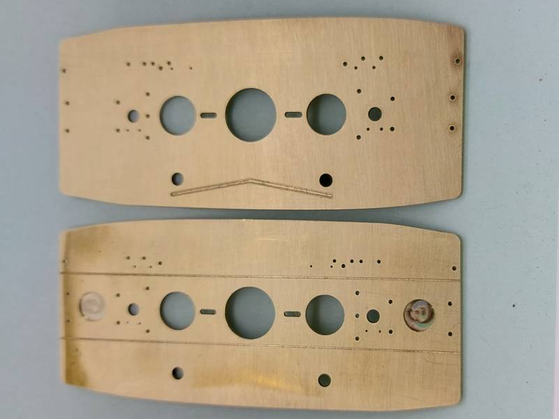

First test for the production of the wear buffer screed. Since I want to produce the buffer screed by bending as with the model, I have processed these parts from the outside and inside. The bending should be done with a bending bench but I have no experience how the 1mm MS63 behaves when milling and bending. Then I can determine the exact production dimensions based on the deviations. In order to be able to bend it at all, I deliberately used MS63.
Here's my abkantest. The material has stretched much more as I suspected and I can correct that now. When drilling, I broke off a 0.5 and a 0.6 mm drill. I will then have to be much more careful when drilling. I had taken this into account when milling and so the milling succeeded better than expected.

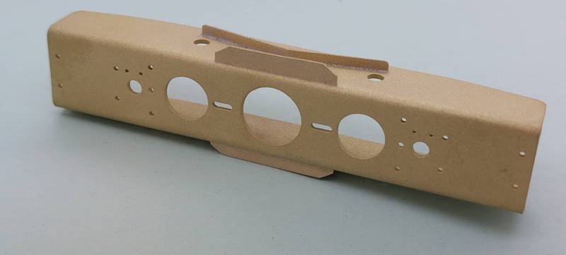

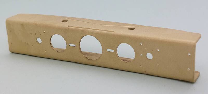

Yes Russ such test are very important to me, that's why it continues with the test buffer carrier.
In the original, the baffles are welded on, in the model I have hard soldered the front sheets with silver solder. The rear angle is softly soldered into the milled V-groove. So I can also implement the series part so that it goes well and makes a stable impression.
