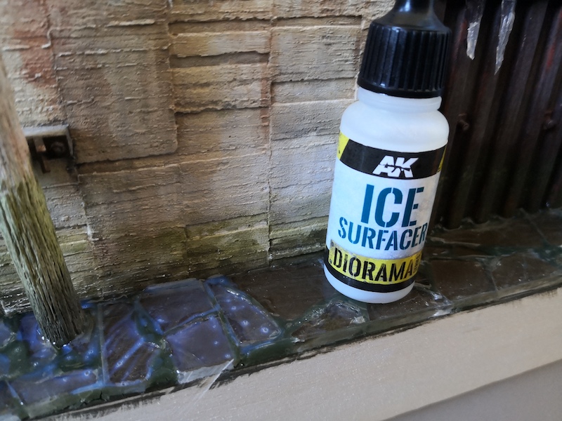

Spring is coming...and I am modelling snow and ice...
I just want to show you how I did the ice in the harbour.
Many pictures with little text..
I am using the products from AK for the first time.
Guess there are other brands, too.
I first poured the whole surface of the harbour:
Then I made small pieces with the help of my friend "hammer"...
Glued them on the prepared surface with some gaps between the pieces
Then I filled the gaps with acrylic water:
Added some ice surface.
But I wasn't happy with the result...
So I added another layer of snow
Finally it looks quite OK
Next time I rather make the gaps wider to add more water and less ice.
Greetings from Switzerland
Thomas

For the ice: my goal was not to model the smooth and white ice as one can see in the very northern parts of the world.
Rather the ice as one will observe in the harbours like Hamburg.
https://www.google.com/imgres?imgurl=https%3A%2F%2Fmedia1.faz.net%2Fppmedia%2Faktuell%2Fgesellschaft%2F2214363422%2F1.915891%2Fdefault%2Fnur-wenn-zeit-ist-oder-es.jpg&imgrefurl=https%3A%2F%2Fwww.faz.net%2Faktuell%2Fgesellschaft%2Feis-im-hamburger-hafen-der-huebbe-bricht-s-1913526%2Fnur-wenn-zeit-ist-oder-es-1915891.html&docid=DIgSp4gcJ6-wnM&tbnid=a0AZhA8hpHvYnM&vet=1&source=sh%2Fx%2Fim
Thomas
You did a nice job of copying the appearance of that ice. -- Russ
Good job, it does look very much like your prototype.
