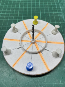

The completed rim is then positioned over a template showing the individual spoke positions.
You might find this site useful , as well as containing a lot of options it does a spoke one where you can feed in you wheel diameter and number of spokes ...... in this case 12 , 6 at front and 6 at rear
https://www.blocklayer.com/hub-spokes.aspx
You may also spot that the rim is raised off the template , this because in this case the spokes are dished and therefore the hub is wider than the wheel rim .... so the rim is raised by the width of hub minus width of rim , divided by 2

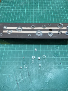

The hub is made from a variety of different sized rings cut from plastic tubes , you can see my high tech sanding jig to ensure rings are a consistent width..... I know there are a lot people who can cut accurate rings direct from tubes but it's a technique that I have never mastered .
The hub is centred on template by appropriately sized drill bit ...... the template itself is just glued to some cheap cork coaster I bought off eBay ..... handy as they take pins easily .

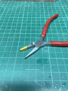

Spokes are then cut to correct length and the ends of the spokes given a slight bend at each end to enable them to lie flat on both the rim support and the hub ........ yet another example of my high tech techniques , note the tape on pliers to enable me to bend the ends all the same length.

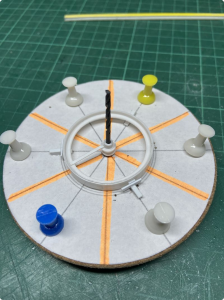

Spokes are then glued to rim and hub , complete one side and then leave to harden off for an hour or so, flip over and complete other side ....... All Done  ;D ;D
It might be of interest , that for this wheel because I was a bit concerned over the strength of the spokes so I used 15 by 60 thou strips ...... in hindsight I wish I had used 10x60 thou which would have more than strong enough ... and would have looked better
