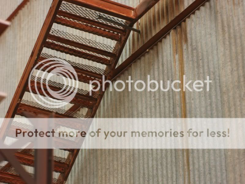

This is a close up of the staircase on the side of the foundry building. It is constructed from evergreen styrene and expanded aluminum mesh for the treads. The corrugation is crimped printed coverstock. and the rust stain on the asbestos corrugated is from prismacolour pencil. The weathering and painting is all preliminary at this stage, as things progress i will be doing finer detailing, as i learn new tricks.
The big nail is a 3 foot mother and boy are they hard to come by, what with the cost of steel these days ;)
regards Michael

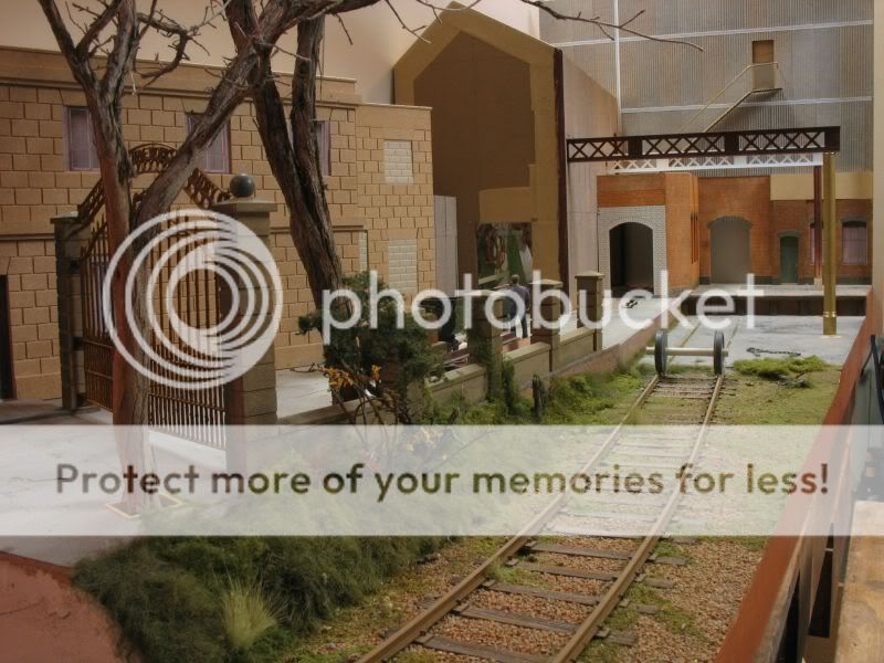

Hello Paul The model is 24 x 61 and depicts a 15 inch gauge Locomotive works line works line. The scale is 1/24 using 16.5mm gauge code125 track for the 15" track and 2 5/16 gauge code 210 to represent standard gauge.

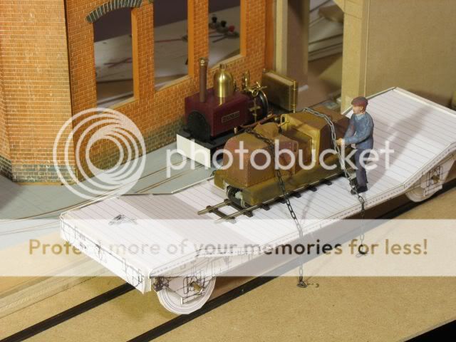

here is a shot that depicts the overall design of the model
This early planing shot gives some sense of scale between the standard gauge and the 15" gauge. the locomotive on the well wagon is a Bachmann GE44
and the little red loco in the background is a Bachmann Percy(heavily modified to represent a Horwich well tank loco)
Incidentally I am looking for a decent drawing of the well wagon should anyone know of a source.
The idea is to have an overhead crane above the loading area and dock.
Then I can load locos onto the rail line or the back or trucks.

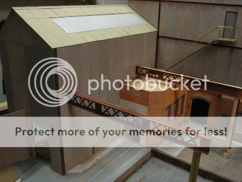

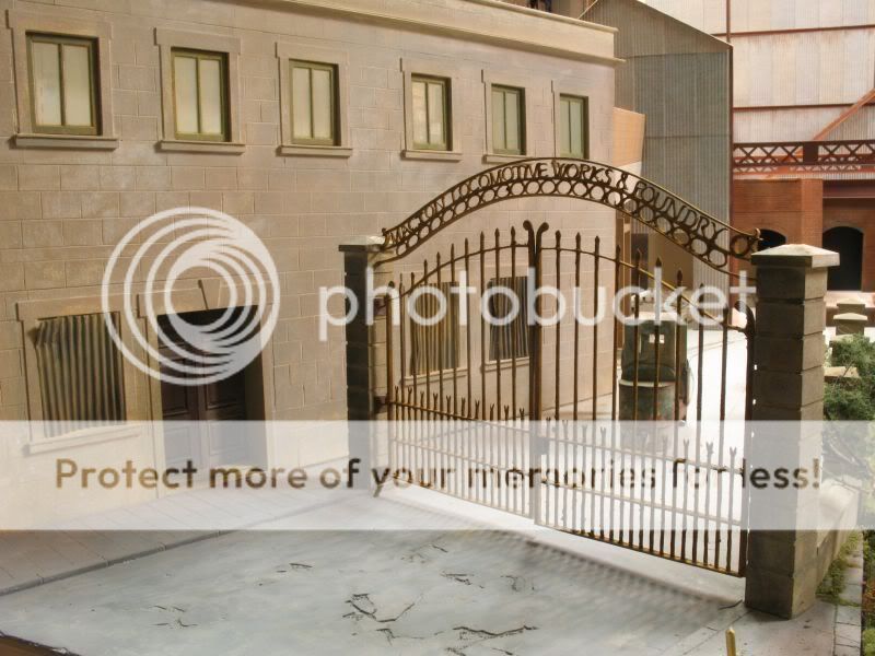

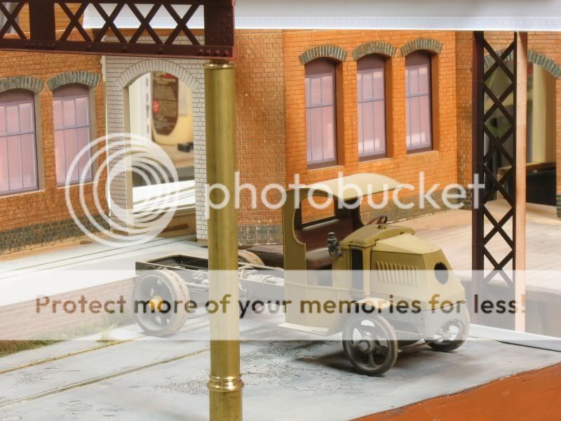

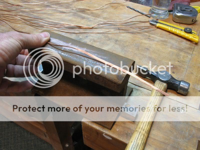

These pictures represent different times and configurations of the main buildings over the last few years and now they are pretty much finalized and are mostly card and paper. with the exception of the brickwork which is watercolour paper bricks glued to 1/4 inch MDF. The overhead beams are made with evergreen strip and sheet. the rivet detail is embossed with a homemade rivet tool. The works gate is made from flattened electrical copper wire beaten on a piece of rusty rail track as an anvil.
Probably enough rambling for now.
regards Michael

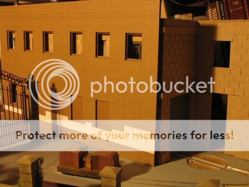

The sandstone building has gone through a period of change as well, the first "stones" were done from strips of MDF but I was not happy with the results, so started over with corrugated card foundation with archival matt board scraps to lay up new "stones" out of card.

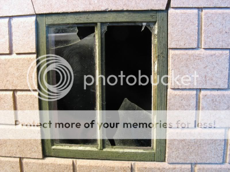

The windows in the sandstone building were made of wood frames with slide glass after reading Chuck Doan's postings about the backscene for the 1/16 scale tractor. The glass was glued in first with acrylic matt medium then white modelling putty was used as a "putty" for the glass.
The wood was cut from a salvaged maple window blind that I picked up ar the local landfill. a dog had chewed the corner of the blind, I saw it as a source of thin maple slats.
The picture of the window shows it installed in the MDF stone which I abandoned in favour of the card one at the begining of this thread. The door in the building is made up of real wood as well but I'll leave it there for now.

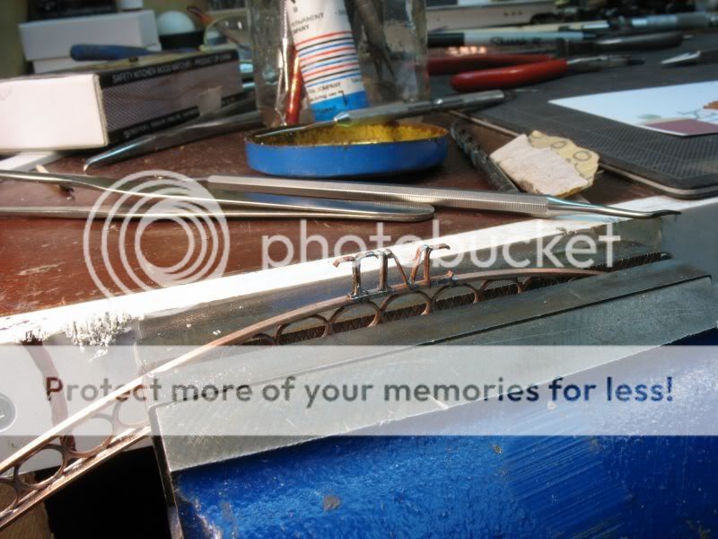

How did you do the lettering over the gate?
Michael,
Any progress on this wonderful project??
Marc, I have not been able to do anything on the model for a while, I moved to the country and built a house. I do not have a workshop yet and am managing to do some modelwork at the computer desk. I did build a garden loop for some larger scale stuff. I am presently having some fun learning how to make figures.
I have not checked in to this forum in a while so I am sorry for the delay in answering your question.
Ray the method that I used to make the letters was by folding up some of the flattened copper wire with some needlenose pliers, I laid the letters over the drawing to guide the bending. I had a few rejects along the way.
