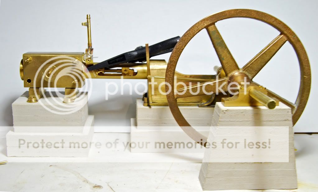

Well the last foundation is done.
I may try again though.......
I have started on the governor too. It is nice to be back at the lathe/mill.
Not much of it shows in the picture, the arms and such still need attaching and I need to find some small brass blass for the ends (mine are way too big)  ;D ;D ;D ;D
Lots of jigs were involved in making the arms, and soldering them up.
Anyway I like to post on Sunday, kinda sets a goal for the week.
I will scan the reference etching for the governor and post it with the finished one.
Beautiful! Those foundations are much better.
-MJ
Excellent.  Really like the casings now.  And the machine just as one would expect perfection.

Hey Marty,
Those blocks look much better now...and I see you have been working hard...
still one of the greatest builds on this forum IMO
thanks
Mike
   this is much better..........Very well done.

Excellent progress. And that black clamp really looks real!
Quote from: Chuck Doan on October 05, 2009, 10:29:10 AM
  I've got some of those black clamps . Will that make me as good a modeller as Arty Farty Marty ?
All the prototype pictures of Corliss steam engines I have seen have the big clamp on them.
Right next to the oversize penny.
Nick, I'll never even be half as good as you, even with twice the clamps!
-Mj
