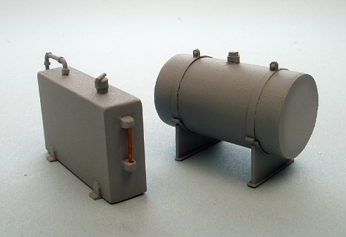

UPDATE:

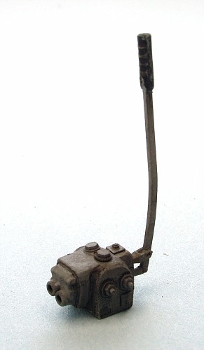

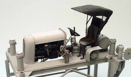

Here are a few of the details completed over the past few weeks:
Hydraulic oil tank & gas tank.........
Valve bank for hydraulic cylinders......
Shifter & linkage and a hydraulic pump (mounted under the generator).........
and a dipstick....
Oops - looks like we're a quart low:
Plus, the top's been painted and most everything has been hit with the first coat of primer......
None of the stuff (except the firewall) is glued to the deck yet.
That'll come after most of the painting is finished
Thanks for looking.................

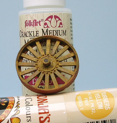

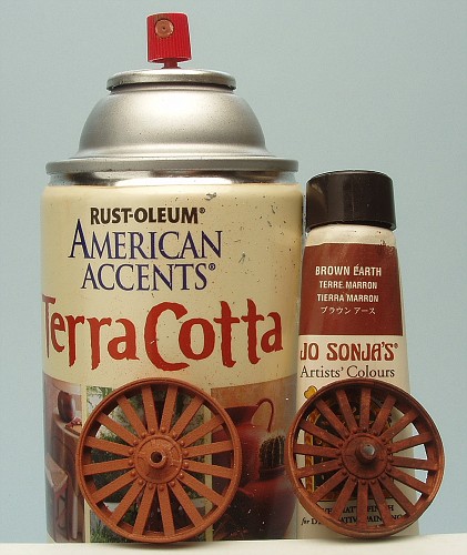

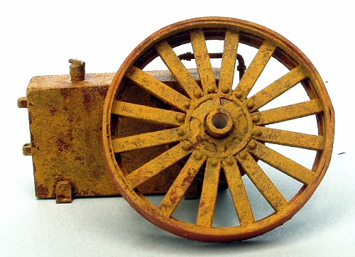

Time to bite the bullet and start painting the components that are done so far....
Chuck's techniques are top notch (...understatement...) so I tried the "hairspray
base coat" method - with disasterous results. I guess that's why "Chuck" is "Chuck".
Playing on that theme, though, I tried this next:
After spraying the pieces with Plastikote T-235 sandable automotive primer, I dusted
on a coat of Rustoleum "Terra Cotta" to give the surface a fine texture.  That was
followed by a rough, stipled application of Jo Sonja "Brown Earth" acrylic paint........
When that dried, I decided to play with Crackle Medium.  I applied a coat of "Folk Art"
medium from the craft store; let it dry; then brushed on a moderately thinned coat of Jo Sonja
"Turners Yellow".  It has to go on with one stroke or you start to pull off the water-based
crackle layer.  It's supposed to crackle as it dries, but there are so many variables that the results
as really inconsistent, depending on the thickness of the paint and the crackle layer, drying
time of the base coat, etc.  It's almost impossible to get consistent results.  Plus, with the
textured sub-base, the "crackle" (if any) isn't all that obvious......
However, between the Terra Cotta and the (minimal) crackle, there IS a little texture.

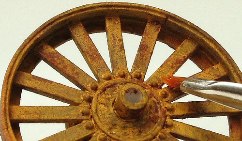

The next step, per Chuck's method, is the pick off the top layer to expose the rust base coat.
Here, I brushed on a quick coat of clear water to loosen the surface, then scraped a stiff brush
bristles-first across the surface to pick off the paint in spots.  If you look closely at some of the
spokes, you can see some of the "rust bumps" created by the Terra Cotta layer.....
Here are the results so far.  Still a long way to go, and nowhere near the finesse and realism
of Chuck's results, but the "picking-off-with-a-stiff-brush" idea has potential.
