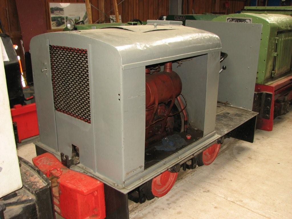

  Feldbahn.....................http://www.werkbahn.de/photos.htm  lots of them.
  click on the manufacturers name and see for yourself......
  this one is nice  http://www.merte.de/bilder/diema_1306.jpg

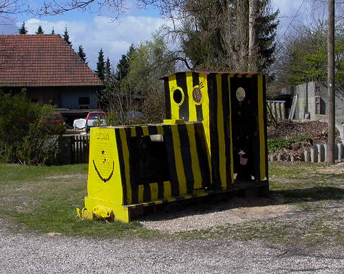

   I'll remove that Diema photo when Marc put his machine on wheels  ;D ;D ;D

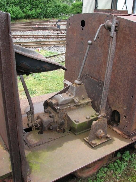

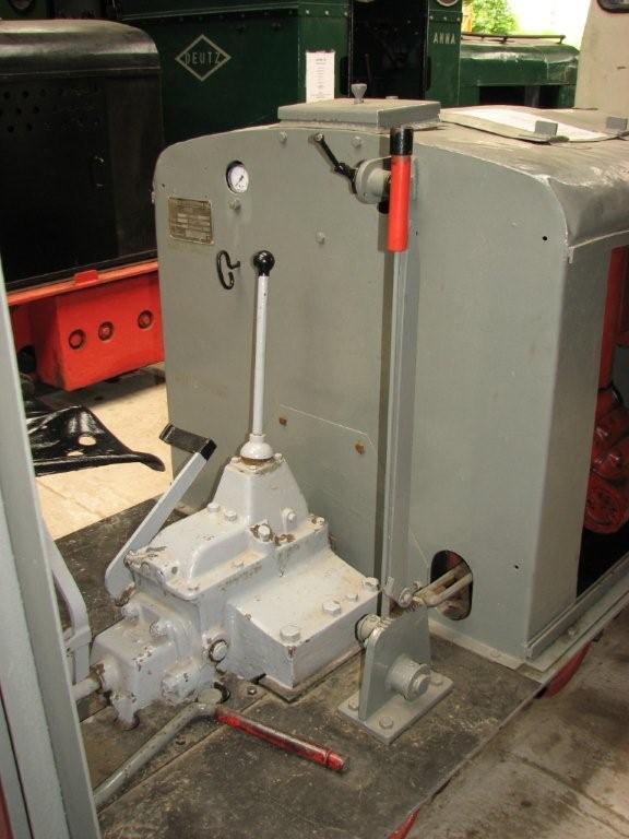

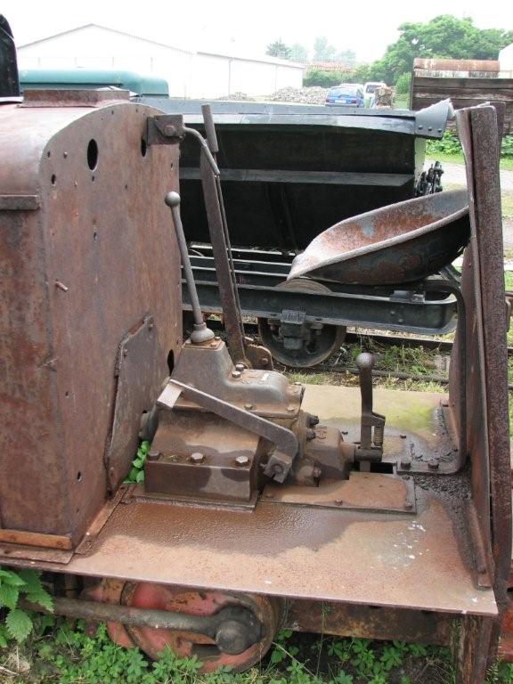

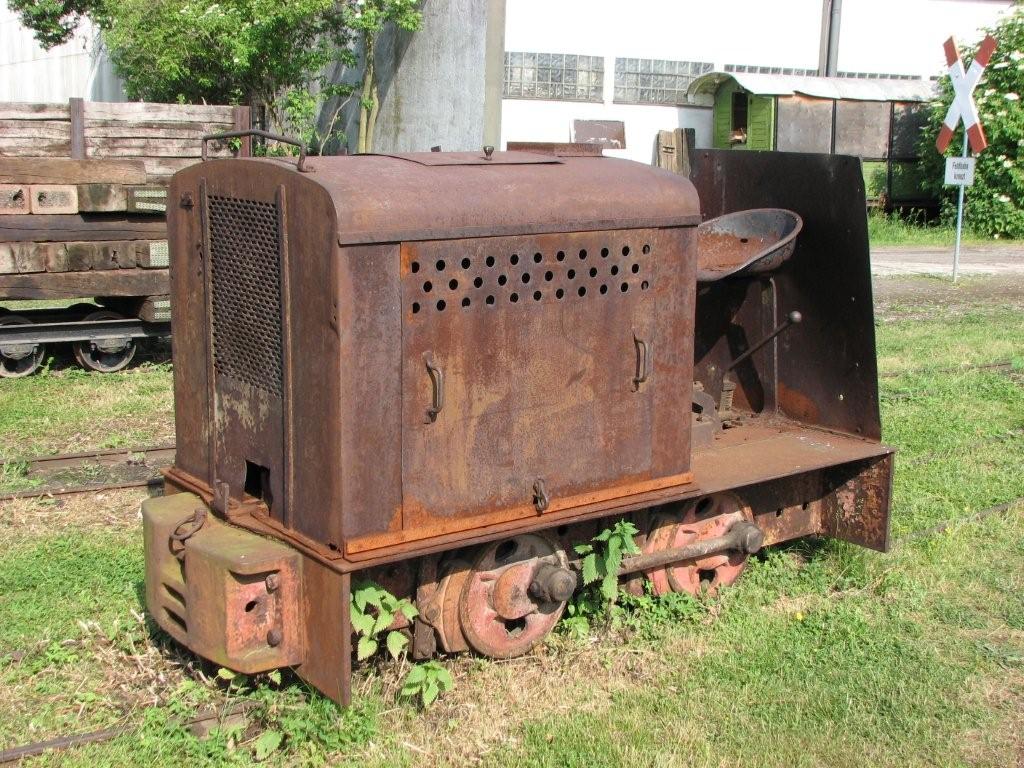

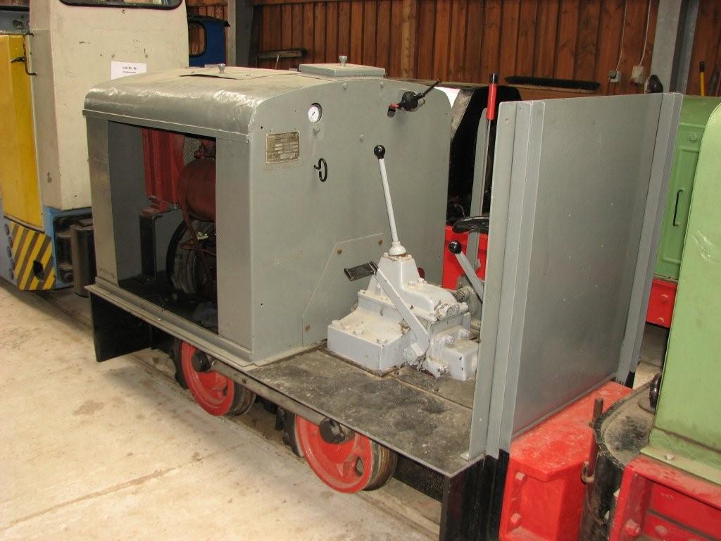

Have now been rethinking the cab...was originally planning a typical enclosed cab, but seeing the proportions come to life (full cab may seem ungainly and visually overweighted), I am now really leaning to a low-wall, no roof version; or a low wall version with a just a 4-pole supported arced sheet metal roof.  ???
Maybe I need to do a cardstock mock-up of the options. :-\
.....input on this is conundrum is welcome from anyone with an opinion.
   Marc,
   this comes along very nice, well detailed, ...... I agree that a closed cab will spoil the proportions.
   Doesn't the werklok site offers plenty alternative idea's ?   Maybe an umbrella ?   :D :D  An open one offers a lot of potentials for
   gear-, brake-,throttlelevers, dials and a wel worn seat.
   It is now too late to remove the bee-diema. This one on a playground is based on a children's tv program Die Biene Maya.
   The best is to leave it to the kids to get rid of it.
   Looking forward to see your vision on the balanced whole, particullary the behind, and of course your paint SBS on this one.
Very nice indeed.  Will be interesting to see what you come up with for the cab.
Love those wheels!!!! ;D ;D

Hey Marc! Wanna hairbrained idea for a different roof? Well you're gonna get it anyway. How 'bout a tube frame and a canvas roof? Some brass rod with some cool little brackets.

Nice Job! An open cab will be much better  ;)
