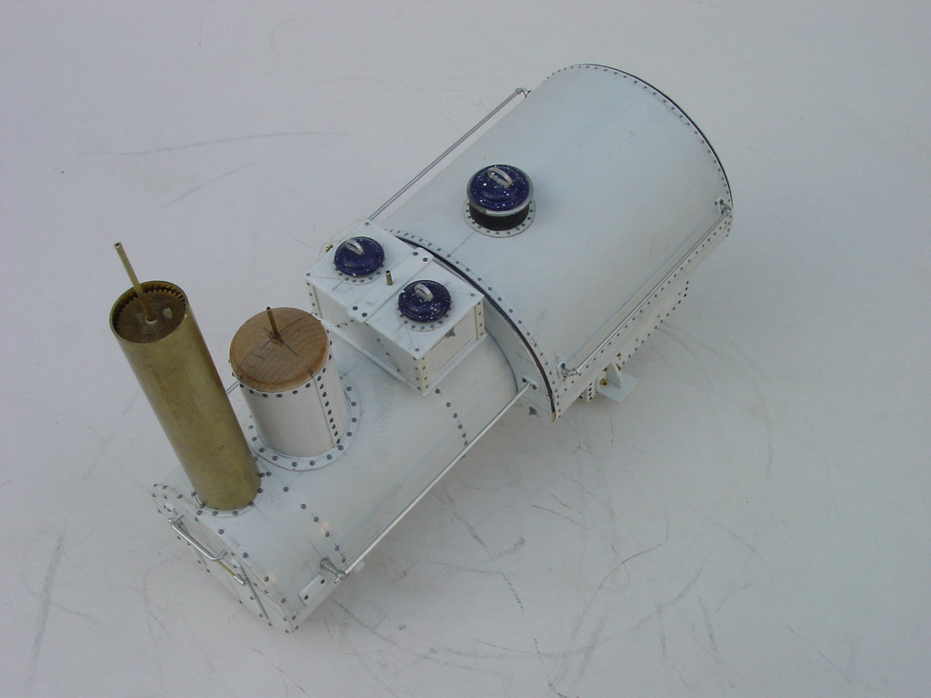

Here are two photos of the second loco. Now the work can go forward  on both locos.

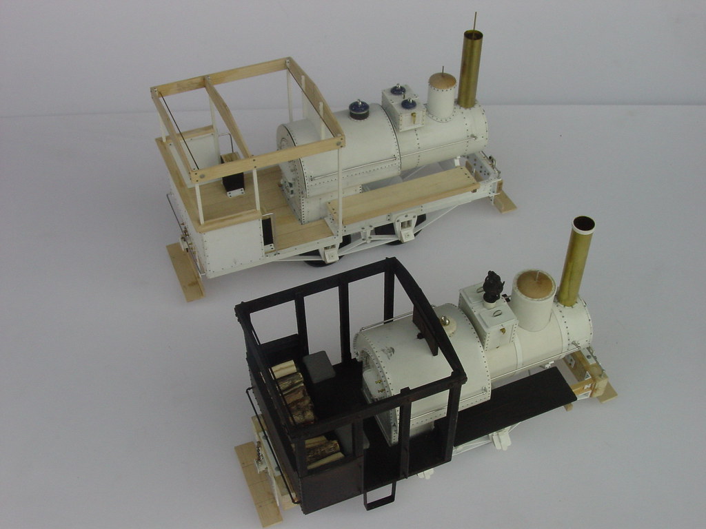

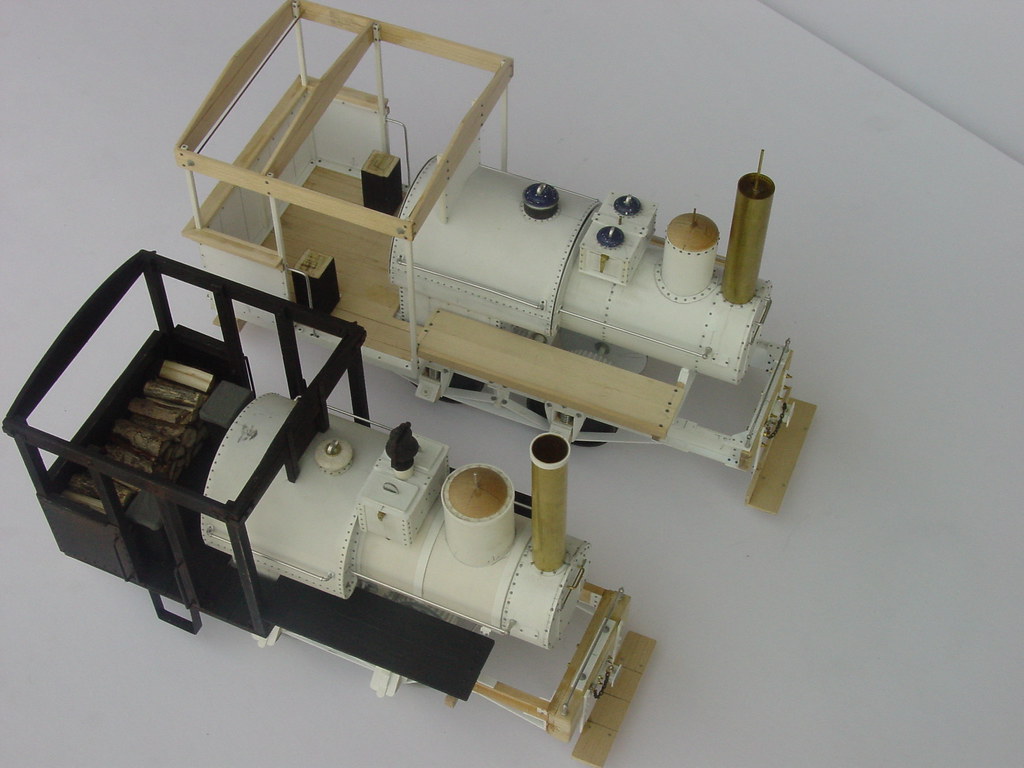

Here are two photos of both loco. You can see how far I was off with the first.
Who cares whether the first one was "far off"? It looks great anyway. Call it a freelance and nobody will complain. I think both are outstanding. -- Russ
They both look great! BTW, what is the thing sticking out of the smokestack?

Ray, that stack is not finished. I still have to add a top section. The 1/16" piece of brass tubing goes into a hole  on top of the boiler and down to a hole at the bottom of the boiler. This is straight  up and down and acts as a guide for the stack I took two old gear from an old alarm clock with the same diameter as the inside diameter of the stack. I placed one on the tube at the bottom and one near the top with a 3/32"  piece of tubing for a spacer between the two gears. Now the stack will be straight when  placed over the two gears. This also acts as a good anchoring system for the stack.You can see the top gear in the top photo on page 4 of this thread.
I agree with Russ too Gordon. You never know, you could always claim the first was a preliminary version subsequently discarded at the customer's request from the original builder's drawing board! Outstanding work on both versions...
QuoteCall it a freelance and nobody will complain
Quoteyou could always claim the first was a preliminary version
      This is what I call a REAL prototype..
      Gordon, the urge to built as close as possible to the original is producing fantastic models, ready for the best musea.
