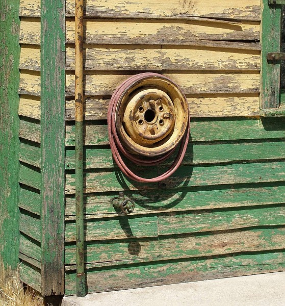

Here's a quickie...a remnant of old air hose on the reel wheel. Made from solder. Painted with Polly Scale Zinc Chromate primer and weathered with gouache and pigment powders.

Chuck,     Air hose looks like the real thing its got that faded out rubber look thats been out in the weather and sun....  How are you attaching the air hose for air... is there a pipe going through the wall or behind the Rim, that we cant see in the picture.   ;) and  the pipe with the handle on it is for water??        Looking Good     Craig
Chuck,
Very nice hose, great colours with the sun bleached red rubber.  Something I also don't think I had noticed before were the split weatherboards butting up to the window frame.  Very nice touch with the nails that have cracked the bottom edge of those boards.  I know I've said it before, but shots like this highlight so well how natural sunlight, and the shadows it creates, can add so much more to the models photographic presentation.

Thanks Mario! Thanks, Craig, I was planning that valve to be the old air connection. The hose is just an old piece with the fittings cut off. That's the nice thing about modelling an abandoned something-if you don't feel like making it, then it must have been removed/stolen/lost. I wanted a more knobally valve handle, but I haven't found one in this scale yet.
Thanks Dan, I am lucky to have a lot of sun available. Even if it is 24 times too big!

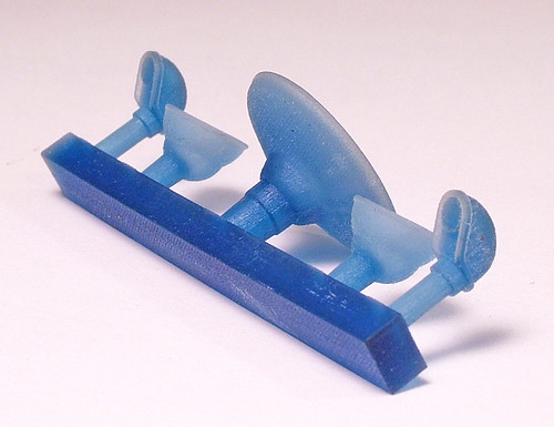

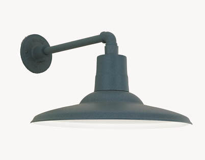

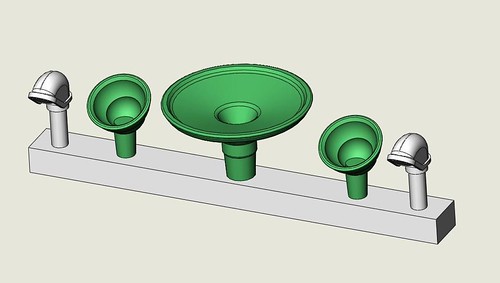

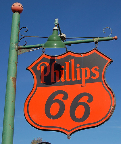

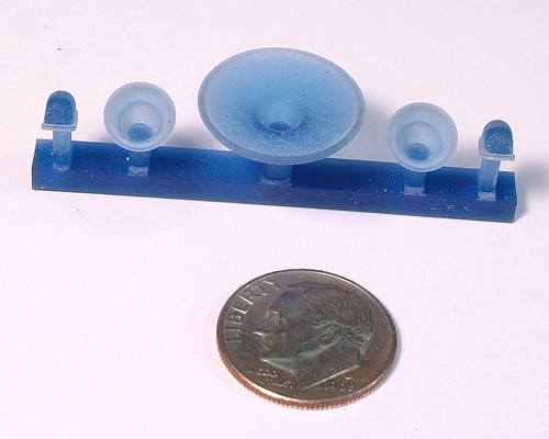

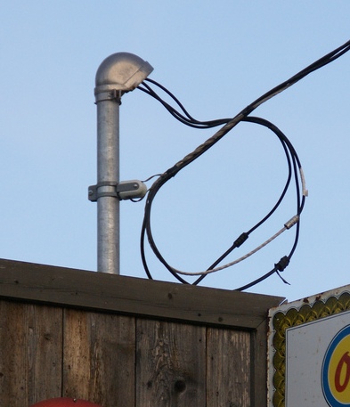

I haven't had much modeling time, so I decided to have someone else do it for me. Here are some detail parts I had made at Print a Part. I created the 3D solid models in Solidworks, and sent an STL file to P-A-P. There is a 16" light shade, two 7" angled sign light shades and two weatherheads for an electrical service mast. I just got them in and started some sanding tests. The material sands easily. The layer lines remove quickly, but due to the translucency, it is hard to see when they are smooth. This looks like an ideal application for Mr. Surfacer. I'll need to get a hold of some.
These took about two hours to research and create.  I sent the file in on Wed. and got the parts the next Monday using the least expensive path (overnite service can be had for a price) I plan to try some other items. I should also be able to combine more things onto a common sprue for better value. I think they will work out well and give me some unique purchased detail parts for my dio. I'll give an update when I get further along.
Shade
Weatherhead
Sign lights
