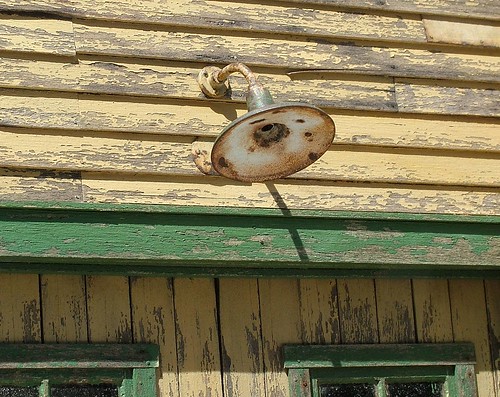

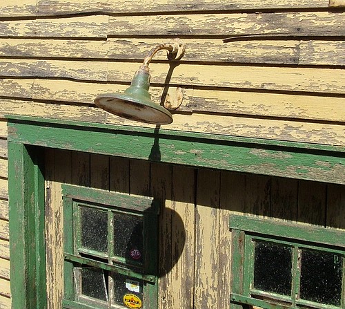

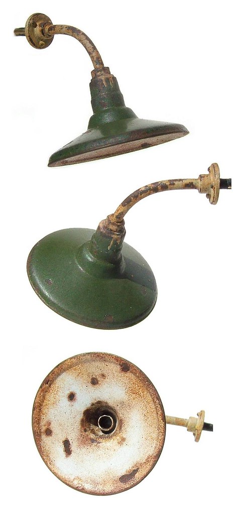

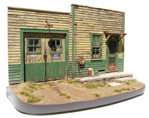

I was able to get my first Rapid Prototype part painted and installed. I first added a socket from brass tubing. After careful sanding, I primed the shade with flat black spray. When dry, I gave it a coat of hairspray followed by flat white spray on the bottom side, and Model Masters medium green on the top. I chipped it with a damp toothpick trying to copy the type of chips seen on porcelain shades. Then I carefully color sanded the surfaces as smooth as I could get (after overnight drying).
The bracket is bent brass wire, a 000-90 nut and washer to "fasten" the shade, and a wall mount turned from styrene with Tichy rivets for screw heads. This was sprayed with flat black, then hairspray followed by the Polly Scale cream. Then chipping with a damp stiff brush, followed by assembly to the shade.
Final weathering was with gwosh applied with a sponge, brush and damp toothpick, and Bragdon powders. I only lightly dusted the green with tan powder, since the porcelain stays glossy even when quite old. Some of my reference pics came from Flickr and several from E-bay, where I searched for barn lights and found many helpful close-ups of old shades for sale. I need to re-whiten my rusty socket, but otherwise it's done and installed (I am still debating turning another bulb).

Chuck,  I really like the finish on the light shade very realistic ;) adding a bulb would be the finishing touch.   Craig
Chuck, really neat finish just fits so well with all the rest, think you could say it was a very successful experiment..
Suggest that as you have already done one bulb you should really try to challenge yourself a bit more ;D how about a broken bulb ........ oh of course you need to show the filament  ;)
Very nice.  This kind of photorealistic modelling forces us to pay attention to the lowliest of features, like the lamp shade and its hardware, litter, smudges of oily hands on the garage door, all the things people overlook as they go about their business in 1/1 reality.  Somehow the mundane becomes fascinating in miniature and every little component complements each other to create believability in the finished work.  Very, very nice.
Ho-hum. About average for you, Chuck. I don't see what all the fuss is about. You can do this stuff in your sleep. Nevertheless I wouldn't mind publishing 20 pages about the diorama. -- Russ
Beautiful result, and great attention to detail, as always. I really like it. Also like the blanked-off junction box below the current light loc.
That is ridiculous! Unbelievable, great job!
