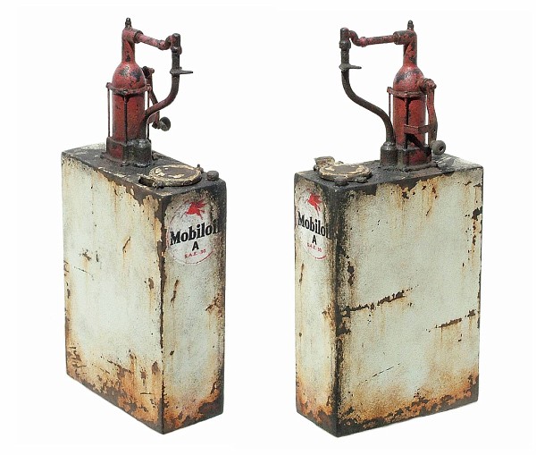

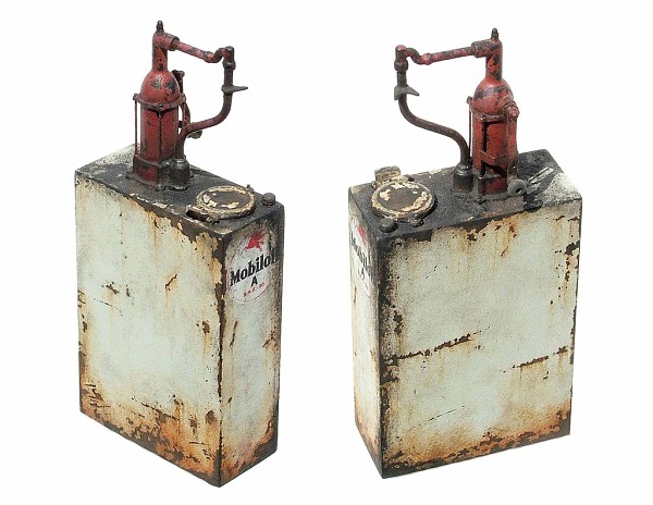

I finally finished the tank for the oil dispenser/lubester/highboy. I mounted the fill hatch, and added a hinge stop, hinge plates a dipstick knob. And thanks to Craig's suggestion, my garage now has brand affiliation.
Finishing steps for the tank:
Testor's flat black primer
Coat of Treseme Tres 2 extra hold aerosol.
Coat of Dullcoat sealer
Polly Scale white mix airbrushed on
Quick dry with hair dryer-created a "micro crackle" effect.
Chip with damp toothpick, short stiff brush dipped in water
Apply decal
Gwosh rust and black applied with cosmetic sponge-seal w Dullcote
Gwosh rust streaking with small brush/wet toothpick-seal w Dullcoat
Apply pigment powders to exposed chips
Add oil with gwosh and pigment powders for texture.
Slight touch of thinned Floquil High Gloss on oil.
Decal:
I found a lubester decal image on the web, and modified it a bit in Photoshop. I imported several copies in Word and made them an appropriate size. I printed them on Testor's white decal sheet for ink jet printers and when dry, I sealed them with the Testor's decal seal spray. Cut out and applied as normal. I found the decal film a bit thick and rubbery.  The image around the edges deteriorated some, but it was OK for this. I plan to try some different paper next time (hopefully by a different mfg.)
For reference, this is 2.125" high.

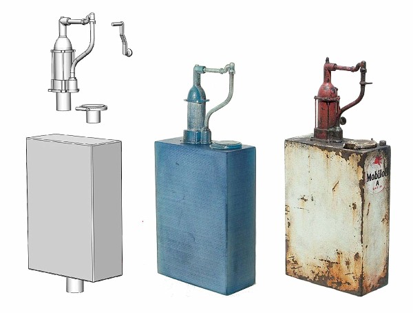

I'm really pleased with the results of the 3D printed parts so far.
Thanks Marty, good idea!
Well........just kidding!
Looks great, neat to see the composite images.
Any way to put the computer drawing next to the raw part & finished one?
Would be kinda cool to see the drawing evolve to the model.
Great SBS too.
 That blue 3D model looks very good next to the real one.  ;D ;D ;D
But why so many photo's of the real one ??
