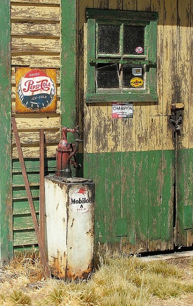

Thanks all! This was a funner piece of the project. I love that hairspray method!
Hmm, dents, I didn't come across any noticeable dents in my prototype searches-I think these were pretty heavy wall tanks. Of course now I will go back and see nothing but dents! I will make up for it on the gas pump though... ;D
Chester, this was the first time I tried homemade decals. I take it rubbery film is normal? At first I tried to chip the edges, but it just pulled like a vinyl decal would. Then it wouldn't go back to flat, so I had to do another one. Once I rolled the water out from underneath it seemed OK. I need to do more playing around.
What about "air erasing" the edges of the decal before applying (or may be after)?
I think Marc did this didn't he?.........
On large scale models each piece becomes a model in and of itself.
I did try Marc's idea...it faded nicely, but I was looking for chipped edges. A Microscale decal does it nicely, but not this stuff. May try pre cutting chipped edges before applying.

Chuck,     The sign on the lubester if your going to do another one and think the decal was to thick or hard to work with... you could make the sign as a small porcelain one that would be attached on with 2 screw's...which you could make out of thin styrene.  This would be correct as Mobil did have these. ...  And if you really want to go the extra mile use PAP and do another lid that has a Gargoyle logo.... with the weight of the oil Cast in the lid ;D        Craig
Thanks Marcel and Franck! Thanks Craig for the additional info. I did see some lids with cast in lettering...maybe if I do one in 1/12th scale!
