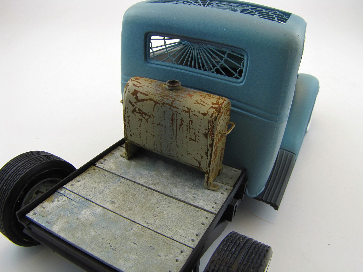

Oh, one more thing.  Those of you who already have a samply you might be surprised when you open the bottle and find that the paint is really goopy, not syruppy like normal paint.
You can thin this paint down with water.  When you apply it, make sure you apply it with a sponge so that it gives you volume and texture at the same time.
Give it a try.  I hope you get mind-blowing results the first time around.
Here's a picture of my second try . . .
Chuck, sorry about this, I didn't mean to commandeer your thread . . . .

Another thing, my friends, this crackle paint gives such fine small cracks, but if you put a little thickness in spots, the paint actually rises and looks like it's going to fleck off . . .
Again, I hope you all experiment with this exciting new find, and please please PLEASE post your results--that means you too Chuck D. and Marc R.

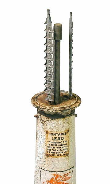

I got some coming Virgil! That looks promising, I have a project in mind already.
In other news, I installed the gallon indicators on the gas pump:
Each one was printed with a groove in the back of the vertical post. I glued in a .015 brass wire to keep them straight. Not a 100 percent protototype, but they wouldn't have worked otherwise. Ready for the cylinder and cap.

Beautiful, Chuck . . . you are getting closer to finishing it.
Crazy About Rust!
Chuck,
Looking so good.  Can't wait to see the rest of it finished.
You seem gradually to be getting the hang of this modeling stuff. -- ssuR
Chuck,   Im looking forward to see how your going to weather? or color? the glass cylinder ;) as you know most had a light blue tint or are you just going to leave it clear.         Craig
