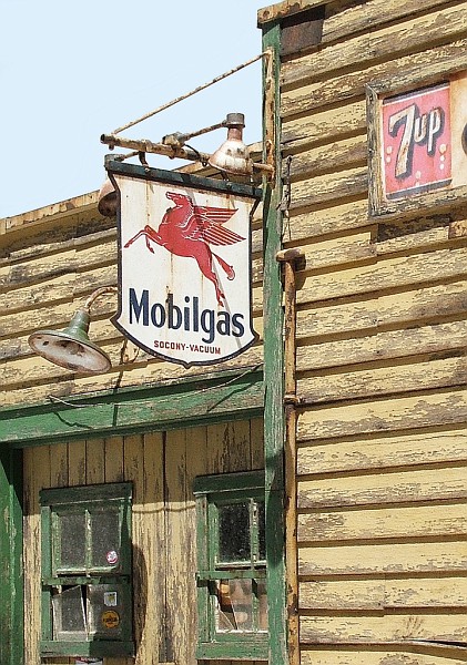

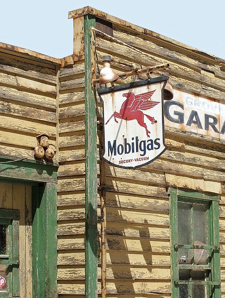

I finished the hanging Mobil sign this weekend.

The sign: I made the sign from .010 styrene sheet. I cut a square a bit larger than the artwork and sanded the pebbly side smooth. I cut out one of the decals from the sheet and used a sharp X-Acto to carefully cut around the print, right on the edge of the blue border. I cut through the film only and not through the sheet. I dipped the piece in water and slid it off onto the styrene, and carefully rolled the water out with a piece of plastic tube. When dry, I carefully cut the excess styrene and sanded up to the edges of the decal with sanding sticks. I used a round file on the radiused corners. I stopped with about .005-.010 to spare all around the sign. Then I applied the other side decal and carefully stretched and smoothed it to fit up to the edges of the shield shape. It took a few tries to get it done without trapping some goober under the decal, which usually ruined the thick "vinyl" film trying to lift it up. The final result was Dullcoted on both sides.
Finishing: I painted the white edges of the sign with thinned Polly Scale ATSF blue. I used gouache to add the rust and rust streaks to the various chips. The hanging bracket was made from styrene with hangers bent from brass shim stock and then I primered the assembly with flat black spray. I used hairspray and the blue paint to finish it off.

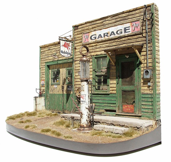

Other than some final touchups, that is it for this diorama. Finally.

I really, really love that you didn't add a car, bike or figure into the diorama. Them pump is the focal point, just the way it should be! But it doesn't dominate the scene, so the eye can wander around to discover all the other beautiful details.
