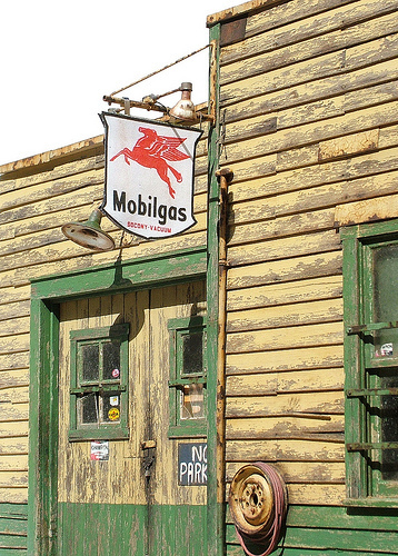

Thanks for the ideas! I haven't done a two-sided sign before, so there are new things to try. I have some .002 steel shim stock, but cutting the shape could get tricky as you say, Dallas. Last resort, an empty sign bracket and the footprints of a collector!
Chicken!
Enough about how tricky it is to cut out a shield shape ... now "man up" and do the flying horsey by itself!
Which, actually, could be a lot easier than doing a two-sided sign with printed lettering.  Here's my horse-brained logic on that:  print the logo to desired size ... one seller says 30 x 16.5" actual ... paste that to .005" styrene.  Cut out the shape ... which is no big deal in styrene ... paint it red ... scratch off the red where the white appears a la making an etching ... repeat on the other side.   Once the shape is cut out, the "alignment" issue is gone ... it's just facing the other way on the other side.  Since there's no layering of decals, etc, then some of the issues of thickness are diminished.  And, the solo horsey is a really cool and subtle detail.  (C'mon, man, you made scale wire nuts for crying out loud!)  ;D
PS -- Did you know they made little Pegasus charm bracelet doo-hickeys ... that measure about 1-1/4" across?   Hmm ... (search "Mobilgas pegasus charm" ... plenty of results)
Do know that Sinclair used plenty of 3-D dinosaur promos ... don't know if Mobil ever hung 3-D signs ... but interesting (and damned easy) possibility

Thanks for the ideas Dallas! Mobil had a bunch of interesting signs and I doubt I have seen but a fraction of them.
This is the one I am looking to do:
Just a quick paper doll cutout to judge a good size. I haven't really applied myself too hard yet, if I can get my decals to apply OK then it should be easy. ::)
