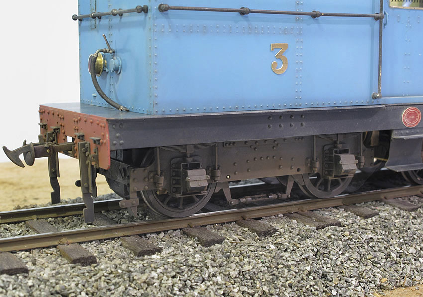

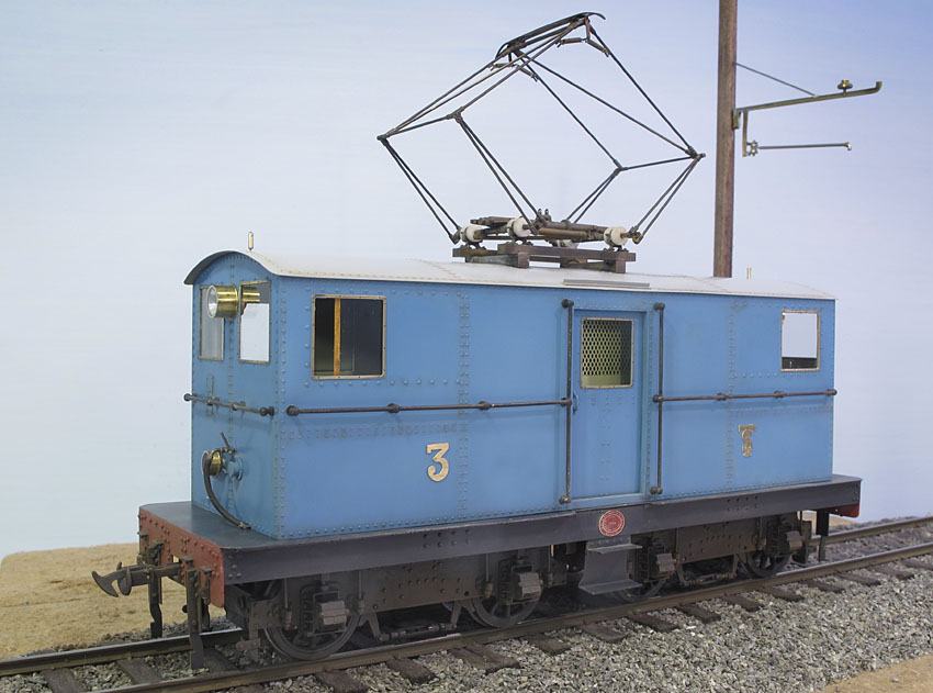

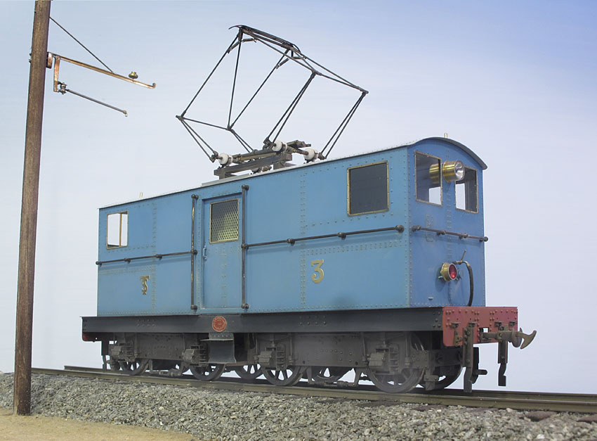

Its official: This is no longer a work in progress!
Yesterday I added the final details to the engine, the whistles.
So now I consider this model done.
I may add a little more weathering when I  am confident about my scenery colors. And who knows, may I will install a decoder some day. But for now, its *done*.
This must have been one the steepes learning curve I have ever travelled. When I started this project, I had zero metal working skills, I could hardly solder a feeder wire to a rail. My painting skills are still not that great, but for a first brass model it aint all that bad.
It took three generations of etchings to get it right. There are still some glitches, but I think it is virtually impossible to get a set of etchings with several hundred parts 100% correct.
The pantograph almost sank the project.  I do not looking forward to  make another one, but my next project have two of the darn things!
Thanks for all the encouragement,  the feedback I have gotten here really helped to keep me going!
Some snapshots until the company photographer gets the delivery photos done:
Bring on the ASEA-engine!

Thanks a lot for the kind words!
I have said it before, but it is the "peer review" you get on a forum like this that counts. Most people are clueless when it comes to scale modelling. And even if it is nice that friends and family are somewhat impressed, it really does not count for much.
And a quite unique thing with this board is that people actually dare to critisise each other.  I hope that this will continue, as there is always room for improvement. I certainly hope to improve on my painting and weathering skills, for instance.
On this model I chickened out on the weathering, the prototype engine was way more battered and dirty. But I did not trust my skills, and I would have hated screwing up so close to the finish line! So when my skills have improved, I will probably go back and weather it more. By then I may also have sorted out the colors I am going to use for my scenery. Not that I will have an layout anytime soon, but I have a couple of dioramas on the way.
