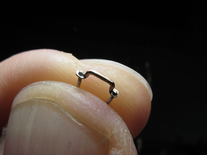

Handles for the sliding doors was made from 0,5mm brass wire and some brass rivets. I really enjoy the fact that the brass is soft enough to be pressed flat with a pair of pliers. That maks it possible to get that flat area I needed to drill holes for the mounting rivets.
The little bugger looks like this:
4 handles and a spare took most of a suprisingly enjoyable evening.
Amazing! Looks like something I would drop into oblivion.
Wow, that's tiny!
How do you drill such small holes in brass?
Quote from: Ray Dunakin on November 22, 2010, 11:15:06 AM
Wow, that's tiny!
I start by punching the spot to be drilled, or rather press an indent in the metal with a pencil scriber. This is done on a steel surface to avoid deformation of the thin metal. For drilling I use a pin-vise. The trick is to be patient and not apply to much pressure. I broke two drills just for this simple job...
Regards, Hawx.

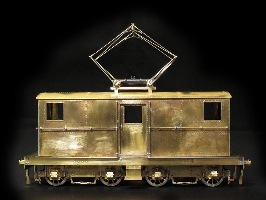

I sometimes loose track of what I have posted when and where on the great InterWeb, but here is the latest image of the engine anyway:
Hope to show some more progress soon!

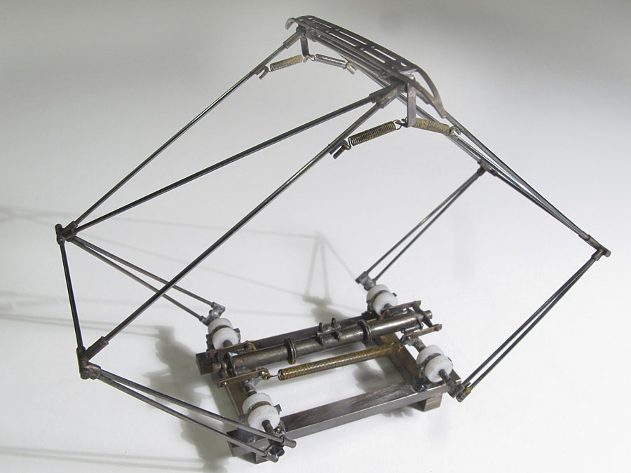

But here is the latest progress shot. The finished pantograph:
That's some incredible miniature engineering!

It is a 0m model. Wich means it is built to 1/45 scale and 22,2 mm gauge.
Painting is next up, and I am in the process of testing different primers and paints. Scary stuff on so many levels...
