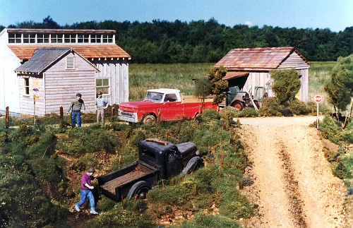

After shooting the Lumber Buggy in the lumber yard, I dug out a couple other
examples of setting up outdoor shots against a natural backdrop.

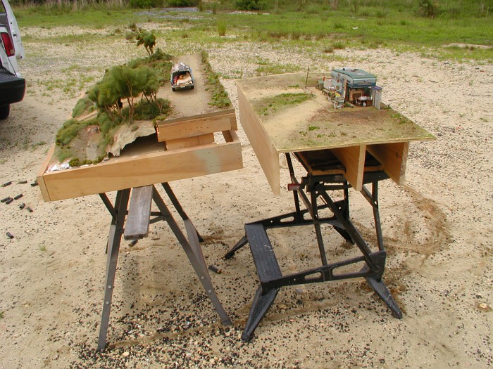

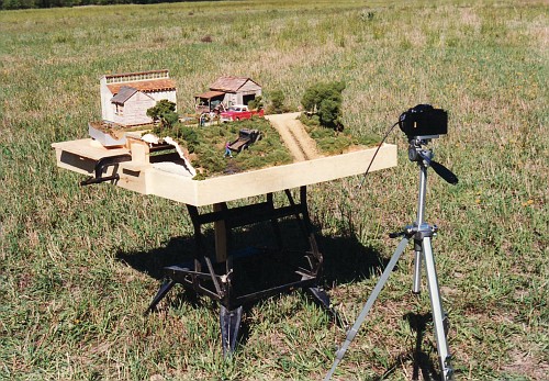

This one consists of two structures set on platforms behind a separate scenic
diorama with a steep front slope for photography:
Here's the result (this is a scanned print, so it might not be too sharp):

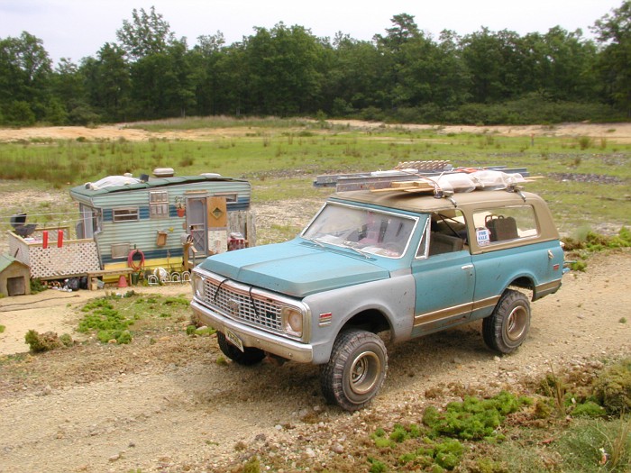

Here's another one that was for a model car kit box.  The set-up:
The shot:
Neither of these are as "subject-specific" as the lumber yard shots, but I thought you guys
might like to see them.
It is great how you take several seperate dios and make it all come together...and no photo shop, just good old fashioned eye foolery. Says a lot about your modelling too!

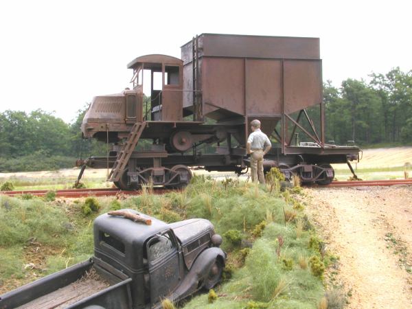

It seems to me that the key to make this kind of set up  really work is to make sure  that the "real" stuff in the background is  as much in focus as the models in the foreground.
This might sound a bit counter-intuitive, but  hear me out.
Most of the time we shoot model pictures outdoors we do it  in bright sunshine.
And like in Kens pictures we often  shoot from distances of about 40 to 60 scale feet.
In bright sunshine we often shoot at f 22 or even smaller apertures. With such small apertures and focus set to 20 -40  *real* feet, depth of field will in most instances reach to infinity when we use "normal" or wide-angle lenses.
Alas, the backgrounds should be as sharp as our models.
I think that Kens favourite pictre of the lumber-loader Ken illustrates this point.

Craig, that truck has found its way into several different scenes.
So has that sloped, foreground diorama:

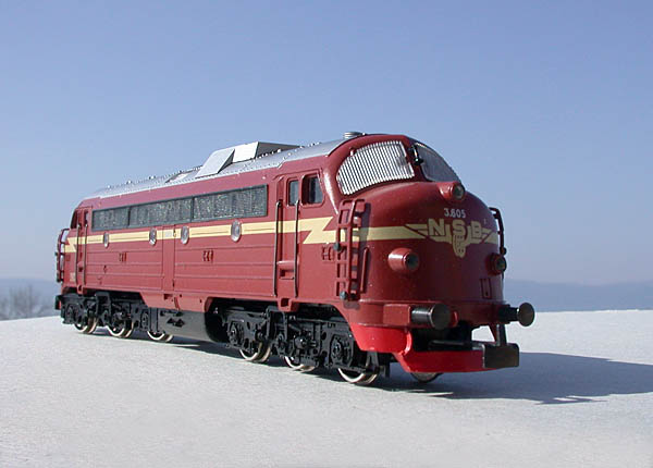

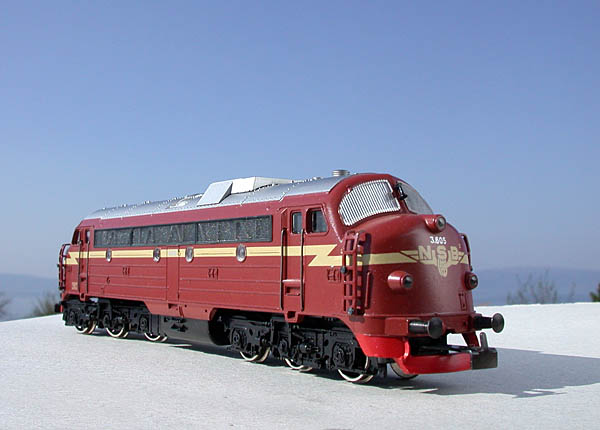

Good point. Here are three images that might illustrate your point:
No reflector, just sunlight.
With metallic foil reflector
Sunlight filtered through matte drafting paper, no reflector

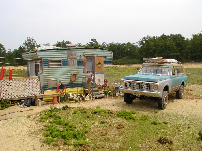

Great shots Ken... thanks for sharing your setup. I particularly like the shot of the 4x4 in the foreground with the "RV" in the background. I'd love to see more shots of the RV, looks like some of my neighbours!

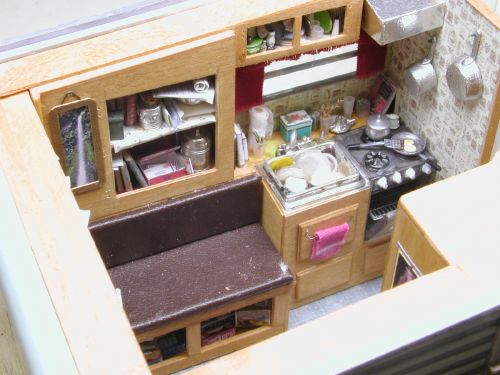

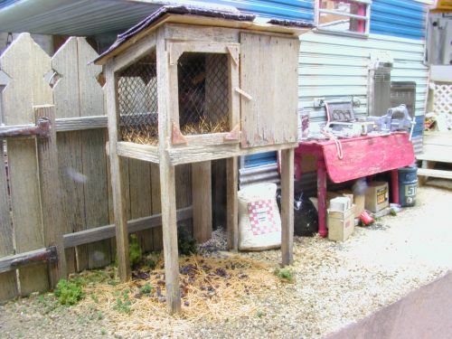

Paul, I never did take any overall shots of the finished camper by itself, but here are a couple of detail shots:
Here's a link to some others:
http://public.fotki.com/khamilton/models/open_road_camper/
Thanks...........
I love it... those are fantastic Ken. Took me a while to find the empty beer cans and cigarette packs, but they're there. I like the issues of Hot Rod scattered around, the freshly painted valve covers, Purina Chow patch on the patio door, the newspapers being bundled for recycling, the girlie calendar, the duct tape repairs... it's all wonderfully evocative without being a caricature... well done.
