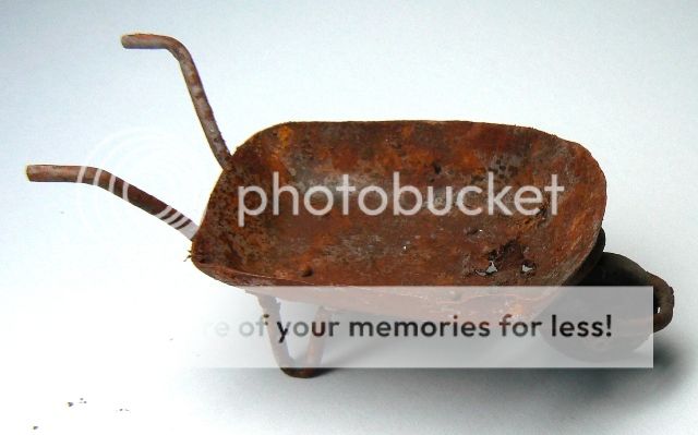

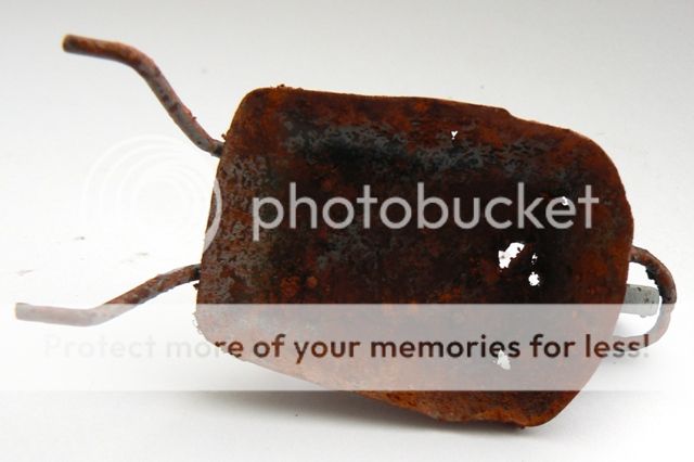

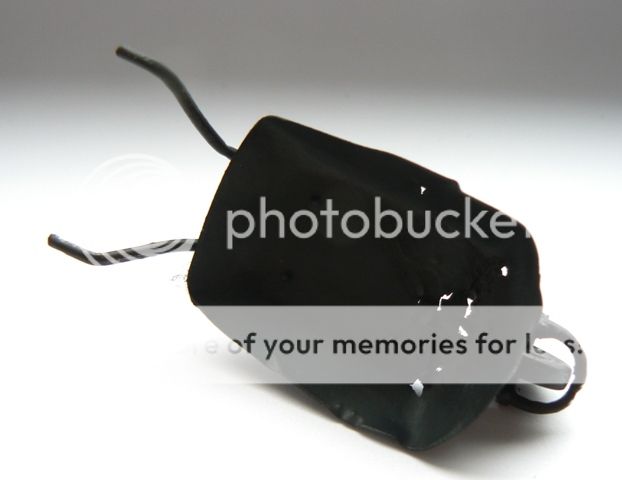

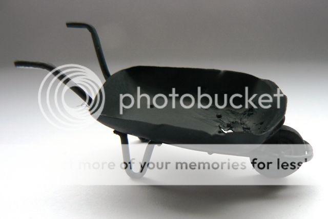

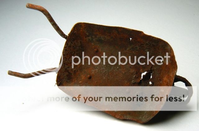

I'm starting to build some bits & pieces for an abandoned/ drained canal, amongst the list of things I wanted to include was an abandoned old rusty wheelbarrow. the basic shape of the barrow was pull moulded over a carved shape and the frame made from 1.5mm aluminium tube, and the wheel lifted from (I think a 1/48 ME109)
I'm trying to get a better understanding of pigments so this was a useful piece to learn a bit more about them . After priming with matt black I then sponged on a lot of rust shades then sprayed with hair spray, when wet sprinkled on some salt. When that was dry it was given a light spray of grey paint and then the salt was brushed off and some more of the grey. paint scrubbed off.
At this stage started to apply various shades of rust pigments from MIG productions, I deliberately tried to use a mix of dry and wet pigments to build some texture and that scale effect you get on old rusty metal.
As you can see this experiment didn't work as well as I had imagined it in my mind .......... however played around with a bit more of the pigment fixer  and its now got a bit closer
Final shot is where I have got to now , this is the angle that the finished piece will be displayed so spending most of my time working  on this angle .... have now added a bit of MIG Factory Grey pigment as this seems a good match to old dried cement.
So folks sharpen your pencils and let me have your views.
Quitcher bellyachin'. Looks very, very good. -- Russ
Gordon --
Neatly done!  Remove those little lint fuzzies at the back corner (front left on screen) and you're there.
Dallas,
thats one of life's many mysteries to me ....... you check the model, you check the initial photo, then you post them ......... and what do know the little fuzzies are back.
Their gone NOW!
Russ, sorry didn't mean to sound as if I was moaning ::)
Craig_H
#236
John,  Your right... thong bikini's..... you forgot paper modeling....and then the Booze :)       The wheelbarrow looks good especially making it from scratch.....and the coloring turned out good in the end.    Craig
JohnP
G, that wheel barrow would be a better model if it was done in cardstock or paper... ;)
Actually I like the finish. Set in a scene with other objects of similar quality it would be a nice eye highlight, something to rest the vision on for a moment while scanning the view. The dents and rust and holes make one imagine the hard service it saw, the calloused hands upon the handles and the general age of the thing. Very nice, and well worth the effort.

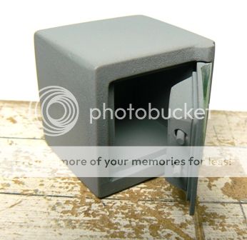

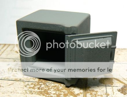

Here are 2 of the most exciting pictures you will ever see, a small (1"x1"x1")grey box!
This came about following my last conversation with Andi Little on a project we are both involved in , were discussing likely rubbish that would be dumped in the drained canal, no offence but I was trying to avoid the ubiquitous 45 gallon beat-up rusty oil drum and Andi suggested an old safe ......... now whither he meant for the Top or Bottom Yard is still open for debate
Just need to finish of front with some bits & pieces from one of Lasercut frets for the combination dial, handle etc. and then the fun will start ... pictures on the web show most of these old safes had some form of gold pin-striping on the front, oh and add some wheels, again pictures show most had small cast iron wheels on the bottom.
#239
Gordon --
a) Bravo for choosing "alternative" junk item(s)!
b) That's a rather neat little assembly of styrene bits & pieces you've got there ... looking real good ... and appears to be a very good job of fabricating/setting the hinge pins to allow that door to swing properly.
c)  I guess Houdini got out!  ;)
