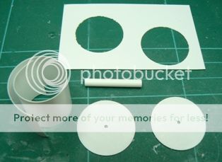

The wheels are just a standard build , 2 discs cut out plastic card , axle tube and the outer skin made by pre-formed card.

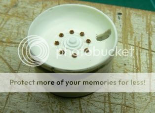

The only thing I would mention here is that you should never leave a completely enclosed space when using plastic card and solvent glues, either leave a gap somewhere or drill a hole for ventilation as the vapours can continue to soften the plastic for a number of days in an enclosed space.

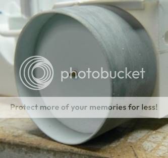

For this model model I wanted to form an inner radiused curve on the inside of the wheels so I insert the outer piece from the front of the wheel.

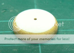

This is the male mould I used , made out of 2 discs of plastic card and soft balsa sheet. Sanded to profile and about 5 thou smaller than the outer radius of wheel  and then the balsa hardened off with superglue.

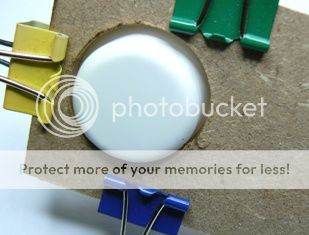

The female part of the mould was just a circular hole, plastic was then clamped over the hole , normally I heat this in an oven but for this small part I just carefully warmed it over the gas ring and then pushed male mould through hole.
Moulded plastic is then roughly trimmed ,slipped into wheel, glued and finally trimmed and finally sanded to shaped - then detail parts added
