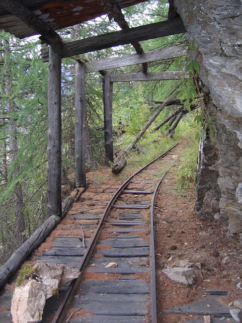

  Now tell the truth , have you giving us all of the photos you took of the mine or are you holding some back for your own use ? Can you give us a idea of what happens to the track either side of the snow shed ? It would be very interesting to know .

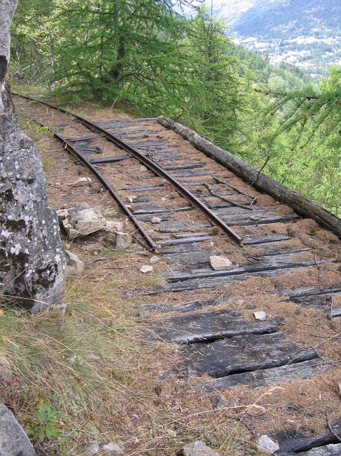

Those photos are fabulous!  (Nick, remember to keep lots of trees in front of the cliff obstructing much of the view of the track and trains)

Wow, that hillside (mining?) track is way too cool! Especially the roof to protect from falling rocks. Where is this track? Do you have more photos of it?
Hi Ray,
This track is in France, it's the coal mining line "Les Eduits', near Briançon...And yes I have more photos... ;D ;D ;D ;D

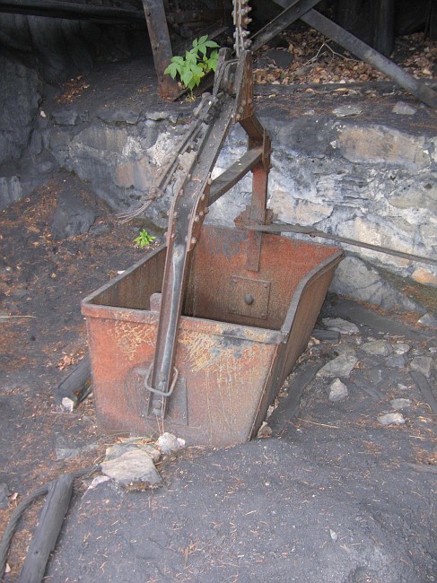

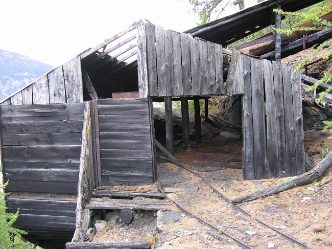

Keep posting the photos , Franck . The last one is new to me . Is it an ore bin ?
  Here is another one I found last night . However , I can't be certain that it is part of the same line .
Hi Nick, no I haven't giving us all the photos. These photos were taken by my friend Olivier Joseph (all right reserved), a few years ago... That's why I do not post all the photos here...and don't forget, it's Marc's Subject!
After the snow shed it's the ore tram...

Quote from: shropshire lad on March 29, 2011, 12:12:41 PM
Yes Nick, it's the same line! Where did you found it? On the Saint Chaffrey website?
It was the pit head zone...
http://www.maplandia.com/france/provence-alpes-cote-dazur/hautes-alpes/briancon/les-eduits/

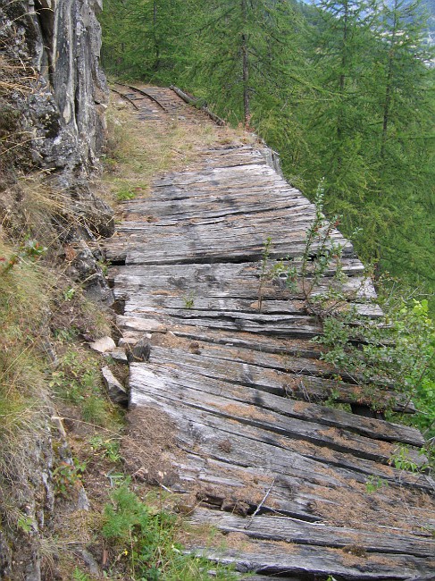

Quote from: Frederic Testard on March 28, 2011, 12:36:06 PM
Great track work, indeed. It's high time you start the project, and maybe publish more pictures for others to dream, or perhaps to build.
In any case, looking at the track on these pictures, there doesn't seem to be tons of spikes, right?
Hi Fred,
I started to work on this project, there are 3 years ago, by searching photos and documents... I must now begin to scratchbuild gas locos, track, rolling stock...
And yes, there is no spikes on this part of the track, but it's a little part of this line, and track is laid for the rest on...wood ties with tons of spikes  ;D ;D ;D ;D :D :D
Franck

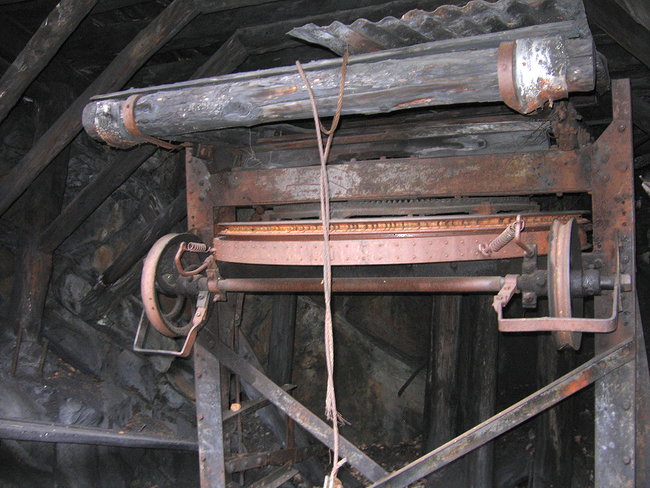

Franck ,
  Yes , that photo was on the Saint-Chaffrey website , along with this one .
   I am now slowly building a picture in my mind of how the line used to look like .Thank you for the extra photos .

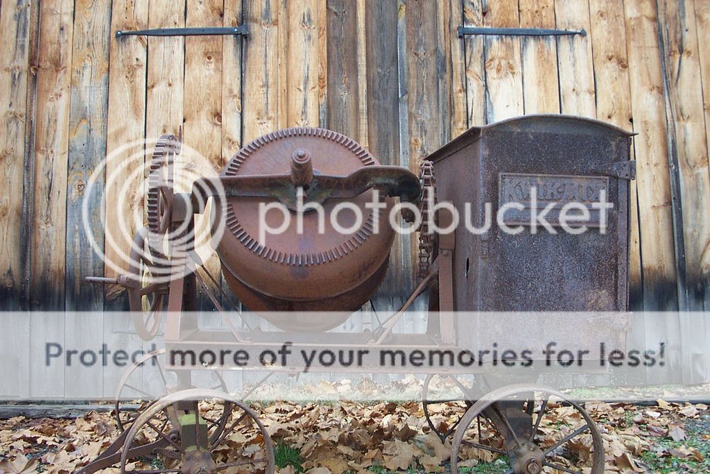

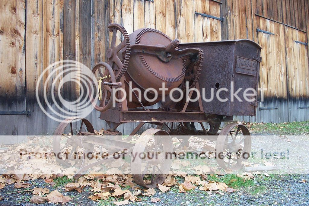

Early on in this thread Marc mentioned "cement mixers" and I posted a few photos of one I intended to model.
Whilst doing some more research on this subject came across these photos last week

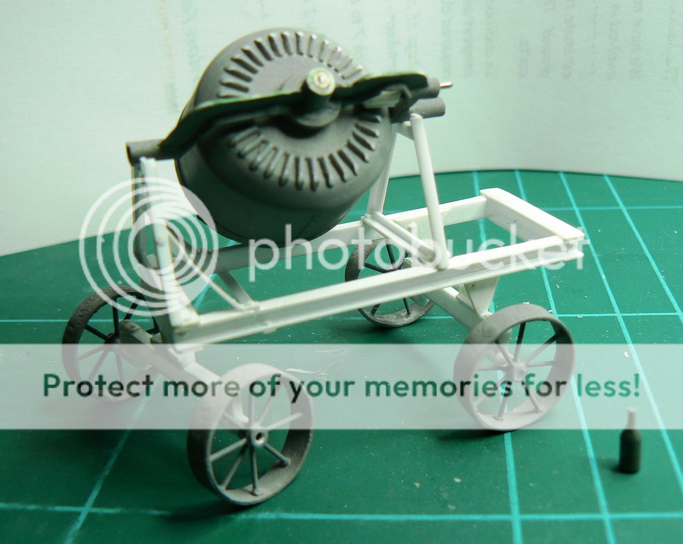

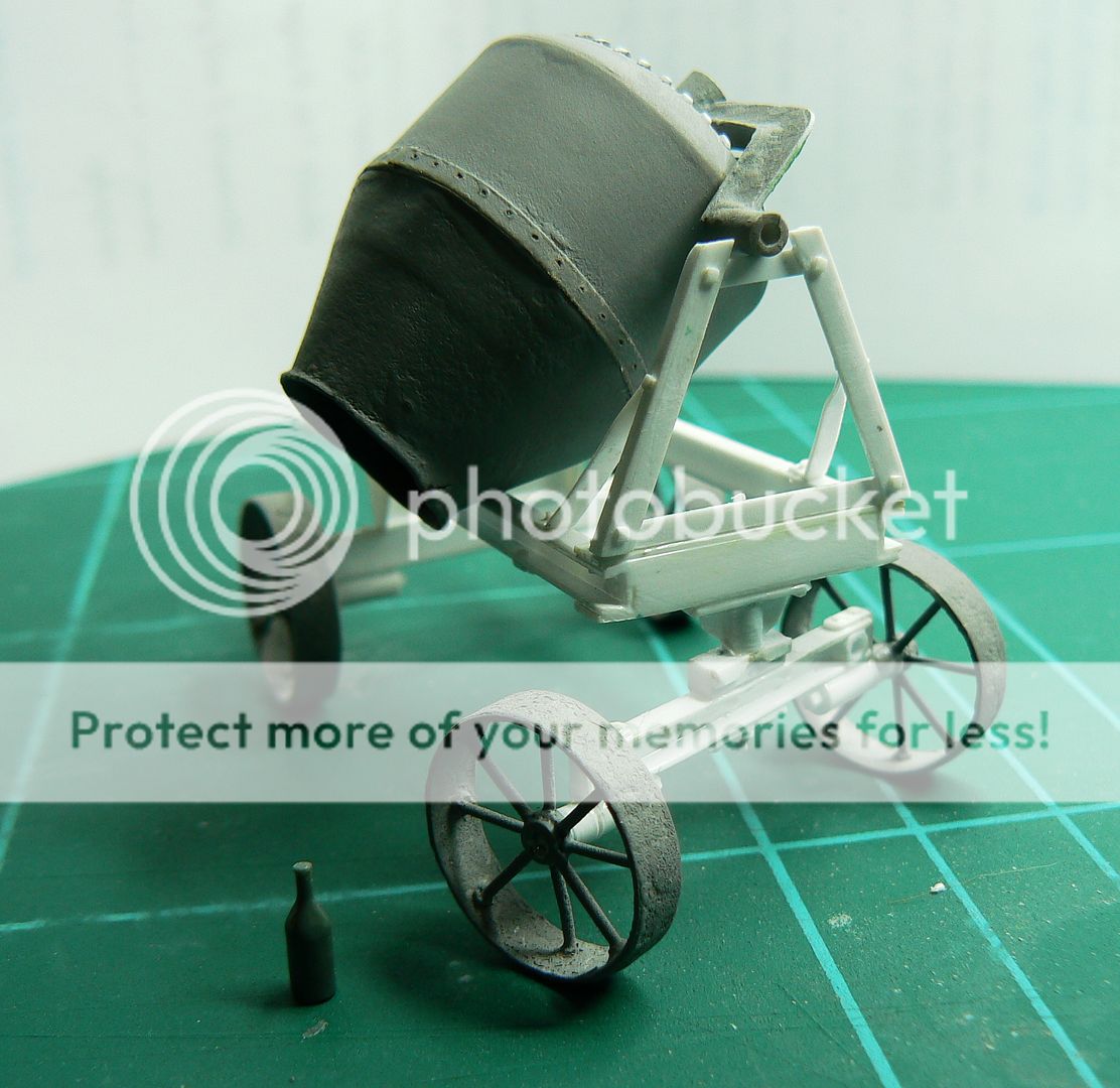

There was something about this one which really appealed, although I think the overall rust finish is beyond my painting abilities it is interesting to see how the different planes and different steel/iron have rusted in different ways and colours. Decided that I would have a go at in 1/24 to go with my road roller. Having no lathe could not go down the route Marc has started on with his, so went back to draftsman days and thought I would play around with producing the mixing drum out of paper. Produced a few trial pieces and then made the mistake of getting involved with Dallas on the subject of scale rulers. with a 1/35 rule in my hand I noticed that one of my trial pieces was exactly right for a 1/35 scale model so that is what I have ended up modelling ( as well as a 1/24 version!)
The beer bottle is the only 1/35 item I have to give some comparison shots, and the photos are quick & dirty ones at the bench.
Other than some Tamiya tanks I made years ago this is a new scale to me and I have struggled a bit to get things like the steel C frames to proportionally right, have scratched them from 20 thou strip but have thinned all the edges - would have been better starting with 10 thou but didn't have any in stock. The drum is made from paper and balsa, wheels from paper and rod, the rest from plastic strip.
Now that I am ending up with my only 1/35 scale model going to have to find a use for it, thinking of it abandoned at the the side of a building (maybe a Nissan Hut) bit of grass, bit more junk etc.
That is one sweet little model. A great scene addition. Looks like I may have to copy it. Thanks for posting this.
FWIW, I didn't build my drum on a lathe, (the lathe and me don't get along) I cut up the mixers from some matchbox type cement trucks. ;D
