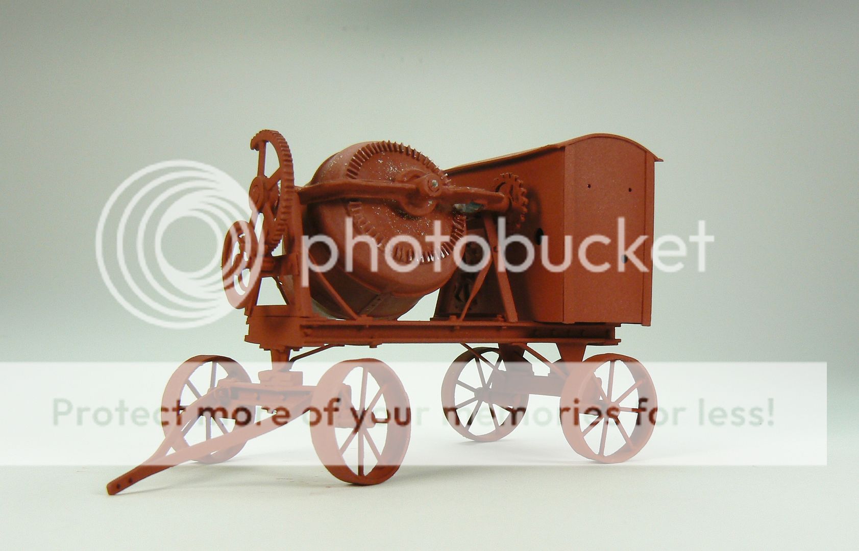

Agree with the others ... and wonder if you're just staring too intently at this point ... or maybe it's that scary red primer that's throwing off the perception.
Did a b&w comparison of your prototype and model:
-- If you're trying to build an EXACT model, then there are a few minor things to change
-- If you're trying to capture the ESSENCE of the prototype ... you nailed it!

Thanks for the replies, and the sound advice of "leave it along"
However I never have been very good at taking advice, and by the time most of you had typed it I had already taken apart the large cog and spent an enjoyable hour or so gluing 10 x 20 thou strips on edge around to form the teeth, and thinning the whole thing down a bit  ...... and I am a lot happier now with it. Have also stripped off the gear teeth on the drum and will try a better effort on it tonight - photos will follow when it is all back together.

Rain has curtailed work so finished off corrections
if nothing else I am happier now ....... off to paint shop

Sure!  First photo below is "before & after" for the model ... then a comparison of the prototype with the revised model.  Glad you were able to get in there, as the changes are extremely effective.  Now, of course, you'll want to study the LIGHTING on that prototype so you can get some nice shading and highlighting on your model!  ;)
Gordon, the new one is indeed better even if the first one was already excellent.
Sometimes you'll want to enter into this extra-work, others not. It's surely very personnal, and I think 50 people could have told you #1 was good without deterring you from making #2.

I think the changes are a vast improvement (refinement) in the finished model.
Reading through the comments here, I have to add that, there is only one person that
has to be "satisfied" with the end result.

Looks much better with the fine tooth gears.
