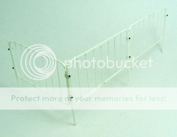

For an on-going project I needed to make some 1980's type metal fence panels.
These are 1/35 scale, each panel is approx 50 x 25 mm.
Constructed out of plastic rod

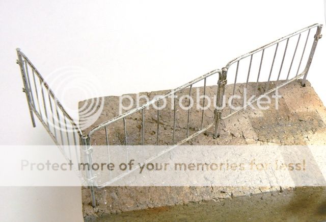

the now standard mix of various rust colours
followed by one fine coat of hairspray, then various over sprays of different off whites. Left to dry for about 30 minutes and then chipped with a fine brush and water

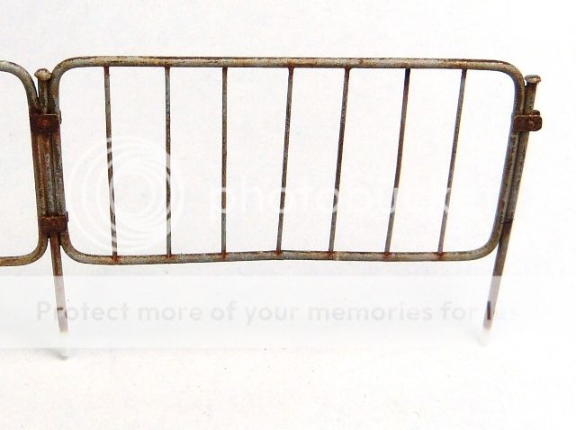

A well thinned coat of dark rust oil over whole panel, left to dry  for a few minutes and then cleaned off enough to leave a "rust stain". Specific areas then then touched in with the dark rust followed with some slight touches of lighter rust tones

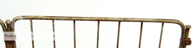

Finally a close up of the top rail , each panel is being done separately as I need to be able to find out if I can replicate the finish
Excellent little model/detail Gordon.
Great process too - looks do-able even for a lacksadaisical little so-and-so like myself.
Cool!
Splendid little detail piece, and nice paint an rust. Perfect.
Been wanting to build a sim barricade fora while  :)

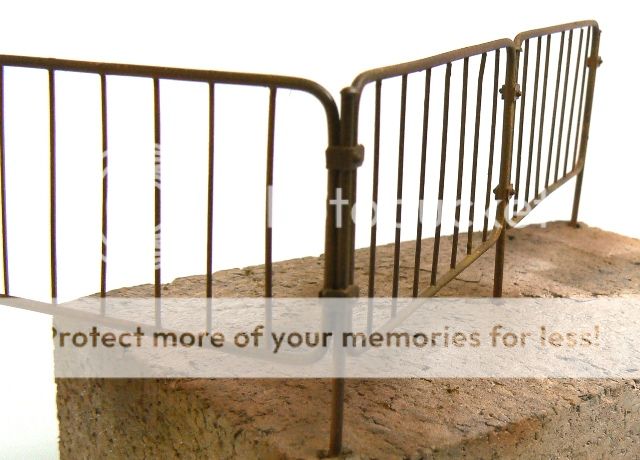

... is this styrene ...  ??? ... and how do you treat/bend it, that it remains in (new) shape ... ?
BTW: Panels really look the part!

Yes it's styrene, will post some details later
