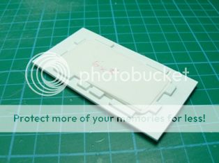

Anyway, I promised an SBS .............. so here it is in all its complexity !
Various bits of plastic sheet stuck together and the internal shape of a 6 x 3 panel out-lined with alignment tabs to hold the styrene rod.
I have to admit this was the second one I made, on the first I had the proportions all wrong and the corner curves were miles out ......... the amended one has the corners with 2mm radius's
For the main frame tubing I used Evergreen 3/64" rod (1.2 m) which is just slightly too large for prototypical 1.5" tube used in real life.
Because of the tight radius, before bending rod around the mould I let it sit in boiling water for a couple of minutes just to soften it and then bent it around, leaving the joint overlapping on the bottom.
The overlap was cut of through both bits of rod to get a tight joint and then the mould was placed in boiling water , let it sit in it for a couple of minutes to let the rod have a chance to absorb the heat.
Then taken out and left to cool down for 3 or 4 minutes then rod removed from the mould.
After that it was just a case of gluing ends together, marking of and drilling holes through the bottom of the main tube for the verticals (20 thou rod) ........ then laying the piece over a drawing with a number of parallel lines at the right spacing ... I just butt jointed the verticals to the underneath of the top tube.
(as an aside, during this I discovered that Evergreen appear to have a +/- of about 4 thou tolerance on their rod ... not that much on the larger dia  rod but it shows up on this sort of work on 20 thou rod. My stocks varied between 23 and 17 thou)

Thanks for posting the SBS.
Very clever way to reproduce them.

So the mold/form doesn't deform or warp after being heated in the boiling water?
Hi Marc,
No mould is fine as long as you make it sturdy enough .......... Think I glued 3 pieces of 40 thou card together and I also added a couple of lengths of 3mm square rod as well to the back
Typical old fashioned over engineering on my part  ::)
