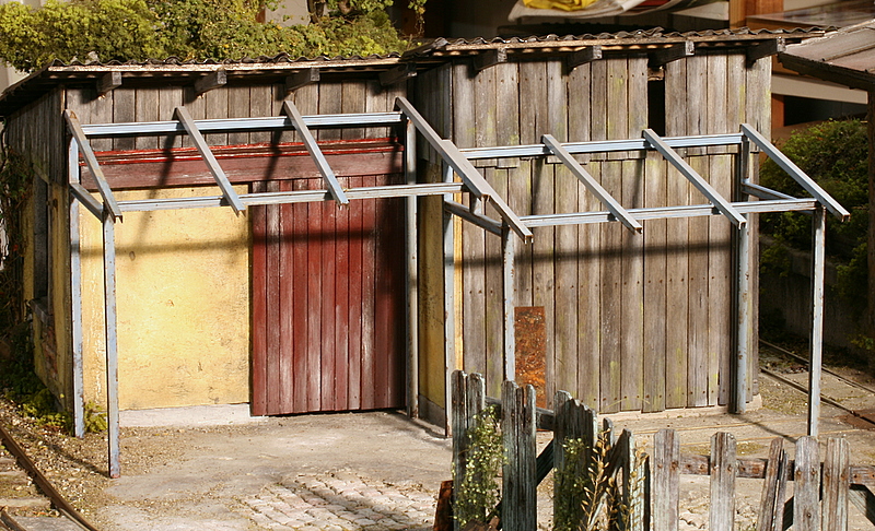

I think this is the a wood color direction that you should probably be shooting for, for your structure. This is One of Marcels projects, and he does his coloring using Vallejo acrylics and water colors.....I'll try to find the exact formulation for these boards.
#6
Apparently it is simply an oak stain, and then he uses water based (water color and guache?) for aging (getting the grey shades. There is an SBS with photos here:
http://www.modellboard.net/index.php?topic=22388.0
NOTE: The Oak stain is awaterbased product (being that it is the EU), and it does not have an included sealer like minwax or many of the other stains found on the market here in the box stores and DIY stores.
Too heavily weathered for what you need, but check out the textures and coloring on this wood/structure:
