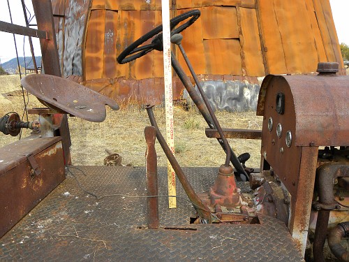

Gordon, the ratchet-thingie on the side is my version of the motor's clutch handle, which I thought was
more interesting looking than a pedal.  The handle was made around a section of a watch gear using bits
of styrene & brass strip stock and wire.  The handle in the middle (the one with the button on top) is a
flattened piece of stretched sprue, bend at the top end, with a small, flat sanded plastic plate on top.
The button is a flattened Tichy rivet.  The entire handle is modeled after the real one in the lumber stacker
photos that Rick sent:
Again, MANY big thanks to Rick for providing such amazing detail photos.....

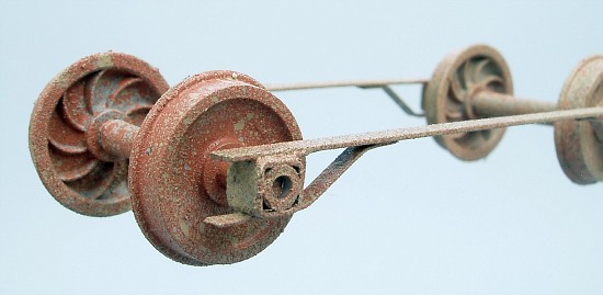

For a change of pace this weekend, I built a lumber cart.  The frame is brass built around Grandt
Line 1/48 wheels. The finishing sequence is (1) automotive primer, (2) Rustoleum "Terra Cotta" for texture;
Quick, successive, light squirts of Floquil Rail Brown and Instant Weathering, following by a short
spritze of Primer from about 18":

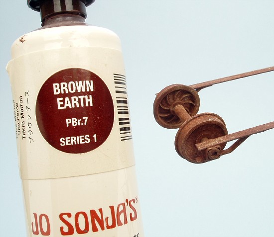

That was followed by thin washes of Earth Brown to tie everything together:

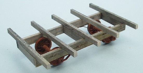

While that was drying, I built the wood frame which, when finished, was glued to the truck:

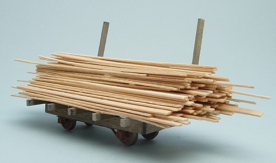

The wood load finished the job:
