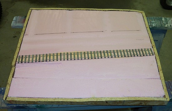

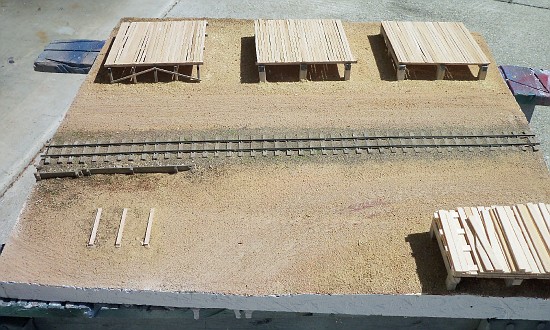

Here's a quick look at the Base-In-Progress:
The three posts on the ground are going to be holding up a small shed.  The frames in the
back are permanently attached - the lumber piles will be removable.

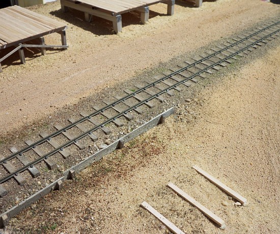

Fer a car guy ya sure do good railroad. -- Russ
Agreed... very nice groundwork and trackwork Ken or shall we call it scale terraforming... ;) I'm curious to know what are you using for a structural base and contouring before adding your dirt? The subtlety in grade change is very convincing.
Thanks, guys.....
Paul, the base was made using rigid pink insulation that was rough-shaped with
a wire wheel in an electric drill, then smoothed out with coarse sandpaper.
The contours are subtle to keep the scene from being dead-flat and to give the edges
some visual interest.  After the foam was formed I traced the contours onto fiber board,
cut it out and glued the edges to the foam base.  To make sure the foam wouldn't separate
from the edge (..and fall out...) I drilled pilot holes in the fiber board and pushed 4" nails into
the foam.
See that separate foam strip in the front? That was an afterthought extension added to provide more room
for a little shed and another stack of lumber in the foreground, neither of which were originally planned.
The ties are hand-cut pine and the rail is Code 100.  The groundcover is fine, sifted sand attached
in the typical fashion, then sprayed with Rustoleum American Accents "Sandstone", a finely textured
spray that tied everything together.
There's not too much going scenery-wise in a lumber yard, so I wanted to keep it "simple-yet-hopefully-somewhat-interesting".
