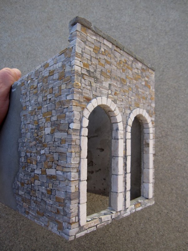

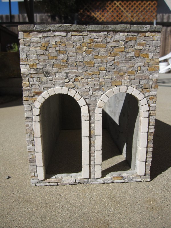

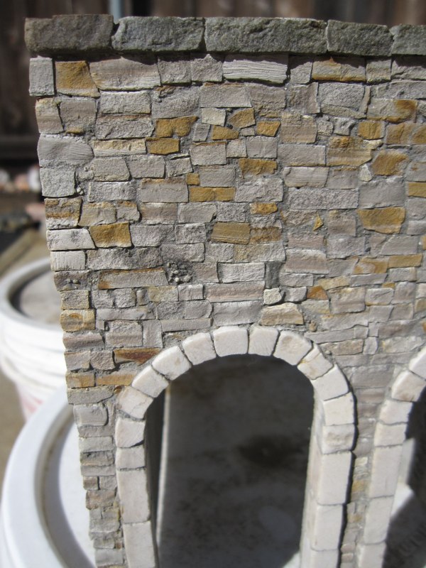

I finally fixed the gaps in the stone walls. I mixed a small quantity of mortar, added some "charcoal" pigment to darken it a little, and smeared onto the walls of the building by hand. When I was sure it had been pressed into all the gaps, I carefully rinsed off the excess while lightly rubbing it with my hand. In some areas I also used a soft paintbrush.
After the mortar had set, I scrubbed the walls with stiff brush under running water, to remove some of the residue. It still needs a little touch up here and there, but I think it looks a lot better now:
Looks like the morter didnt effect the stones at all. Glad you found a solution!
A considerable improvement. It looks good. -- Russ

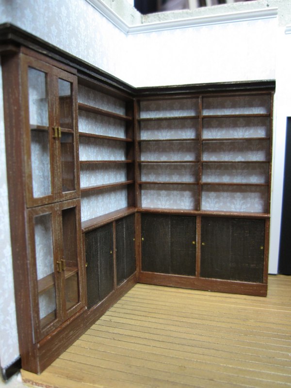

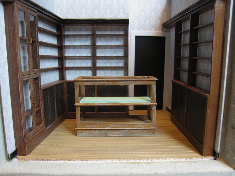

I started working on the furnishings for the storefront interior. I built some cabinets with shelves out of styrene. These were "distressed" to look like they've been around a long time and have never been refinished. The design and "weathering" were inspired by photos from the J. A. Merriam Drug store in Colorado, which I got from a "No Frills" photo CD on ebay.
Using regular spray paints, I sprayed them with gray primer, then a mist of red-brown primer, and a little bit of light brown. Then I brushed on a reddish-brown mix of Apple Barrel flat acrylics. I used a dark brown mix for the trim. After this had dried, I brushed on a thin wash of artist's gloss medium, which really gives it a nice varnished look. When that had dried, I chipped and scraped away small bits of the surface paint. Then I went over it with a Scotch-Brite pad.
I still have to make the merchandise to fill the shelves. I also have to make some other furnishings, "weather" the interior, add signs and displays, and lights. The false doorway at the rear will have a curtain draped across it.

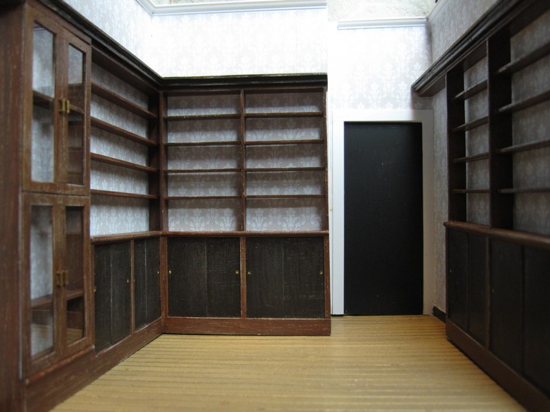

Here's a shot of the interior with the cabinets temporarily placed in position:
It would be very difficult to tell, from the photos alone, that the scale is smaller than 1:1. Very nice work. -- Russ

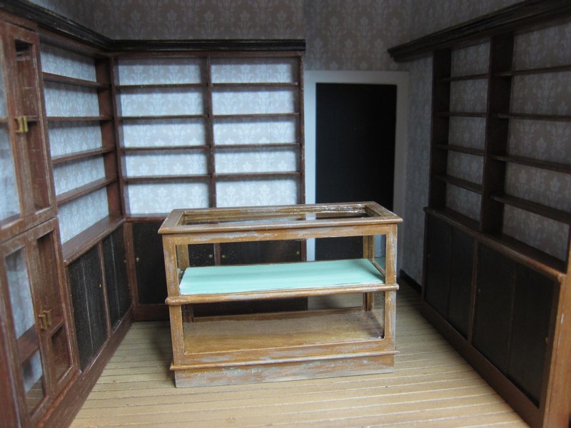

I just finished a wood framed, glass display case for the drug store interior:
The frame was made of styrene. The glass is polycarbonate, and was installed after the frame was painted. I used artist's gloss medium to glue the polycarbonate into the frame. The middle shelf was put in last.
The cabinet was "distressed" to look old and a bit worn. The weathering looks harsher in the photos than in real life. I may try to tone it down later.

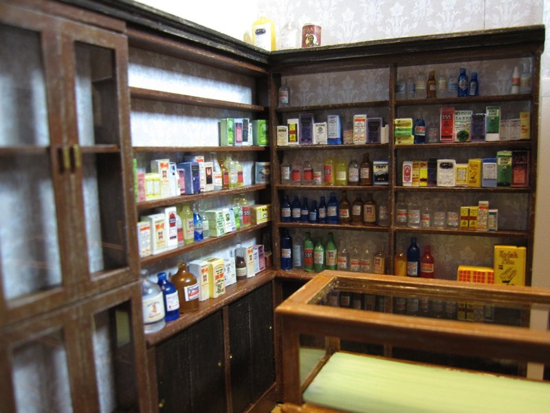

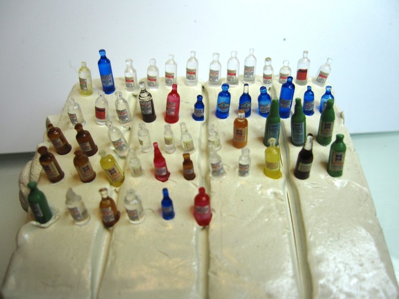

Lately I've been busy making merchandise to stock the shelves of the drug store. I've made about 150 bottles so far. These were turned by hand using a power drill as a crude lathe. I use a Dremel with a cutting disk to shape them as they turn, then smooth them with steel wool and finally polish them with a bit of toothpaste on a rag. Some of the bottles are then painted with transparent colors. Then they're labeled using decals I printed out, from scaled down photos of vintage medicine labels. After decalling, the bottles are sprayed with glossy Krylon clear. Here's a few of the bottles.
I'm also making small boxes for the shelves. These a cut from various sizes of styrene rod. Most are glued together, then painted. Labels are printed out on self-adhesive vinyl.
Here's a test shot of the shelves in place, with some of the bottles and boxes installed. I still have many more to go, plus lots of other little details:
