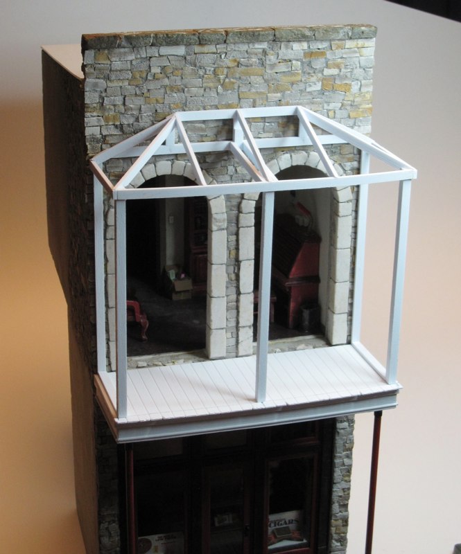

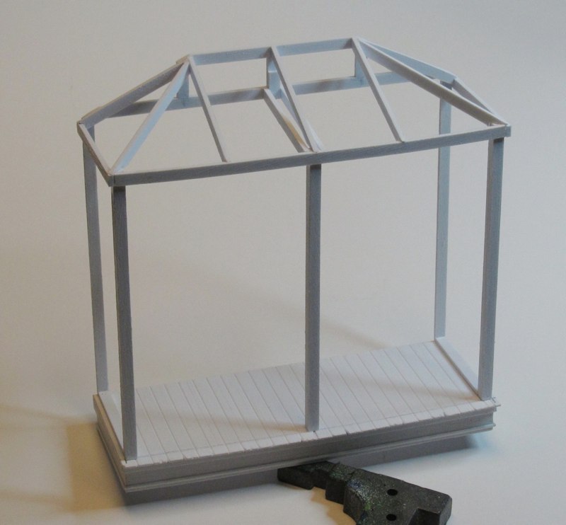

I didn't get much time to work on the model today but still managed to get the frame built for the roof of the drugstore's balcony.
When I first worked out the rough plan for this building in my 3D program, I made the store's false front taller. Then when I started putting together the foam-core form to make that part of the structure, it looked way too tall. So I cut a little over an inch off of it. Now I wish I hadn't done that! I would have preferred more space for the sign that will be painted on the front of the building.
That's some nice work with a lot of angly, anglicized, angular or angst-invoking bits of styrene there.  ;D
I think I even see little notches in some of the bits for structural integrity ... and maybe I'm having an MC Escher moment here, but I can't quite tell if the back is higher than the front ... it looks like it ... but then I keep following these stairs that go nowhere and then back to where they started and ... nevermind.
Enjoying the build ...

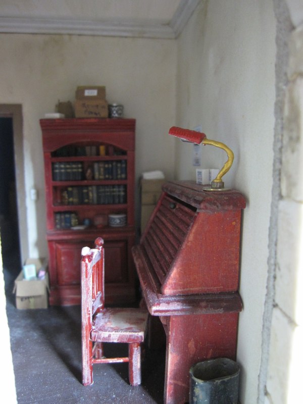

I'm making good progress on this building, and getting close to completion! First off, I decided to replace the original desk lamp with something a little slimmer. Instead of running the bulb leads through a brass tube, I twisted the leads together, coated them with glue, and then painted them gold. The result isn't perfect but it is an improvement:

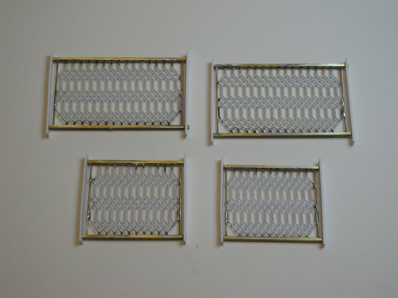

I finished the balcony railings. Thin, vertical brass rods were soldered on at each end. The square horizontal pieces fit into styrene "boards" that will be glued to the balcony posts:

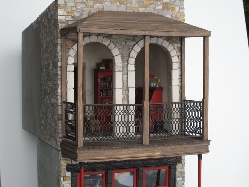

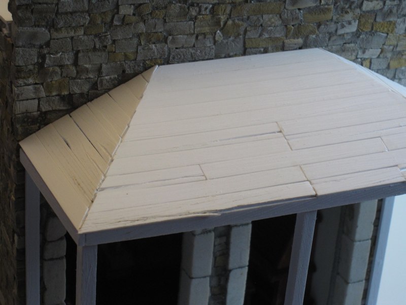

The roof of the balcony was created using individual styrene "planks". Each plank was textured with simulated wood grain. I used an X-acto knife to carve large cracks into some of the boards, and cut away small broken sections:
Finally, the balcony was painted to look like aged, weathered wood. The railings were then painted and glued into place. I had to touch up the paint on the posts afterwards, as the solvent made the paint come off at the slightest touch.

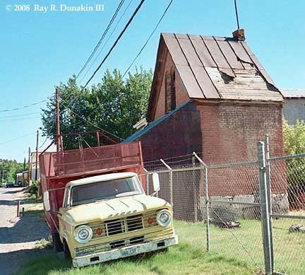

I'm leaning towards a standing-seam metal roof such as this one, with some of the panels torn or missing to reveal the weathered wood:
But I was thinking of maybe doing it in old, green copper instead of rusted tin. Copper roofing was uncommon on Old West buildings, but not completely unheard of, especially for small, prominent features such as this balcony. I would use rusted tin on the main roof of the structure.

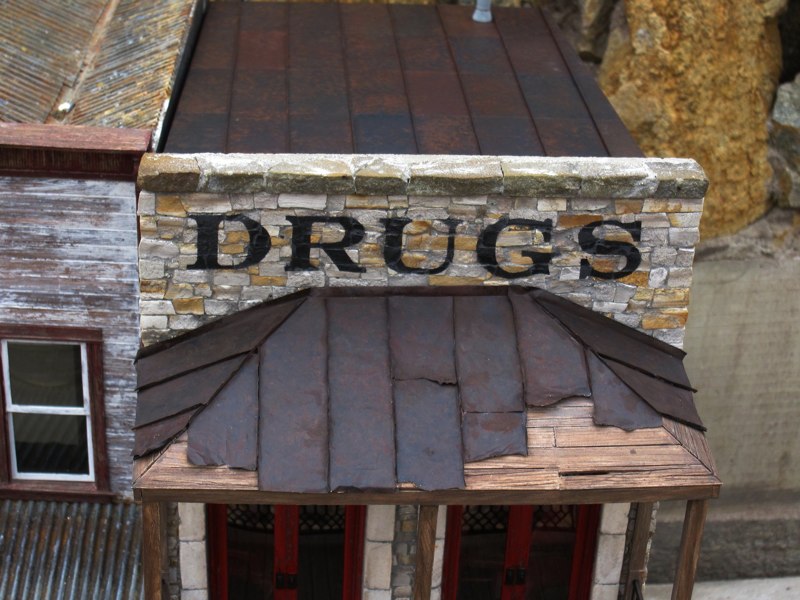

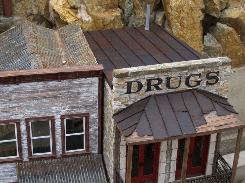

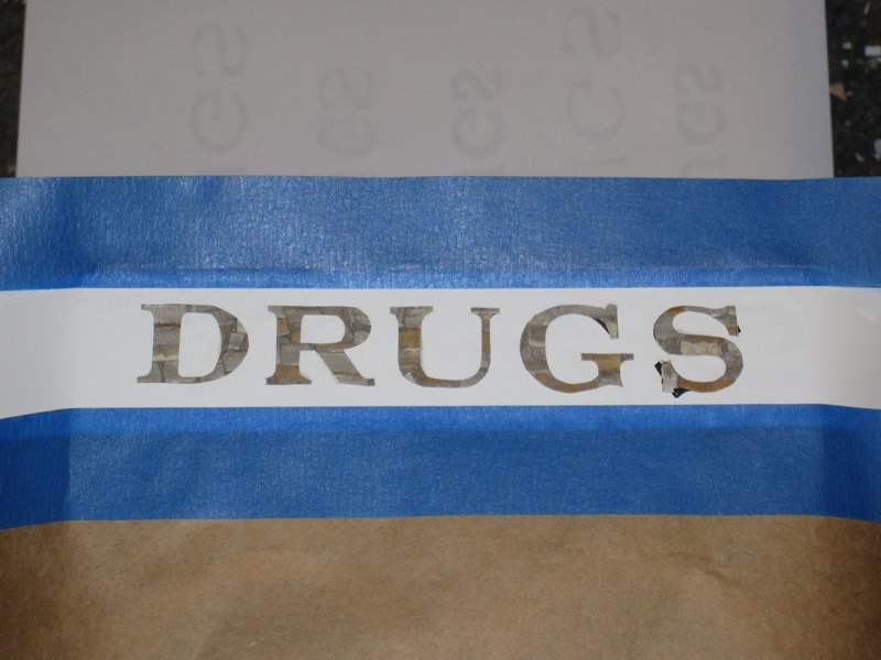

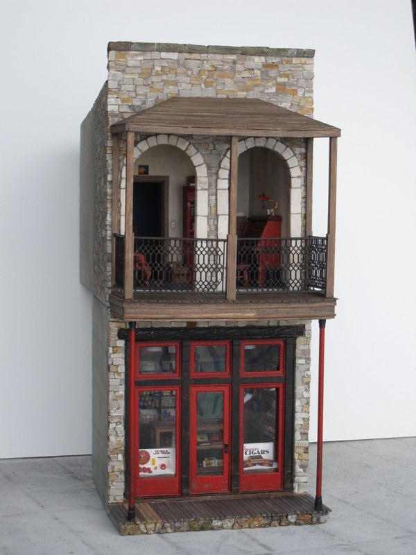

I painted the sign on the front of the store over the weekend. First I made a stencil by printing the word "drugs" on a sheet of printable, self-adhesive vinyl. I cut out the lettering, stuck the stencil to the building, masked off the surrounding area, then sprayed it with flat black paint. Turned out pretty well:
As you can see, I also finished both the main roof, and the balcony roof. On the balcony, I used .001" brass sheet to create individual strips of "standing-seam" metal roofing. I wanted it to look rusty, with sections torn and missing to expose some of the weathered wood.
The metal strips were first spray painted flat black. Then I stippled on several layers of color using Apple Barrel acrylic paints -- mainly Chocolate Brown (more of a red-brown than chocolate), Espresso, Nutmeg Brown, and a mix of Black and Dutch Blue. This was topped with a coat of Krylon UV Matte finish.
(I had considered painting them red, but changed my mind after seeing how it looked. It seemed too garish distracting from the rest of the structure.)
The main roof was .060" styrene sheet, braced underneath with heavier square strips. Then I used .020" x .250" styrene strips on the sides, creating an overlap on the sides of the building. The standing seams were simulated with strips of .020" x .060" styrene. Painting was handled the same at described above.

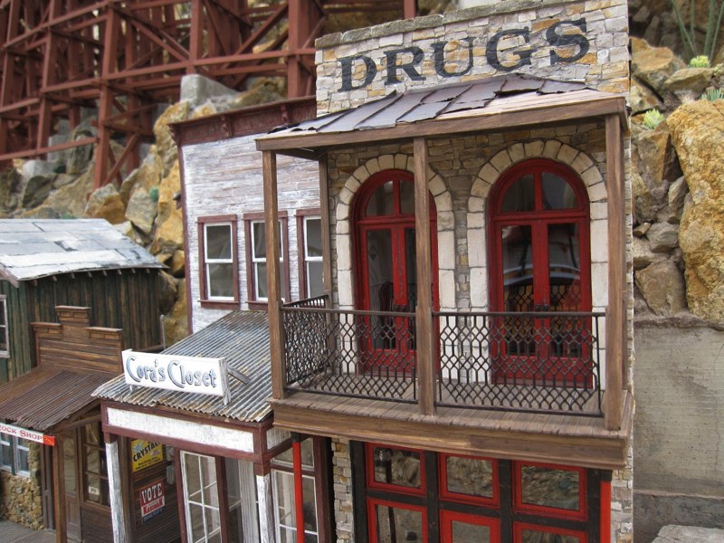

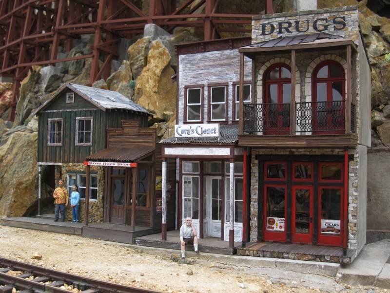

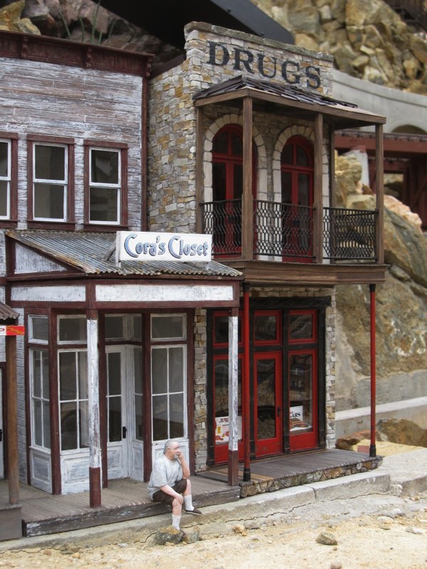

This morning we had some visitors come to see the railroad, so I put the building out on the townsite. Here are some shots of how it looks so far:
I still have to add a few small details, and finish wiring the lights.
Nobody would ever guess you had to "save" that model. It turned out swell. -- Russ
It's a great structure, both inside and outside, Ray.
Ray,
That came out just superb.
The whole "town" scene in that last picture looks great.
Looks like your brother could use a little sun ;) ;D
Keep up the great work.
Rick
I'd photo the balcony roof decision a success ... along with all the rest of the build.   Looks great in place ... fits the scene ... and your outstanding figures really give a lot of life to the place.  Well done!
Damn Cranky
Beautiful work.  The whole thing came together nicely, and it fits the layout perfectly.

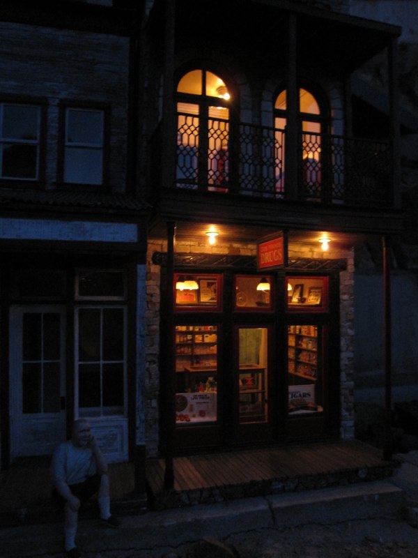

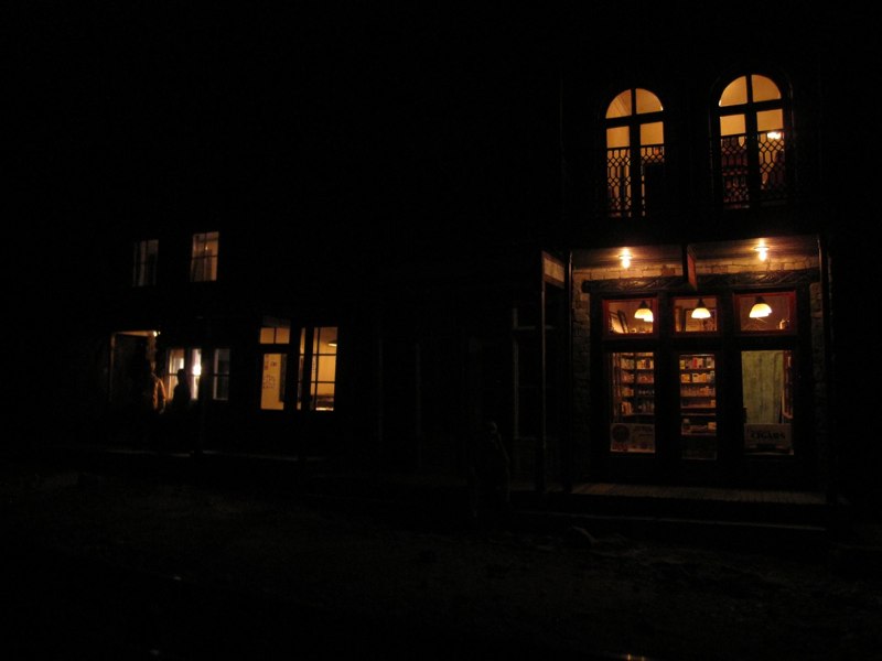

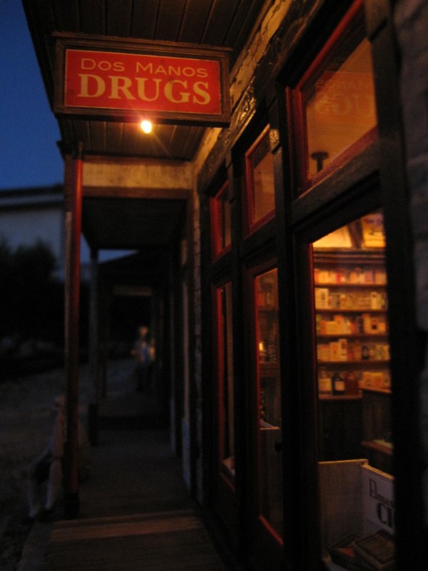

I added the sign over the door of the drugstore, and also installed and wired all the lights. Here are a few test photos I shot this evening:
You can see more pics beginning here:
http://www.raydunakin.com/Site/IRR_Dos_Manos.html#144
