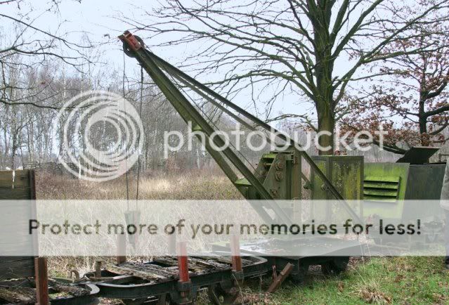

This was the photo that triggered the whole thing
Although the origonal was probably built on 600mm gauge track because I wanted to build it to Gn15 standards my version is built to 1/24 scale running on 16.5mm track representing 15" gauge. I would stress that this my version, not a scale model and the main aim was to try and capture the character of these things.

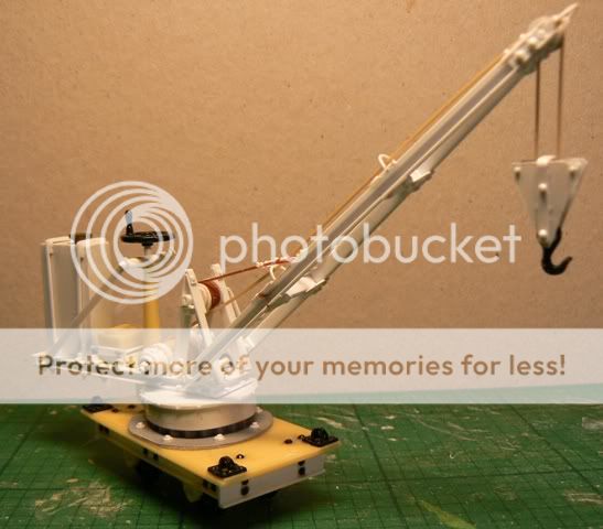

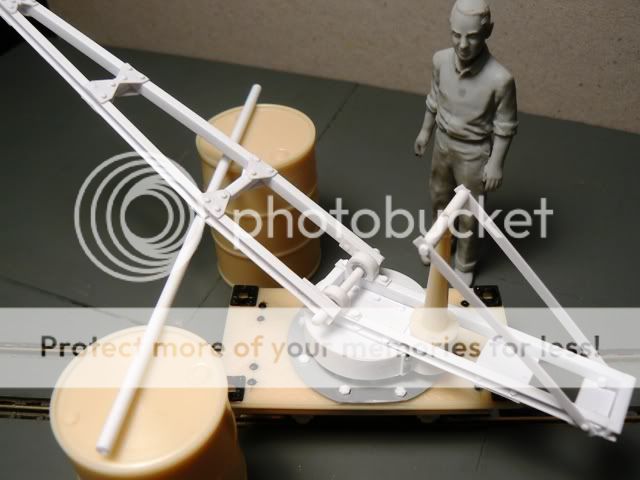

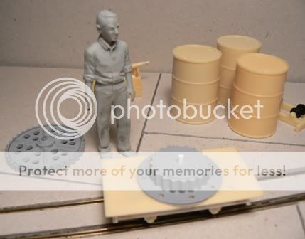

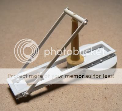

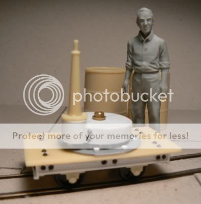

Here are some shots of the initial build

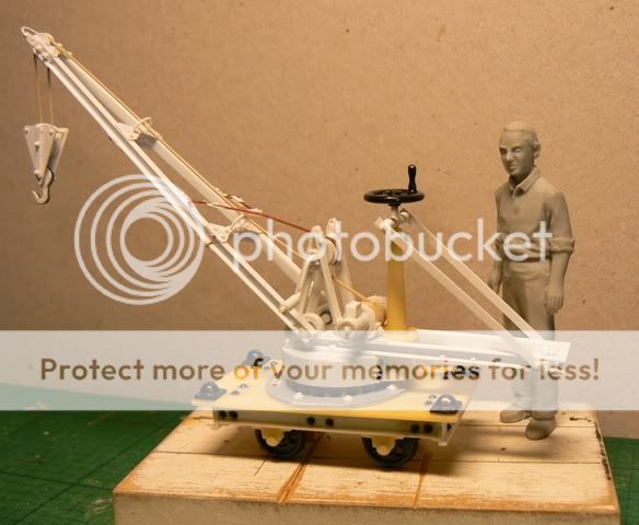

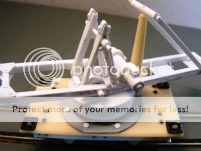

After getting the basics put together, I then started to concentrate on getting some details and character added
All the wire ropes are plastic micro rod and I now wish I had used Marc's suggestion of pre-rolling the rod under a file to add some marking to represent the twisted wire ... as I will now have to try and represent this in the painting stage.

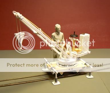

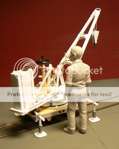

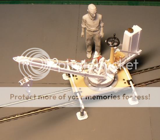

These are shots of where the project is currently , I have been putting the paint job off because I really can't decide what colour and also what stage of decay to show
As the challenge ends in a few weeks I am going to have to sort the paint job soon, will post updates when I have got something to show.

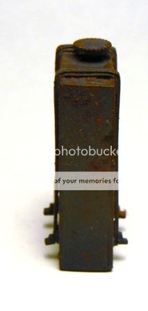

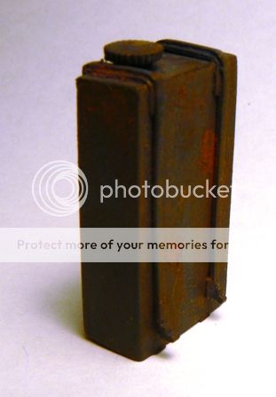

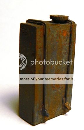

While most of the crane will only be lightly weathered, I did want to add some variation so planing to weather ballast tank a bit more heavily.
So here are some photos of experiments I have been trying.
This has been done following the standard (Cranky) technique for first couple of stages all of which are pretty well documented .... base colour, variations of reds,browns,blacks then sponged on .
I then went off on a tangent as I wanted to try and get some rust bubbling through paint ....
So next stage was to use some "rust" pigment powder (instead of salt), placing some small but thick piles where I want rust , then fixing that in place.
Then this was given a couple of coats of hairspray and when dry a few mists coats of base colour then some areas lightened slightly with further sprayed coats.
Then when dry, dampened with water and some areas rubbed with stiff brush, if you try this you will find pigment obviously colours whole surface but you can mop up/control the stain effect with dry tissue ,etc. and this is where I have ended up. Bubbling rust thro' paint ..... well nearly ?
MG]
I am hoping that this variation of the salt technique could be of interest to painters with more skill than me who can refine the process to try and take the experiment a bit further.
(yes I can see, now, where I missed a seam ... more clean up work !!)
JohnP

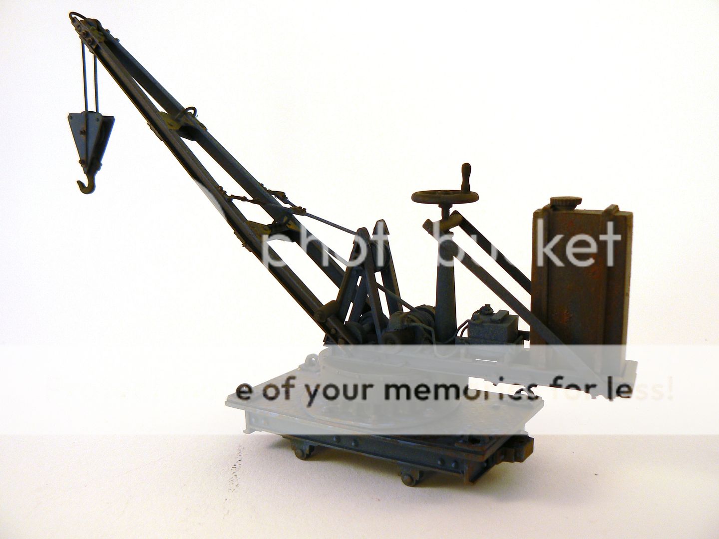

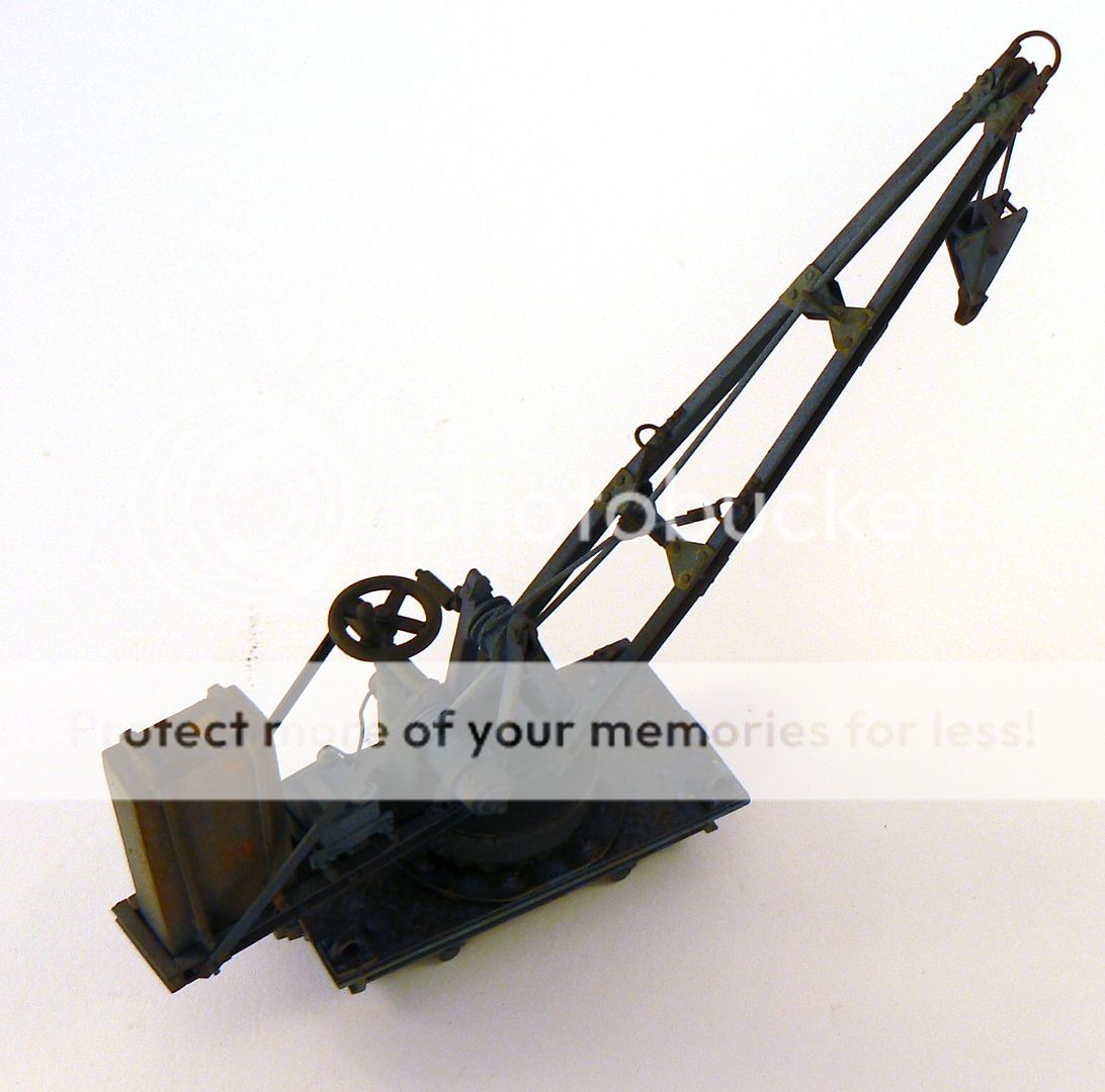

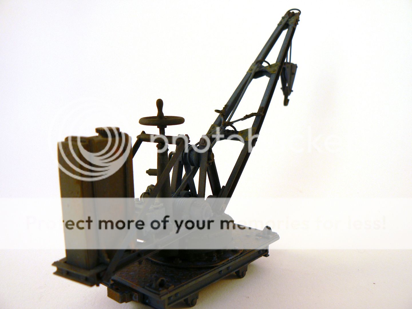

Couple of shots about 30% of the way in to the painting, have done some chipping via H/spray technique, as well as some filters and ... what I think is called mapping, filling in some of chipped areas with different colours, this has not gone as well as I would like as I got the contrast too strong, will try to sort
Next stages, I think, are to sort out some of the filter/chipping issues then seal for some pin washes and the detail painting of various parts.
Alternative thoughts and advice would be very welcome
