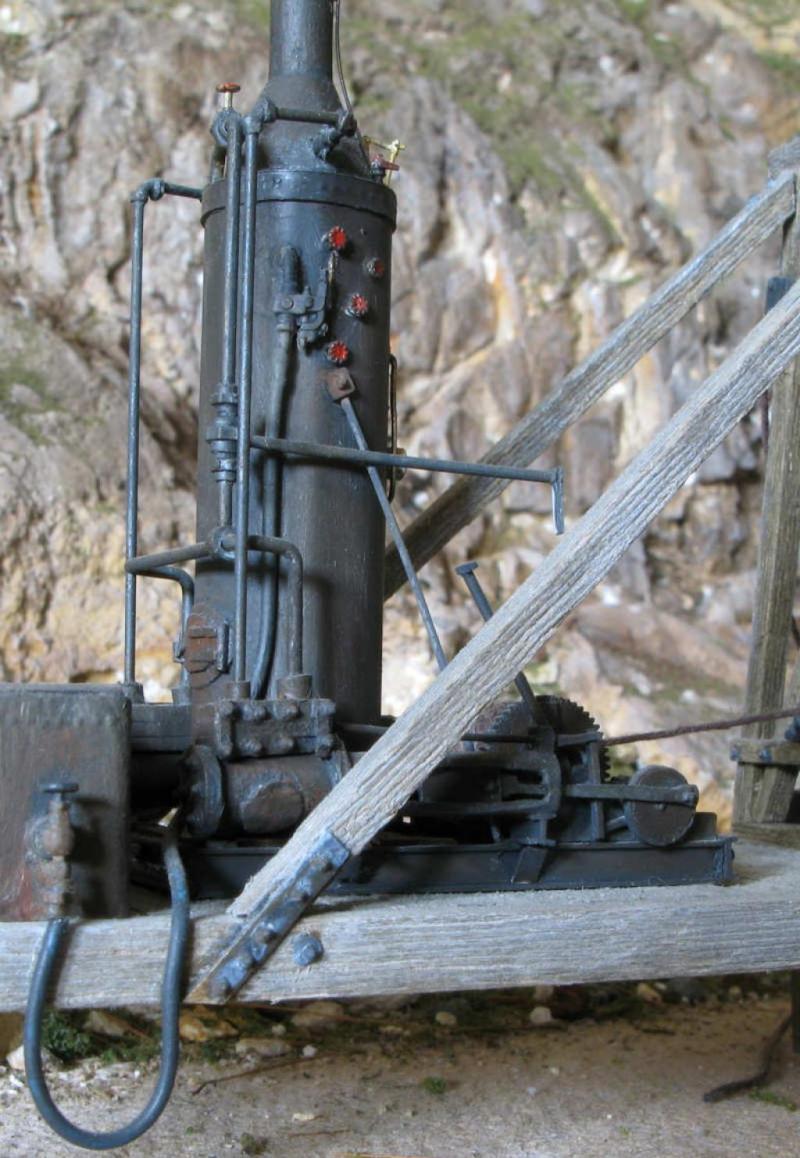

Here is a shot of a S scale model I had done ten years ago.
The model I'm currently building is an O scale one.
