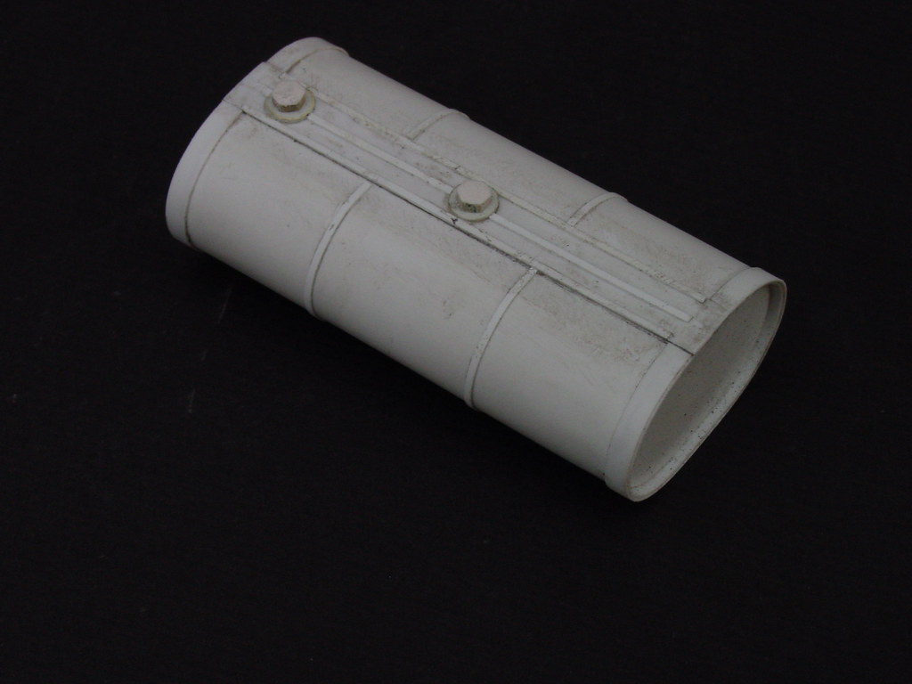

This is the first part of the Fordson power plant. The gas tank is all styrene and there are around 20 part. I will do a SBS tomorrow.

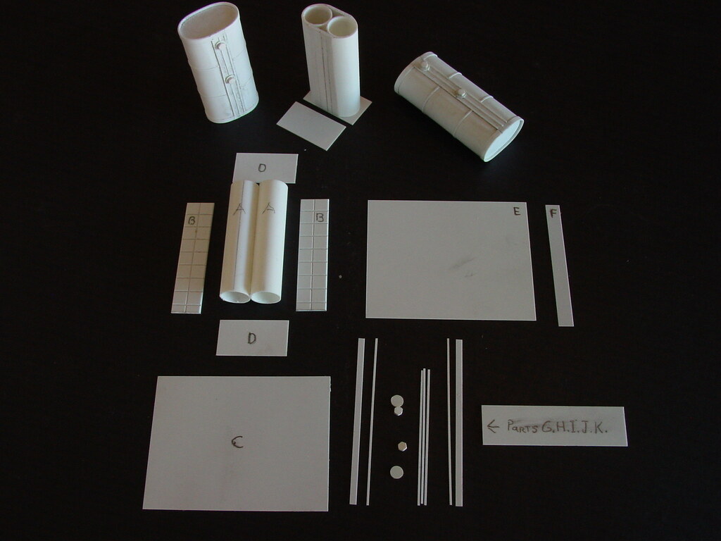

 Fordson gas tank has 20 parts .The core is made up from parts A,B,C and D. Glue the two A parts together. Center and glue the two B. parts one on top and one on the bottom of the two A. parts. Glue part C. around parts A. and B with a flush joint. I Sanded both ends on my disk sander for a good surface to glue the two end parts D. Trim and shape the D parts after the part has been added to the assembly.
Gas Tank part1
A. (2) styrene tube 1/2" x 2 1/8" long.
B. (2) styrene 040" x 1/2" x 2 1/8" long.
C. (1) styrene 010" x 2 1/8" x 2 5/8"
D. (2) styrene 020" x 5/8" x 1"
The outer parts are made up from parts E,F,G,H,I,J and K. Add part E. centered on the core with the joint opposite of part C. Add part F. over the joint on part E. Add the four bands around the tank parts G. and H.and the three bands part I. on top part of part F. Parts J. and K. makes up the two filler caps.
E. (1) styrene 015" x 2 1/4" 2 13/16"
F. (1) styrene 010" x 1/4" 2 1/4"
G. (2) styrene 010" x 030" x 2 5/8" (out-side bands)
H. (2) styrene 010" x 030" x 2 5/8" (in-side band)
I. ((3) styrene 010" x 030" x 2 1/16" (top bands) (these three bands are on top of part F. cut center band around the filler caps.)
J. (2) styrene 3/16" hole punch 020 thick (filler cap bottom)
K. (2) styrene 1/8" hex stock 060 thick. (filler cap top)

Thanks guys . (I changed part K on the gas tank to a 2-56 brass hex bolt head)

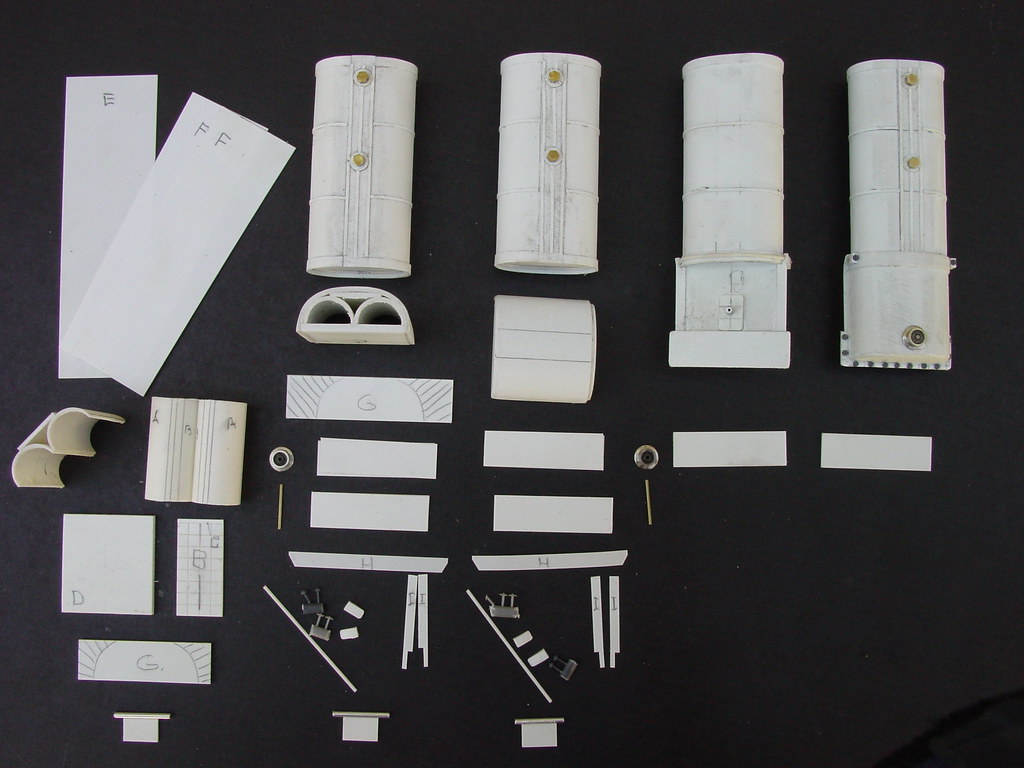

Top of the Radiator part 2
Here's the S.B.S. for the top of the radiator. The core is made from parts A,B,C,D,E,F and G. Glue the two A. parts together. Center and glue on part B-C. Lay this assembly on a flat surface with the A. part down and mark a center line around the four sides using a 1/4" thick scrap piece of wood for the guide.  I used my 10" disk sander to sand off the bottom section leaving the line on. Use the sander to true up the two ends leaving it 1 1/32" long. Add part D and true it up using the sander. I cut the E and F parts longer than needed and trim them to correct size after they were added to the assembly. After Part E has been added the core should fit onto the end of the gas tank. With the two parts together draw a line at the joint and add the two F. parts. This will leave the top of the gas tank and the top of the radiator at the same level. Glue on part G and after the glue has dried shape and round over the top edge.

For the detail add part H. over the the joint on top between the gas tank and radiator top. The two I. parts are added one on each side of part D. Mark a line 5/16" back from the front on the bottom for the back of the radiator flange. Cut part I. off at this line and place the water pipe connection part on this line at the center.
H (1) styrene 010" X 156" x 1 11/16"
I (2) styrene 020" x 100" 13/16"
I used a N scale wheel for the filler hole (the cap will be added later)
I used 030" styrene rod for gas tank support rod with a small piece of styrene 040" x 060  x 3/16" cut into a wedge shape and glue on at the ends of part H. with a Grandt line Nut Bolt casting # 128 for the ends of the support rod.
I used a piece of styrene 040" x 1/4" x 3/8"  drill a 1/16" hole at the center for a 1/16" x 1/2" long pin for the the water pipe connection.
