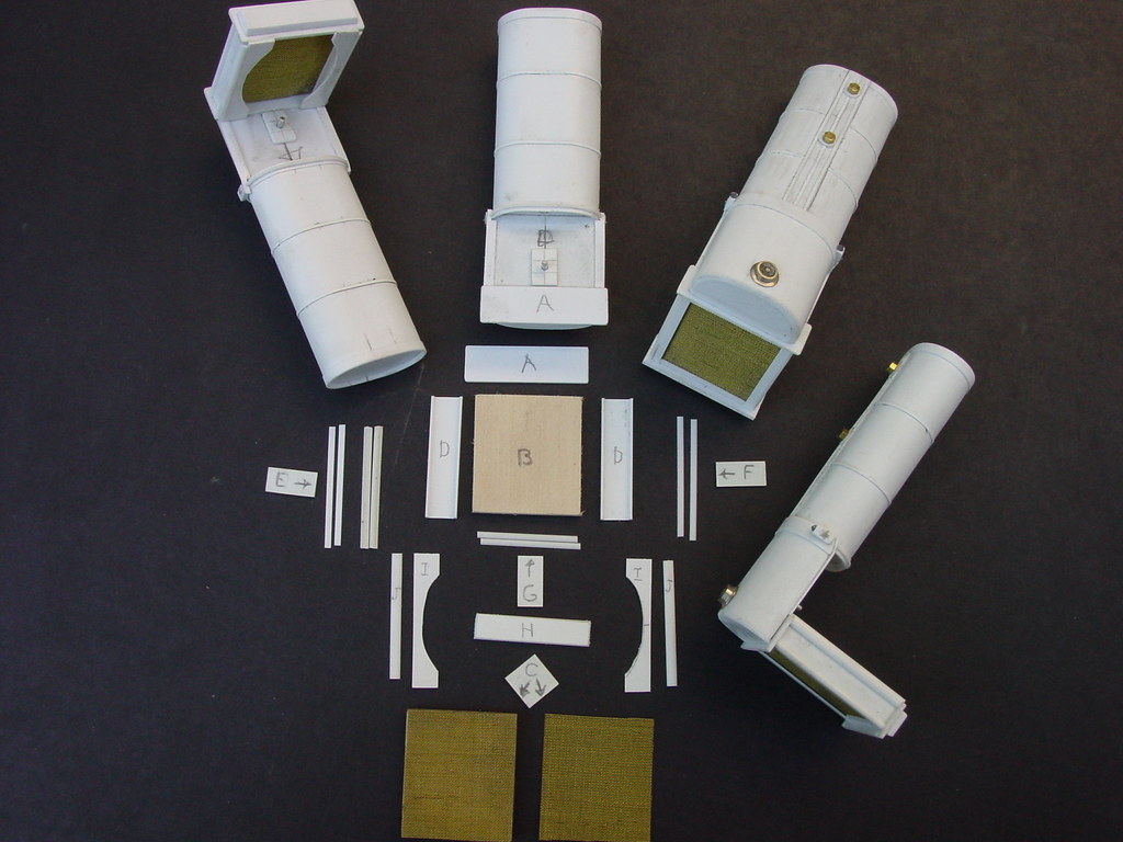

Thanks guys for your enthusiasm.The Radiator, Glue-together two A parts for the top flange and two for the bottom flange.(I'm looking for the right size nut-bolt casting for the nut-bolt on this part). Add the mesh Part C one on each side of part B and sand to the correct size. Glue the two E parts together and add to the in-side of Part  D. Add one D part to each side of the B-C part and add the top and bottom flanges.  Add parts F,G,Hand I. (note the thickness of the wood core part B would be better if the thickness was a little thicker  5/32" or 3/16". The size of the spacer part E would need to  be adjusted also)
Radiator part 3
A (4) styrene 020" x 3/8" x 1 1/4" long (looking for the right size of nut-bolt casting)
B (1) wood 125" x 1 1/16" x 1 3/16" ( look at note)
C (2) brass mesh 1 1/16" x 1 3/16"
D (2) 5/16" styrene channel 1 3/16" long
E (2) styrene 020" x 060 x 1 3/16" + 060" styrene angle 1 3/16" long
F (2) 060" styrene half-round 1 3/16" long
G (2) 060" styrene half-round (around) 1" long (cut to fit)
H (1) styrene 080" x 1/4" x 1 1/8" long (add to the bottom of the bottom flange after taper or round over the sides)
I (2) styrene 030" x 1/4" x 1 5/32" long (shape using a 1 1/2" diameter circle)
J (2) 100" styrene half round 1 3/16" long
K (48) nut heads and nut-bolt heads (? for now)

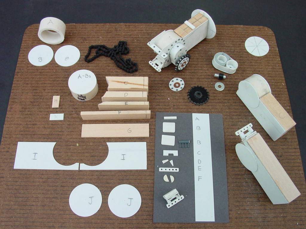

Glue parts B on the ends of part A. On draft paper draw a simple plane for the side view. draw a rectangle 1" x 2 5/8". Locate  the center location for the 1 1/16" diameter circle up in the upper left hand corner of the rectangle up 11/16" from the bottom and 7/16" over from the left side and draw the circle. Set the A.-B. part on the drawing and cut the wood part C,D,E,F into the circle. The bottom of the circle will set on top of part G. Using the above lay-out cut the circle in part I. and add part K. and H. I cut all the wood parts longer than needed and trimmed them all after the assemble was all together.to finish this up add parts J. over the top of part B. ( note that more parts will be added to the top, bottom and the two sides.
A (1) ABS pipe around 1 1/16" OD 1/2" long.
B (2) styrene disk 1 1/16" OD 020" thick.
C (1) wood 1/2" x 1/2" x 1 1/2" long
D (1) wood 1/4" x 1/2" x 1 1/2" long
E (1) wood 1/8" x 1/2" x 1 1/2" long
F (1) wood 1/8" x 1/2" x 1 1/2" long
G (1) wood 1/16" x 1/2" x 2 3/8" long
H (1) wood 1/16" x 1/2" x 1/4" long
I (2) styrene 020" x 1" x 2 5/16"
J (2) styrene disk 1 1/8" OD x 020" thick (add (7) nut-bolt casting Grandt line # 128)
K (1) styrene 020" x 1/4" x 1/2" long

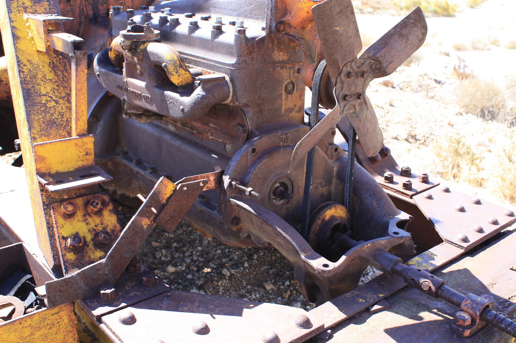

Here's a good photo of the bottom of the radiator. This is a great help for one of the harder parts to model on this tractor.

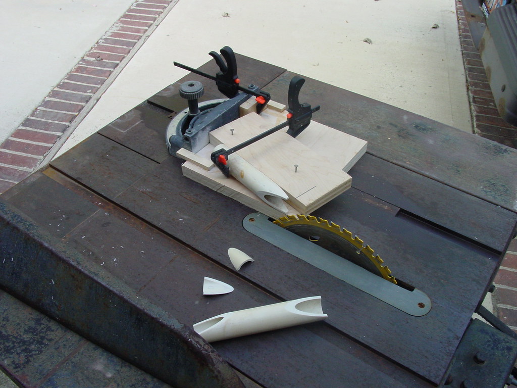

To finish up part 4, the Transmission core, I needed to add sides on the main casting. If I was only building one tractor I probably would have tried a truer profile, instead I went with something a little easier.
Here's a photo of the fixture that I used to cut the pipe into a wedge shape. For a better fixture I would have made the base 1/4" thick instead of the thicker one, and a piece to hold down the pipe from coming up when cutting. I will finish up this part when I can get back in to my shop.

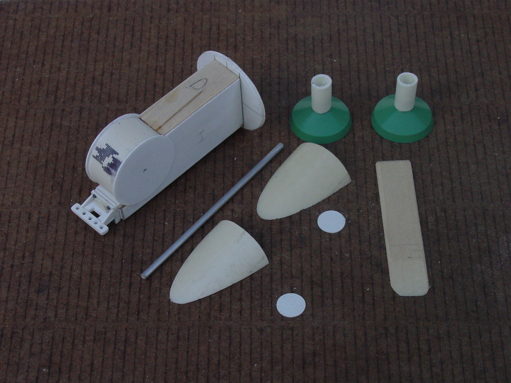

Transmission core parts. part 4a
To finish up the transmission core I started with the two side  Cut on table saw with the fixture and I squared up the ends on the disk sander.
A (2) plastic pipe around 1 1/16" OD (cut to fit )
B (1) aluminum rod 3/32" x 2 3/4"- 3 1/2" long
C (2) Plastruct lamp shade  # LF-10
D (2) styrene tube 1/4" x 3/8" long
E (1) wood 1/16" x 1/2" x 2 5/16" long
F (2) styrene disk 010" x 5/16" diameter These parts are for the two control lever
G () Grandt Line  nut-bolts # 128
