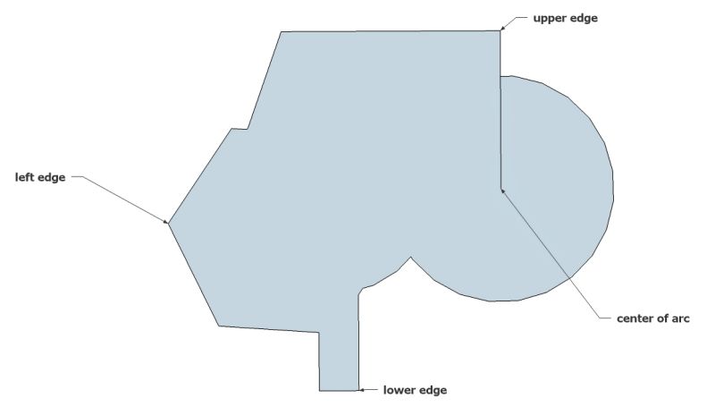

I don't know of  a way to increase the number of sides on a circle after the fact (not saying there isn't .. just don't know of one) but depending on circumstances you can cheat a bit.
Below .. the circle on the left is 24 sided. In the center I placed a mark at the outer edge and centerline. On the right I deleted the circle to the left of the cetner line and drew an ARC from top to bottom of circle and ending on the outer edge mark. It draws a 24 sided arc. Like a circle just type ins 98S and enter. This creates the circle on the right.
Aligning circles or anything else ..
Suppose we start with an object. I just placed marks for the left, upper and lower edges and center of arc
#261
Now suppose we want two holes. First thing is to group the object so drawing reference lines won't affect your model.
First one.
Centered on the tip of the 'left edge' and 4 inches in from that point. I simply hit "T' to select the Tape Measure Tool .. clicked once on that line that extends from the upper edge to anchor the Tape Measure Tool and move the cursor down until  a green DOT appears dead on the "left edge". Click and a dotted guide line is drawn there parallel to that anchor side.
I had drawn a vertical line from the left edge earlier. I will now click that with the Tape Measure Tool and drag ot the right .. any distance .. let go and thype "4" and hit enter. This will now draw a vetical line from that left edge exactly 4 inches in (oh .. forgot .. had set to decimal inches earlier)
You draw your first circle using that crossed guide lines
Now .. we want another hole that if offset from the vertical cetner line of the arc say .. .75 inches to the left .. but centered on the horizontal center line.
Again, using the Tape Measure Tool click that vertical cetner line and move your mouse to the left, let go, type in .75 and hit enter. You will now hav a vertical guide line .75 inches to the left of the vertical center line.
use the Tape Measure Tool and Double Click the horizontal center line. A horizontal guide line with be drawn on top of it and extending across the page. where the guide lines cross you use that as the center for your second circle.
Everything is precise and exact.
In the SU "Extension Warehouse", there is a plug-in/extension you can download that finds/marks circle and arc centers; "CLF Arc Centerpoint Finder" ..its one of the Chris Fullmer tools
You may also want to download the one called "1001 Bit Tools"....some helpful ones there for drawing shapes, arrays, slices, dividing and placing construction points, planes from non planar points, etc..
