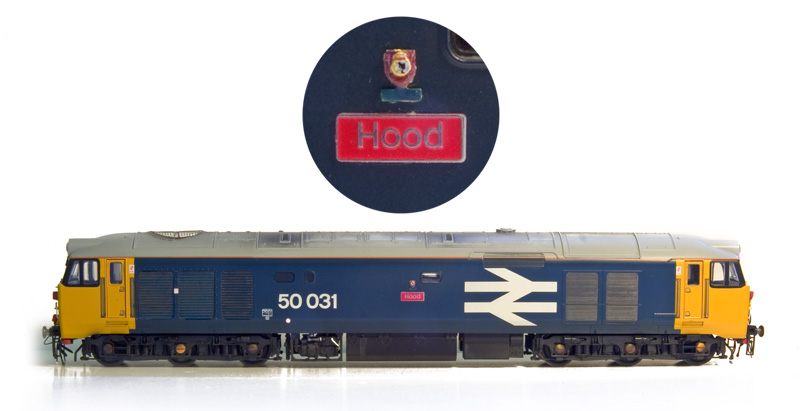

Hi all
The above example is Hood's crest, from Extreme Etches! which is a 3 part etch for something only 3.5mm high!  (I think i need to buy a magnifying glass if im honest)
The loco itself is a Hornby one which has been lowered on its bogies, had the wheels, side grills, roof grill and windscreens replaced.  It's what would be termed as 'immaculate condition' as the model is my own little tribute to the loss off all but 3 lives when the Royal Navy's flagship HMS Hood was sunk by the Bismark during World War II.
All of the class 50s were named after Royal Navy ships or land bases.
To read more about HMS Hood see http://www.hmshood.com/
Jim
Jim Smith-Wright
The crest and entire locomotive appear quite satisfactory. -- Russ
